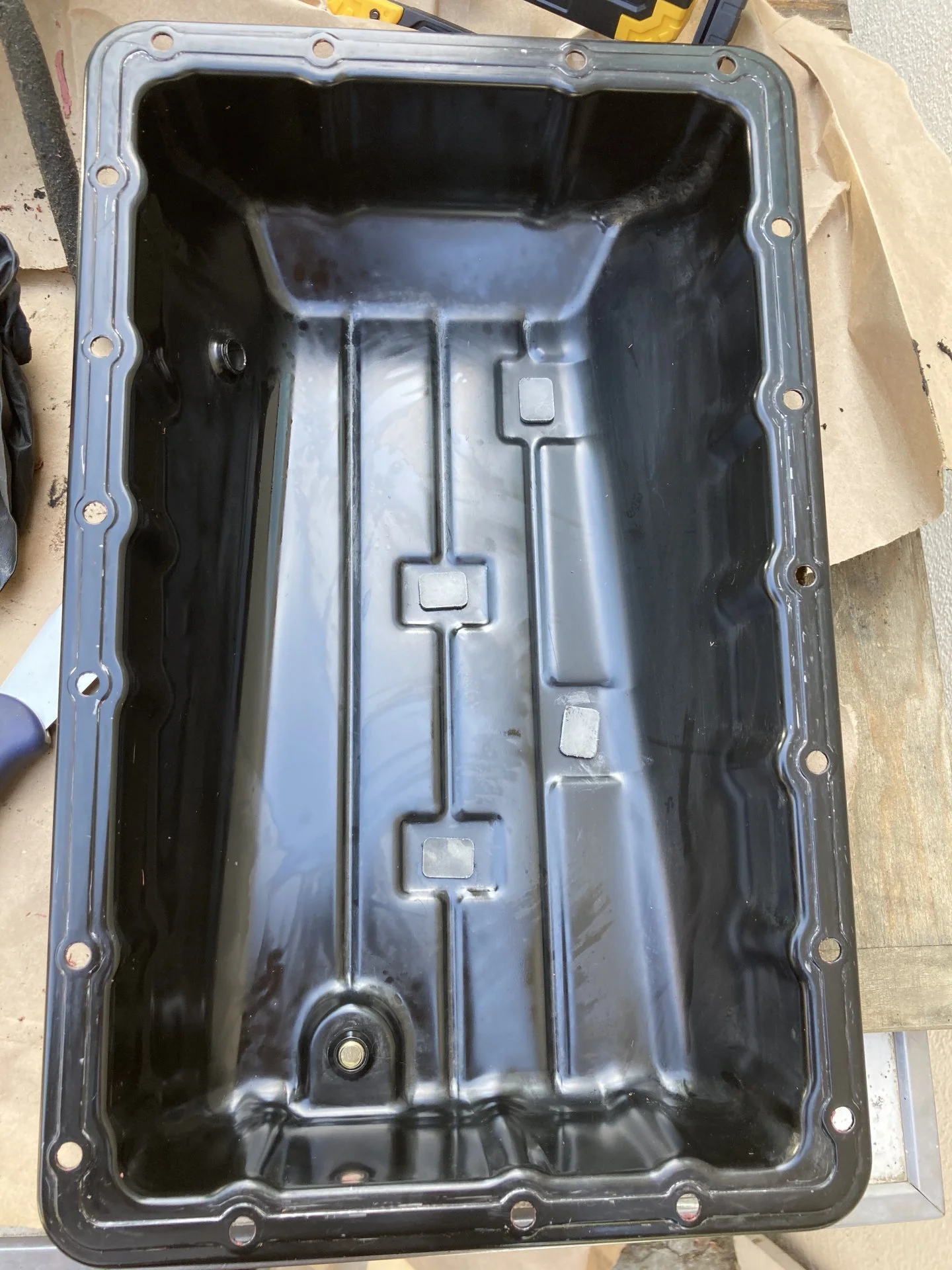

hello.
new to 80 series. Just picked up a 97 Collectors Edition 220,000 mi.
it was running good for about 400 miles before I decided to clean the interior. I pulled the carpet and center console out. Unplugged and reconnected everything back. It ran for maybe 100 miles then it threw a code P0753. Truck didn’t seem to have 1st gear - no power but then picks up.
I probed for resistance but didn’t find a short from both the ECM and trans connector.
I manually shifted L-2-D and shifted fine.
Trans fluid not dirty and level’s good.
Cleared code but came back.
Tested the 2ND start and it started okay.
my question before I drop the pan and replace solenoids is, would there be anything in the center console that could cause this?
thanks in advance.

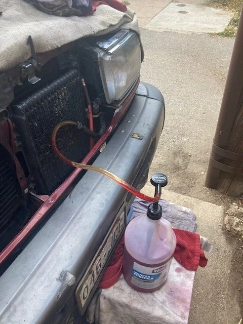

Yes did a power fluid flush.
I purchased 1 solenoid Expensive Need 3 solenoid
Did not install new solenoid.
Many different views or perspectives on the A343F Transmission solenoid issue and techniques for changing fluid.
The transmission fluid does not really drain out like motor oil. Most of the Tranny fluid stays in the system when drained.
This is where the power flush comes in. Dealer has a machine that pumps fluid through system.
I8hmud members have come up many clever systems.
After reviewing many forums we used this technique.
Remove front grill to access oil cooler. Have 5/8"? clear hose, couple of drain bottles, pliers, Phillip's, long skinny funnel for dipstick etc
Run clear tube up to top This is your drain line for the end of the system and old fluid removal.
I used a hand pump attached to the OEM tranny line back to transmission for new fluid. This sorta worked but found a gravity feed also worked my second time.
Install drop clothes to trany dipstick to protect wires etc.
Install funnel, long and skinny like me.. I used two funnels to help with angle and allow air into filling.
TRANSMISSION NEEDS TO HAVE FLUID AT ALL TIMES
Patience is key to most 80 repairs including pouring Tranny fluid SLOWWWWW
I added about a gallon or less to overfill tranny.
Luckily my daughter and wife can help.
Daughter in driver seat, wife with the pump and me with the dipstick funnel.
Start truck with EBRAKE and FOOT on brake.
Run Through the tranny gears as the old fluid comes out and as you pour /pump more new fluid.
May need to stop engine to add more tranny fluid as it pumps faster than you can add. Judge amount pumped out with the amount poured back in.
We ran about 12 quarts through our tranny. Until red and clean.
Reinstall and check fluid on level surface after running for 20 -30 minutes through all the gears.
Our cruiser is at 300k and needed a good BASELINE for all fluids.
Time goes by fast and even being a owner ,since 2003 for ours, some things just slip by. IE TRANNY fluid change.
Baselining the 80 was the best thing for the way it runs, besides redoing the head gasket, and all hoses.
Take care and enjoy

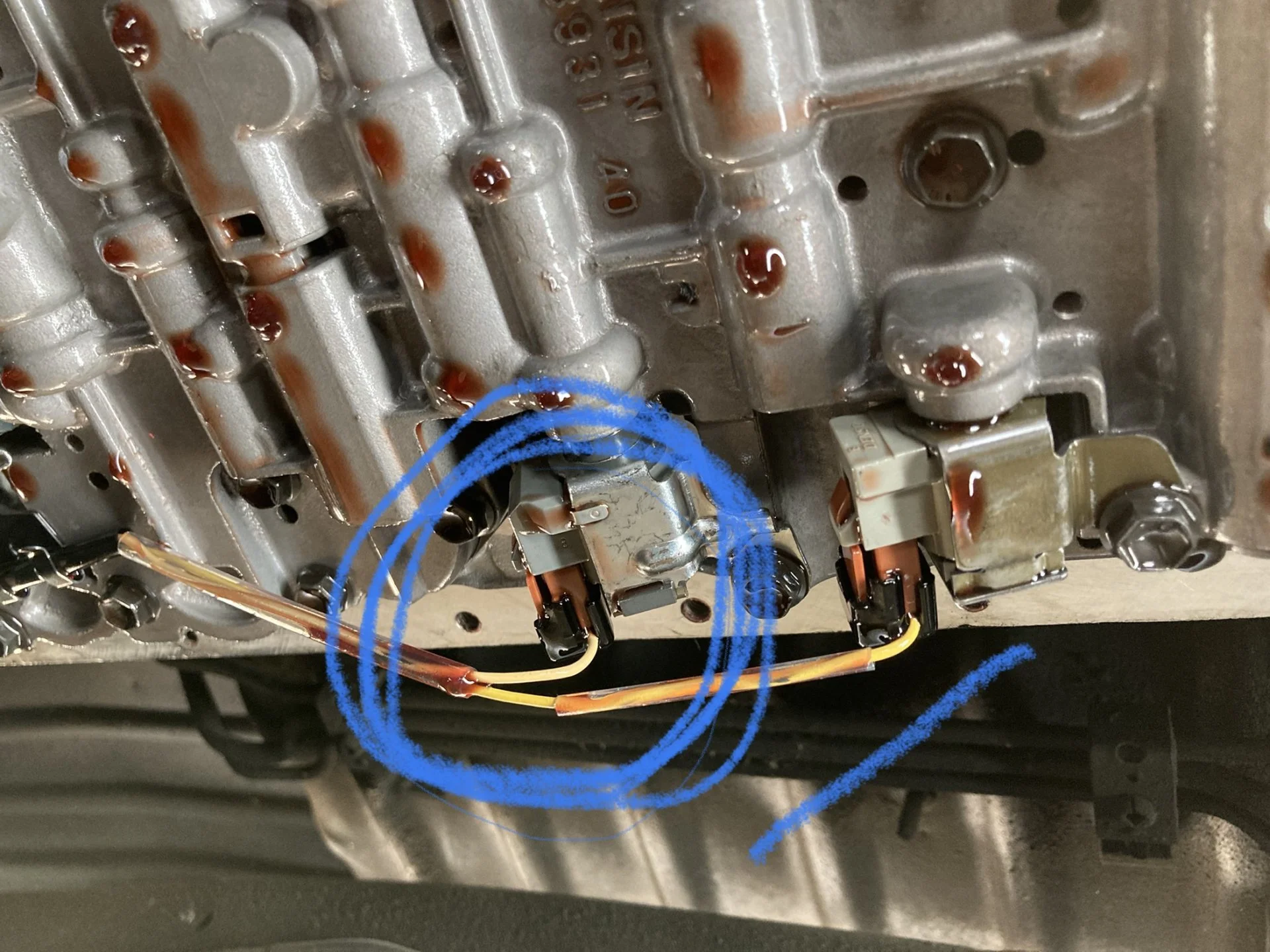

Hey, I had this issue and spent >$1K chasing it.
My issue was that the solenoid wiring between Trans and ECU had rubbed on the body and frayed. That wiring is on top of the transmission so hard to see from under the vehicle — removing the front passenger fender provides for "better" access.
When tested, The wire showed continuity but the resistance was so high that the ECU kept the truck in Limp mode
Thanks for the heads up!

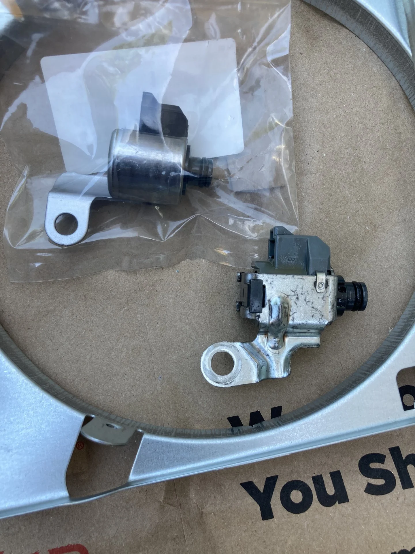

i’m about to start the work today for the solenoids - they’re not cheap.
i’ll double check the wiring. I hope that if it’s damaged that it will be obvious.
if i don’t see damage and probed okay. I’ll go for the solenoids. Or power flush then solenoids.

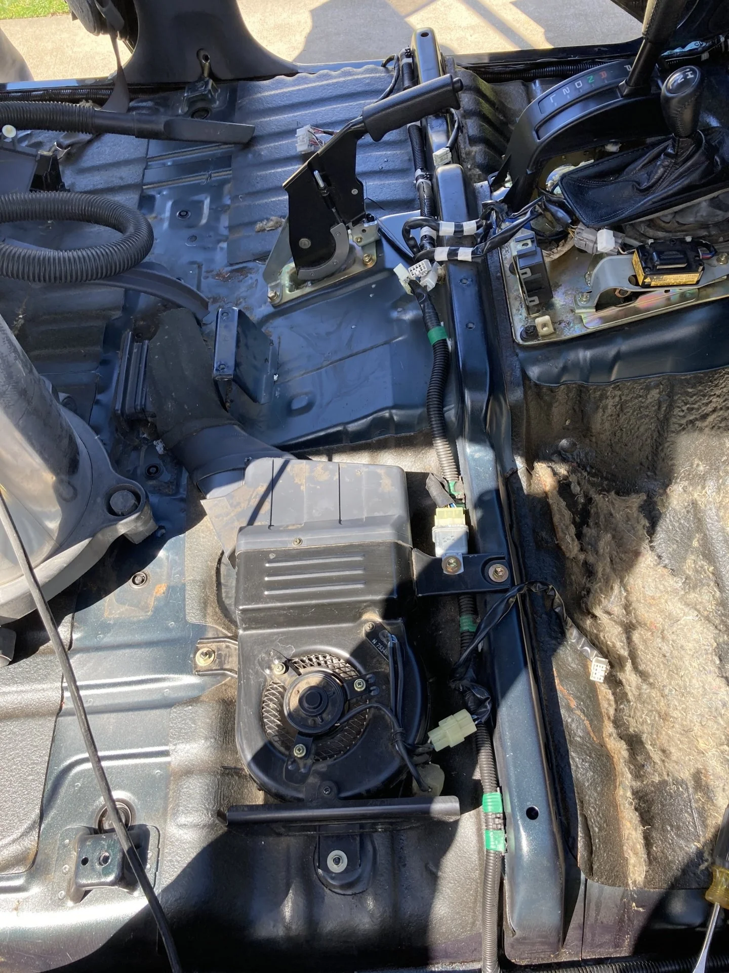

Okay. So I poked around yesterday. Removed the center console cover, verified the PWR/2ND switch wiring, everything looked good. I probed the connector to the ECM again for S1 and S2, I got a reading of 14.8 ohms for S2 and nothing for S1.
Manual says ECM if either S1 or S2 read within specs.
if i can get some help confirming this, that would be amazing.
thanks.

Regarding your transmission electrically on exterior for us it was the connection from wireharness glove box to engine then tranny.
Located at L Drivers side rear well. I think 3 maybe only 2 plugged connections. Viewable from top sorta way back under fire wall. Easier to view and access with wheel removed and rubber inner wheel flair removed.
Reread the entire post from beginning.
Your first questions is where I would go back too.
Can it be something when I had interior apart. From the picture there are plugs disconnected. It maybe something as simple as the plug connection not being connected.
Toyota Plugs snap into place. No snap not right. On older 80.s the plugs are full of grit grim
Found that the cleaning and care of these plastic connections is about the most important detail on a Cruiser. No connection no go.
This is from the experience of not making connection properly myself. This lead to knowing more about the plastic clips than needed.

Update our 97 A343F gave us the Code 750 Solenoid A
This has been going off and on for a while.
Lesson learned. Tranny needed to be flushed and does make a difference.
Did it solve solenoid problem. Does not appear that it has.
Purchasing the OEM solenoids, slowly, for replacement.

So before I pulled the old shift solenoids, I probed them first.
S1 was warm. S2 and SL were normal (cold). I wonder if that meant that S1 has faulted internally????
i know I hope so..
Why thanks for the pictures? What's your plan with Solenoids?
I have one solenoid and it is Solenoid A for us. Replace with one new Solenoid. Test, clean, and reinstall other 2 solenoids.
Kind of my plan instead of buying 2 more for around 450$
Have seen various sites, show how to test a solenoid. Probably even a older forum or resource on IH8MUD , as this is not a new challenge.
My mechanic says they do wear out. Think of it like a fuel injector, spraying or opening/closing millions of times.
S1 is used the most as it get us going.
I’m replacing both when I get home. I’ve read that placing them in an ultrasonic cleaner might get them going again and blowing air to test if it actuates. Makes sense in theory but I don’t want to go the distance of starting over if they still fail after all that trouble - cleaning the gasket is not that enjoyable.
the OE solenoids that I got from Toyota are Denso vs AISIN (original) And somewhat different in build. Mounting bracket seem to match though.
i heard that Isuzus use the exact same solenoids and run about $200 for the set.
Great work. Are you going to replace all 3 solenoids. I too have heard that about Isuzu but have not been able to track part down for A343F.
Thanks for pointing out the gasket challenge. Main thing from me not putting up on stands for a day or so. Looks nice and clean now!
I replaced just the two shift solenoids. Cleared the code. Test drove it tonight and MIL didn’t and hasn’t come back. Shifting smooth again. Other than cleaning gasket, the job wasn’t too bad.
thanks for the pointers!
