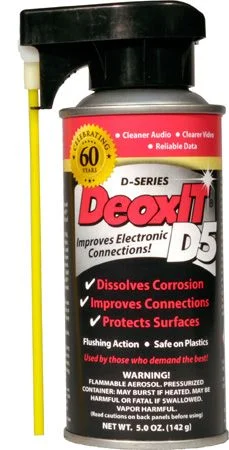

Ok you need to unplug your transmission and drive it and manually shift it, through the gears, and if it shifts it maybe the solenoids ( I have dealt with many 343 and 442's the 442 has more solenoid issues ) ,now before plugging it back in spray your plugs with Deoxit both male and female . Now check the kick down cable and make sure it is good order and adjusted properly. After all of this it should solve the problem OH yeah check the TPS throttle position sensor for it's adjustment, Oh yeah what solenoids did you buy ??

I unplugged the connector to the solenoids at the transmission housing and manually shifted it through gears without any issues. After that, I did spray both male and female connectors with contact cleaner.

Ok like I said before Dexoit the plugs, and then it sounds like your neutral switch maybe bad, I have 290K on my 343 and the last 60K has been with a 6 BT Cummins, and I drive it every day. So go back and use Deoxit and clean them well, also check the neutral switch again, you are having a simple electrical problem, don't throw parts at it, narrow it down

I’m going to get the vehicle on Monday and will go through electrical connections again with contact cleaner. To your point, I did use contact cleaner on the terminals to the solenoids. But i’ll Print off a copy of the EWD and detach + spray all the connections involved in the trans.
