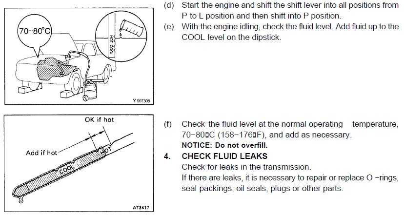

After you've cleaned up, stick the dipstick back in the fill tube and see how much you lack. The engine will be at operating temperature by now, so you need to have your assistant start the engine and run through the gears, slowly, one last time. Check the fluid level:

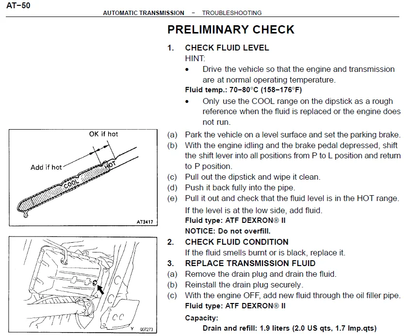

my 97 had hard shifting from 1st to 2nd when I first brought it home, ended up being 6 quarts low. Amsoil ATF is fantastic stuff by the way
