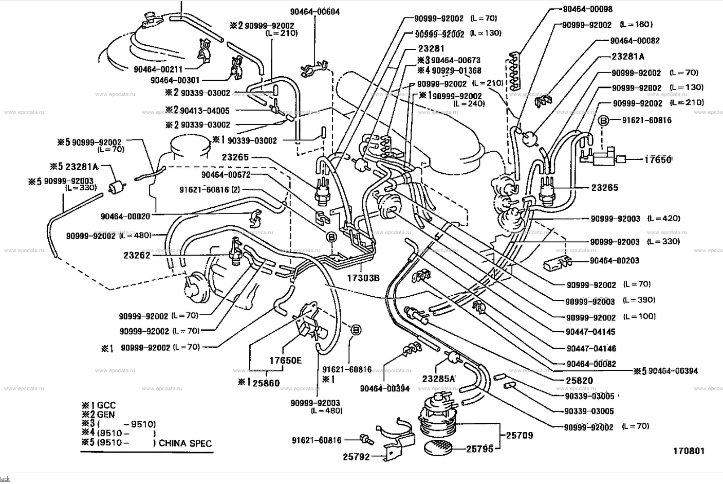

I think below is the vacuum piping diagram for your engine (1FZF). I originally thought the bleed ports on your HAC (high altitude compensation) Valve were inproperly plugged, but the diagram shows the two ports are plugged, so I guess it is as it should be. The fact you have an HAC valve may mean the previous owner was just "running it" with no modifications.
carburetor jets seem to still be available from Toyota, so you might try to replace yours assuming they really did something like change the jets.
So with the HAC being properly plugged, it actually still in use in the system? I was concerned might be effecting my carb at sea level if it’s used to help carbs at higher altitudes Or if it’s actually faulty. Any reason to not just remove all the hoses and plug the ports to completely bypass the HAC?

The open vac fitting on the air horn is HAC. Can be capped below 4k ft.
