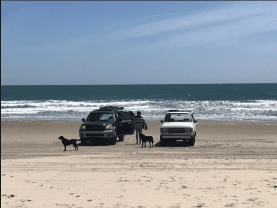

And took it on the beach with my brother and his dogs for a shakedown run. 4wd works great, and the brakes were sticking bad so I have to tackle that next.

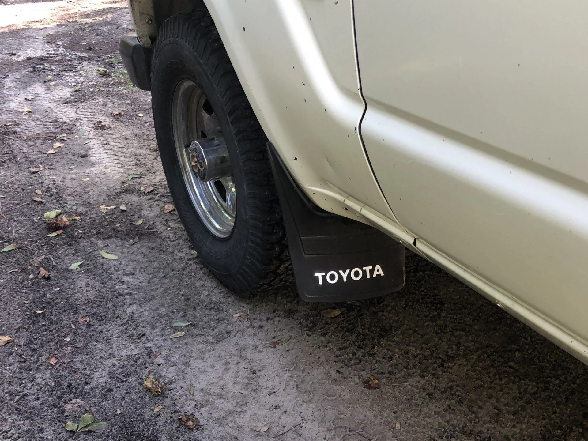

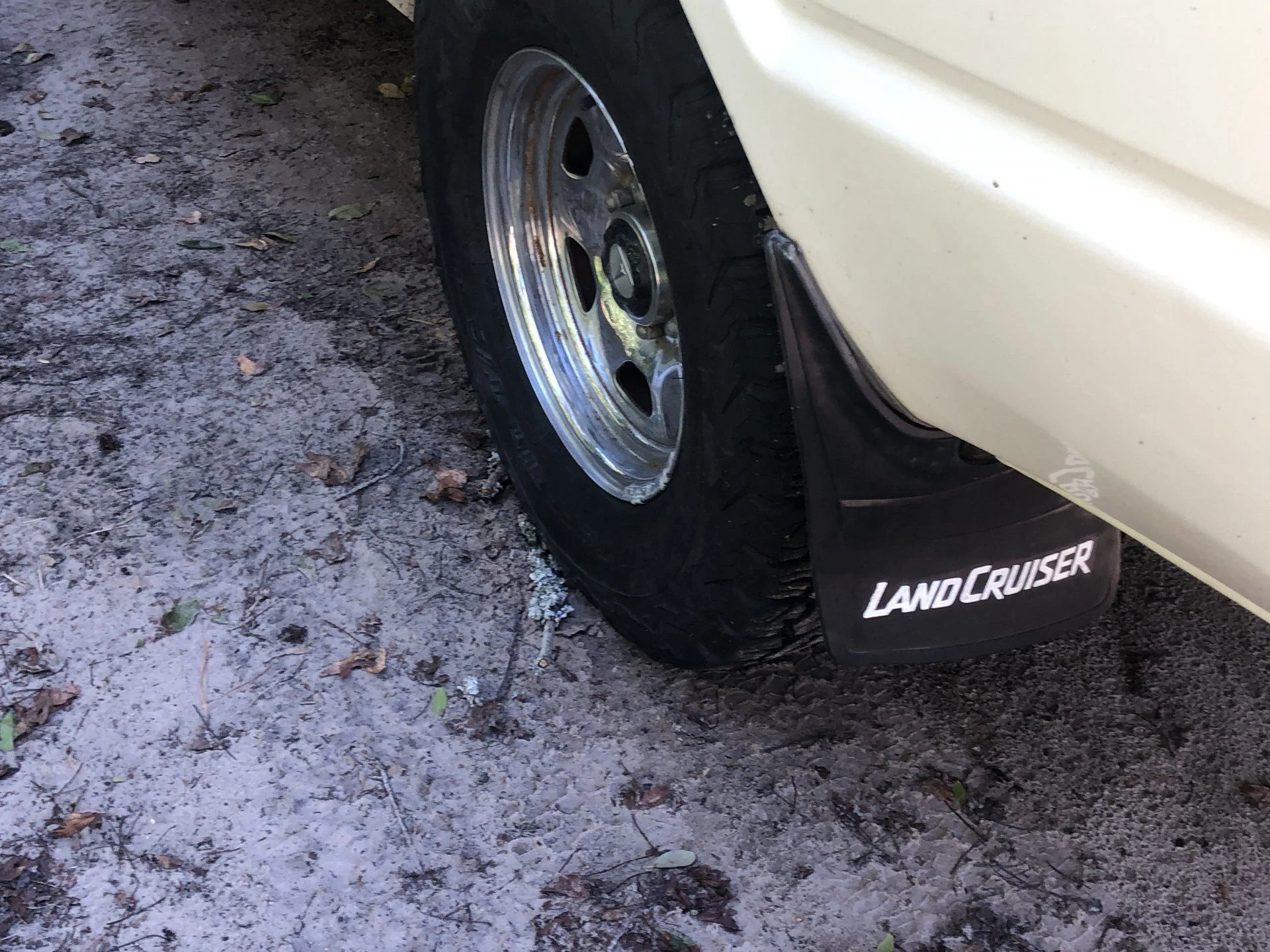

Not enough time for brakes lately, but I redid my naaaasty mud flaps. Little bit of steel wool and a paint pen did the job. Also sanded and painted the brackets.

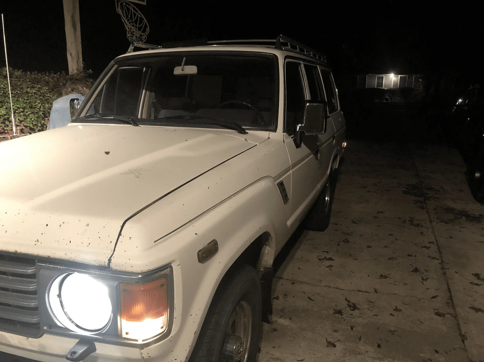

Alright y'all, here's a build update!
Been tuning it up and getting it "up to speed" (no pun intended) and got a new part or two.
New set of FJ62 Mirrors. These are OEM and brand new still in box. Got them from partslane on Ebay and they shipped from Dubai. They look fantastic
They are a massive improvement over the dangerous stock mirrors. The passenger side mirror is convex, allowing for a larger FOV.
Also tightened the manifold bolts and got rid of that pesky vacuum leak. Obviously went out for a drive and "tested it out" :)

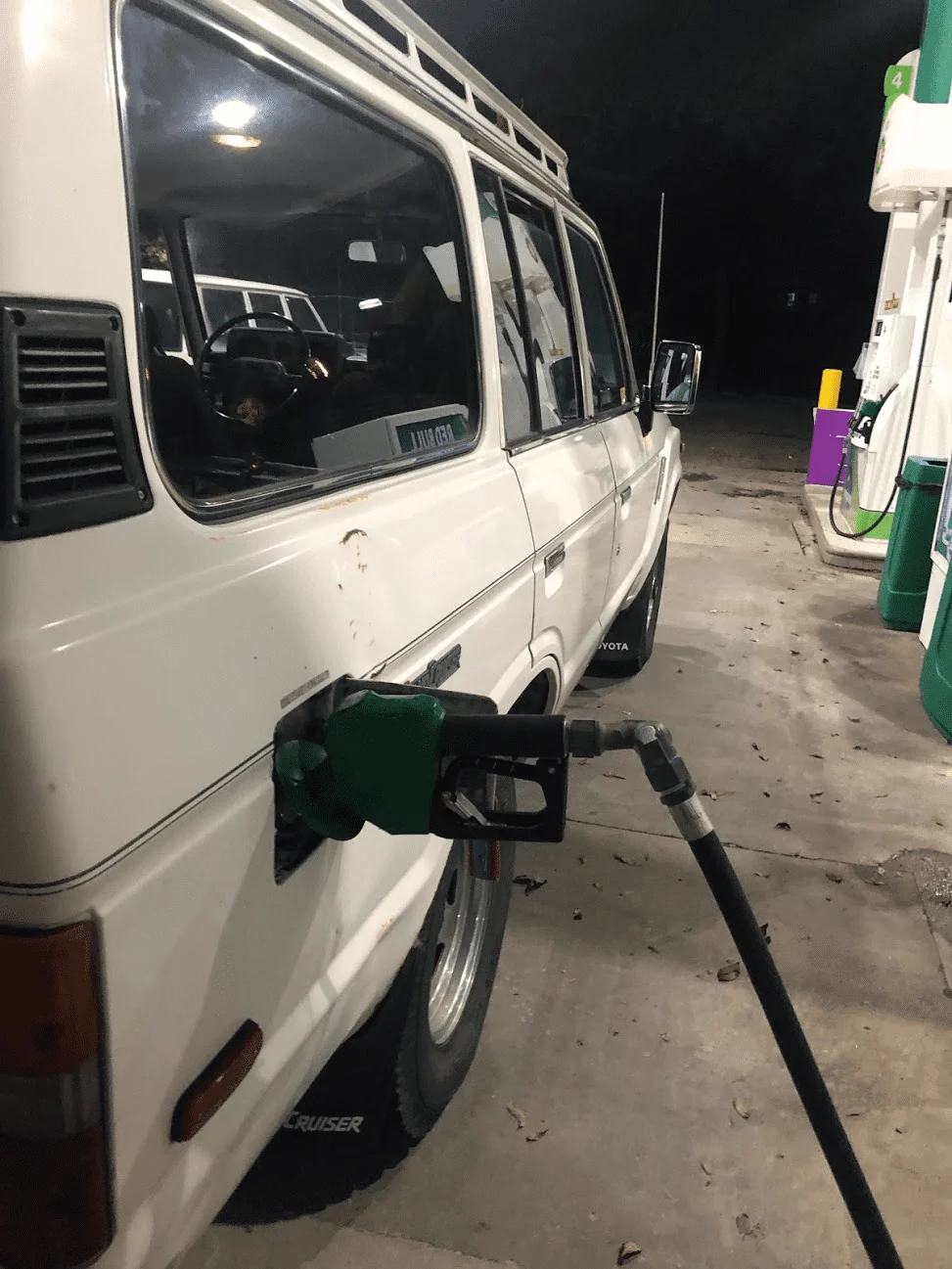

Good news: after a few tanks of gas, the gas gauge reads dead accurate!!
Rebuilt the brakes (sorry no picture of the new brakes) New drums, shoes, hardware, cylinders, etc.
For the front, I left the rotors, but replaced stuff with cardone calipers, bosch pads and centric lines. Pedal feels much better, but I still have a tad bit of air in the rears.

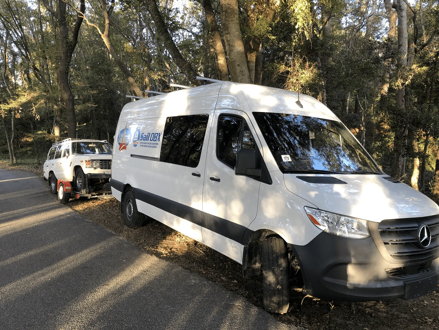

I was originally going to drive Leroy up to Bealeton, where Ryan's shop is located. However, I just don't quite trust Leroy yet to make that trek without a support vehicle. Also, the tires are old and dry rotted, and it just won't hit the speed limit easily without really wringing the guts out of the old tired 2F. So, I've opted for the tow dolly strategy. 2 wheels on, 2 wheels off. Luckily, the nicer tires are in the back of the car, so that helps bring my blood pressure down. Here's a pic
The Sprinter barely has enough towing capacity to pull it, but I figured I would just go slow. I wish I hadn't sold my 6.7L F350 so soon! It would have been perfect for towing this! Either way, hopefully this goes smooth enough. Driveshaft is disconnected, sitting in the trunk.
Is there anything else I need to worry about? or is the driveshaft the only thing I need to disconnect.
Anyways, thats all
-Mike
I think you're good with a driveshaft disconnected (remove it completely so that it doesn't fall off and be sure the parking brake is not engaged). I always stop and check the tow dolly straps 3x before I believe that they are actually tight. I seem to have a vehicle-ejecting tow dolly, so I'm paranoid about the straps.
