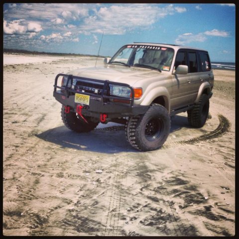

On the beach in Brigantine, NJ

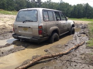

Getting stuck!

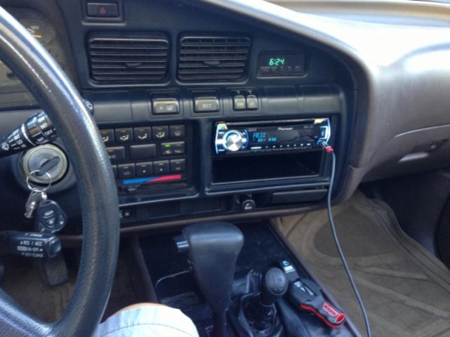

Installed a new pioneer Headunit
