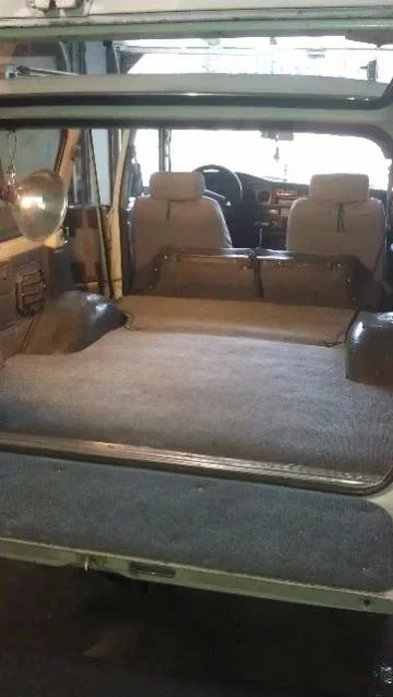

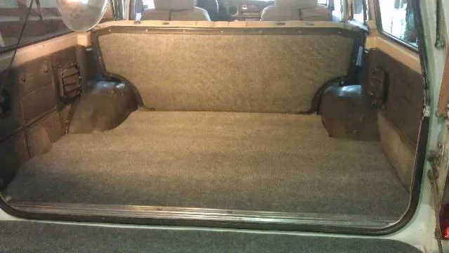

Since I was replacing the tailgate trim, thought I would do all the rear carpet to match.
Here is one with the seat up.
Got this indoor/outdoor carpet at Home Depot for $15, good tuff stuff. Added another layer of padding just in case I ever want to camp in it.
