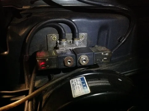

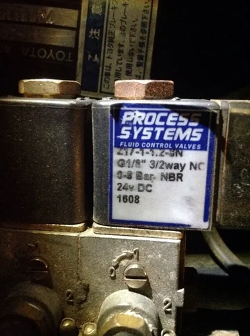

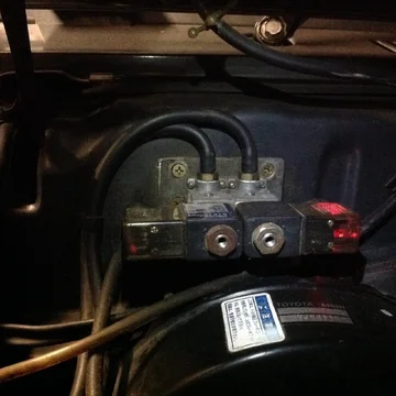

Hey dabasscow, Oldtoy's previous owner did not replace VSV, he put in 2 x 24v solenoid valves as a replacement, saying it was a much cheaper alternative than the expensive VSV on the firewall, I take a snap for your ref, they light up also when activated. P/o was an engineer, I have had no dramas with it to date
Thanks Oldtoy74, I did look at other solenoid options but they wern't that cheap, if you can post photos and part numbers would be great, the other thing is the guy I spoke to at the solenoid shop said they were a lot larger than the OE ones
