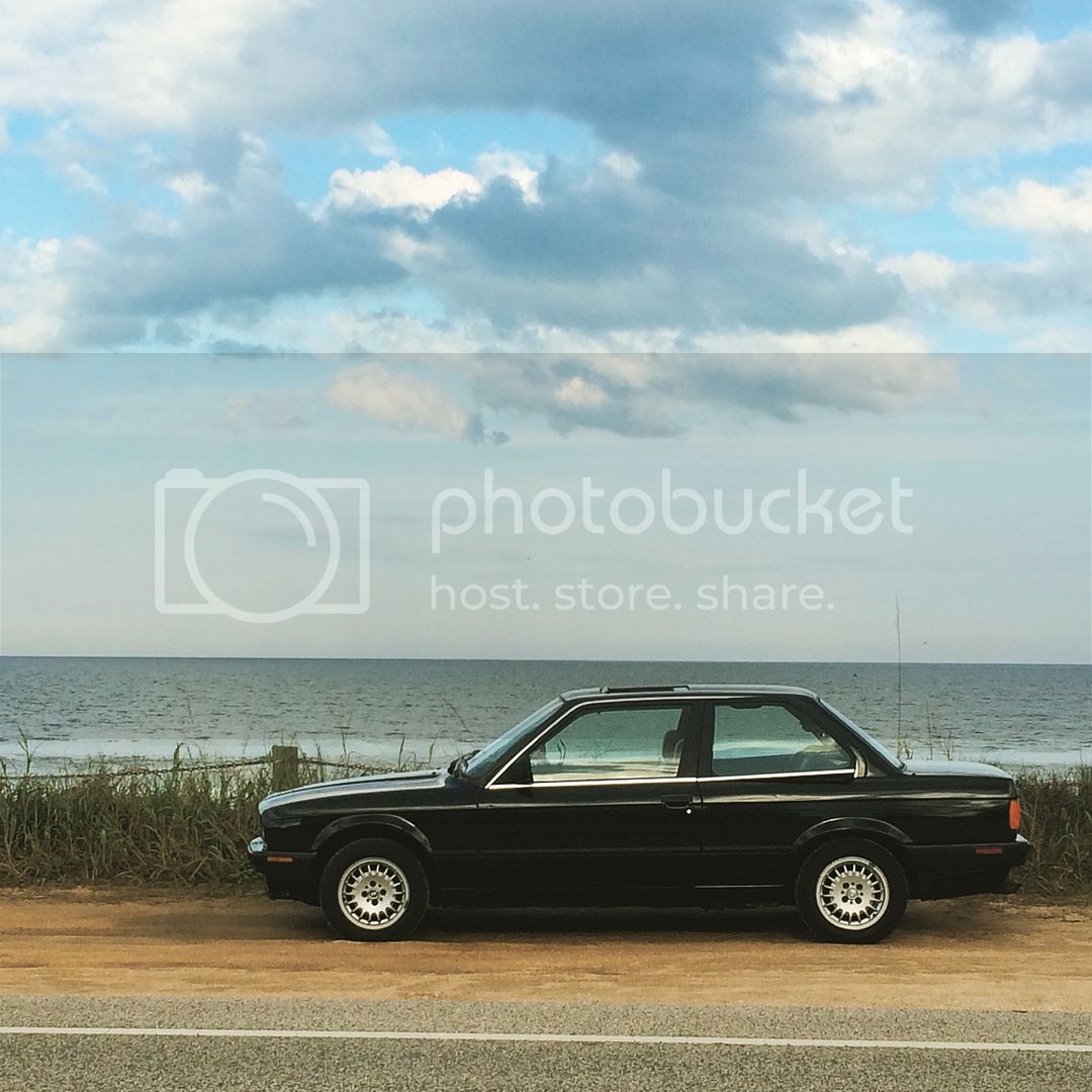

I now have a extremely low milage BMW E30 -- Not as fun but it makes for a cool daily driver. Ive since lowered it and put on some factory BBS sport wheels.
