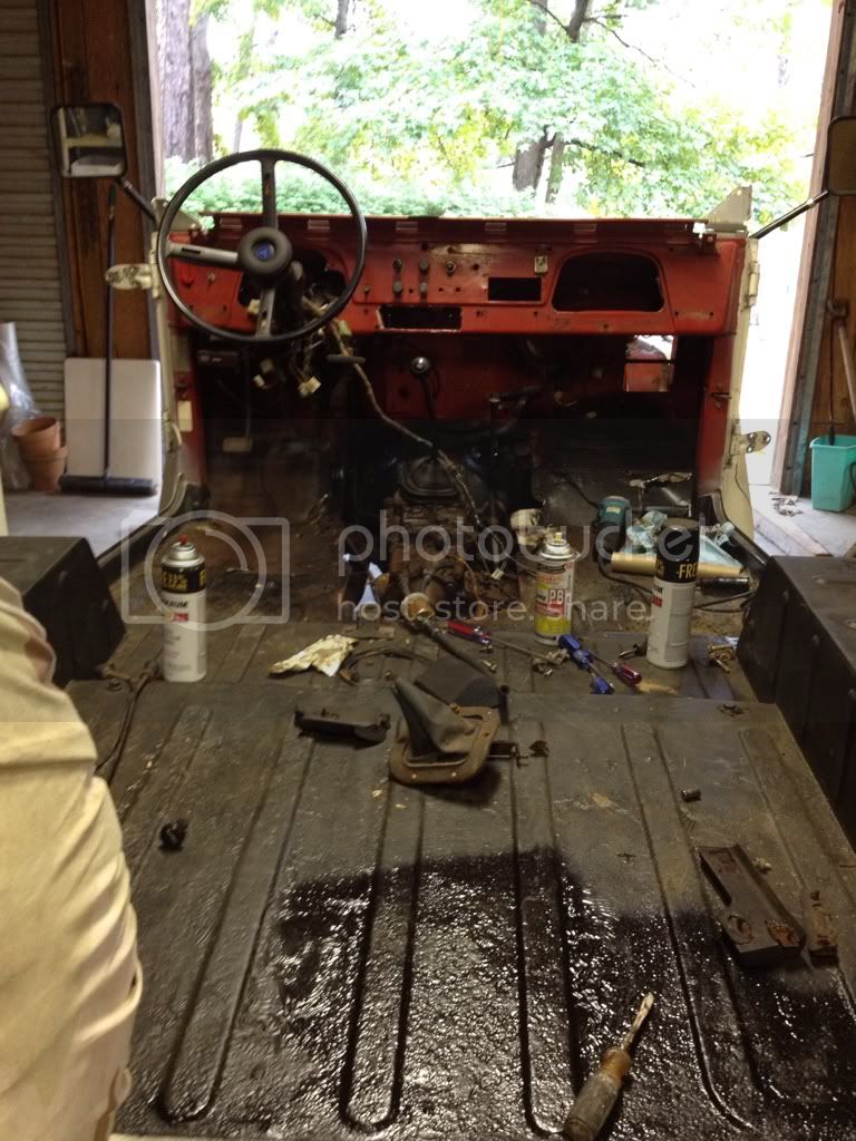

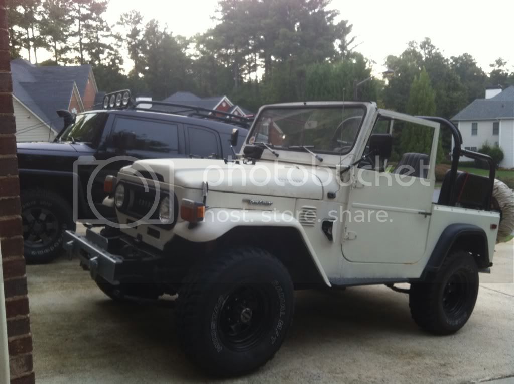

Heres how she looked the day I got it:

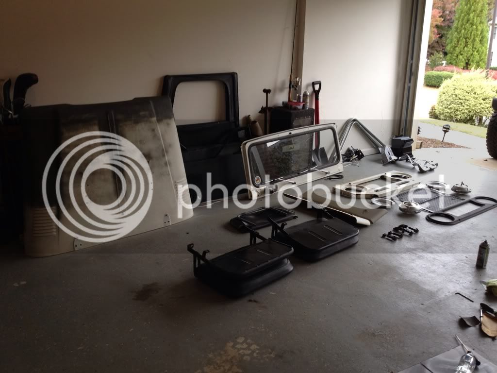

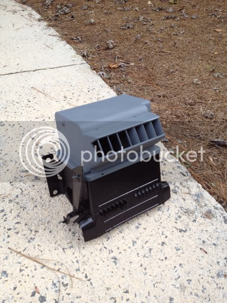

Heater, speedo, glove box, ash tray, fuel line cover:
On the silver pieces I did not go with a flat silver, I may re-do it but I like the 'Hamerite' paint I used.

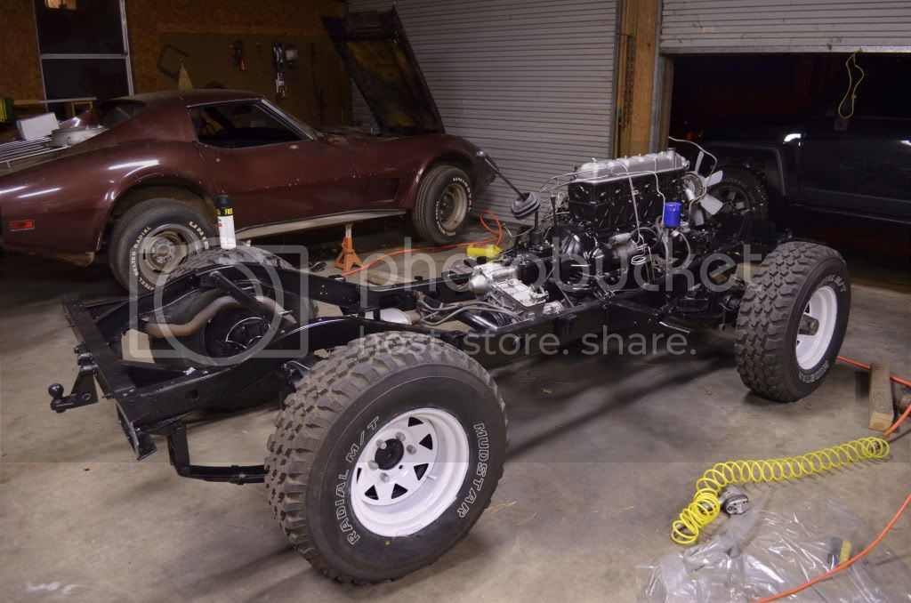

Started the tear down pretty quick:

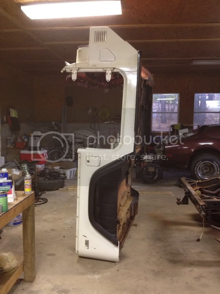

Got the tub off (10/28):

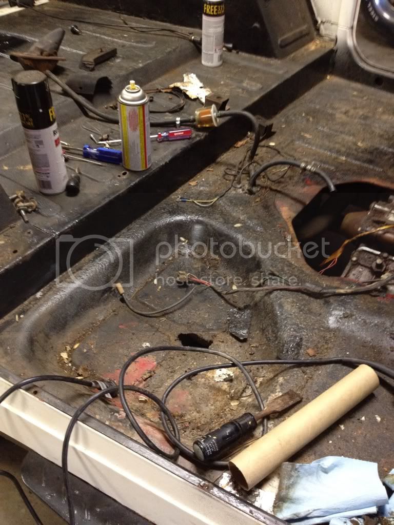

I ordered new floor pan, quarter panel patches today, getting them put in soon aslong with spot welding holes in the tub.

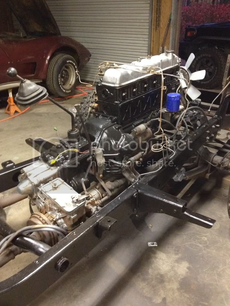

Well I have finished painting most of the frame, still have the under side of it, but I will do that when I take the axels off and leaf packs.
Going to clean up the engine and tranny tomorrow.

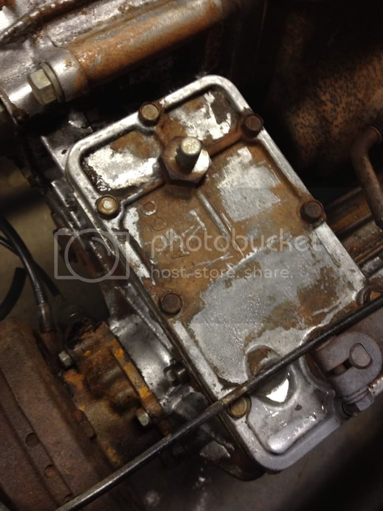

How do I get gunk off?
Helping his 30 year old brother out:
tucker74 said:
Degreaser, scraper, brush, rinse ... repeat ;)
Tucker
Sounds about right...I might just add couple that with a pressure washer. :)
I have pressure washed it, after scrubbing it with a degreaser. I have a stiff bristle brush I will hit it with.
Looking really good...looks like you kicked the grease in the butt!

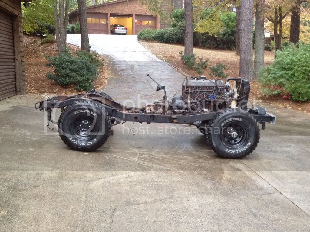

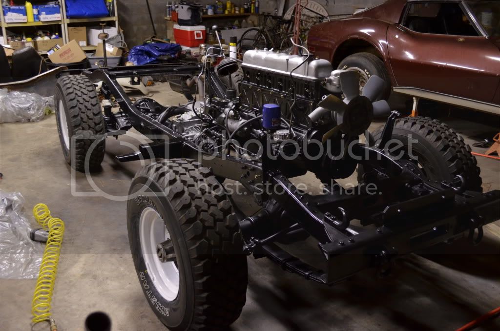

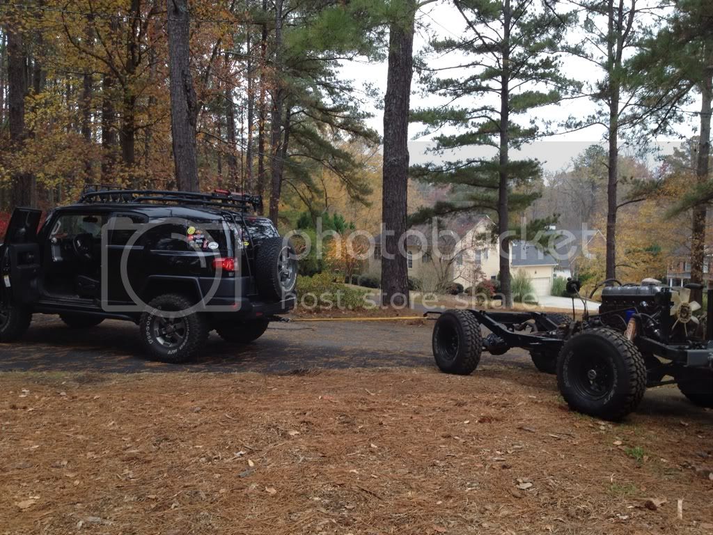

Ok so I am pretty much done with the frame, engine, axles and everything between. So I went to roll it all out today to wash it and it will not move more then a few inches either way. I am in N and 2h. When I jack the back up the rear wheels spin freely... but when I lower it it all locks up, is this a problem in the T case? 3rd member?
New photos, still not the best... only time I remember to bring over the DSLR its either raining or dark, both right now actually.
I got my bolt kit a few days ago so I am swopping them out right now. I am contemplating pulling the T case to properly clean it, because it is still packed with grease and grime. I am still need to pull the steering arms and the hubs to clean them but I will have plenty of time while the body is getting fixed. Also need to buy shackles, pins, and new leaf packs.

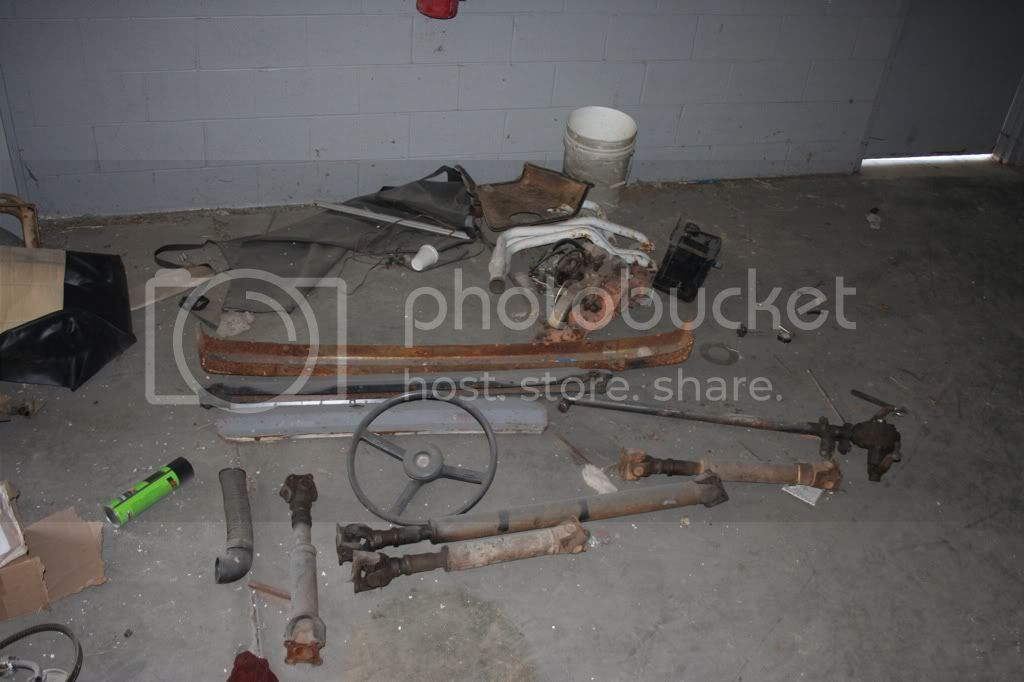

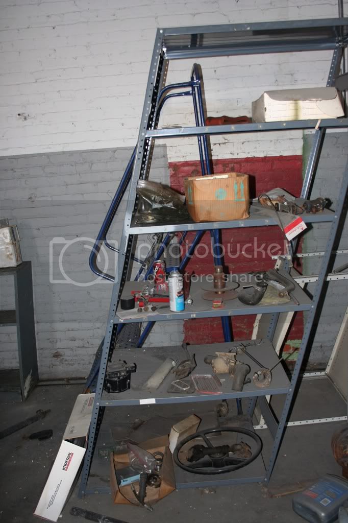

Found a 1970 about two hours away. I has a 2f, 4 speed trany and t case out of a FJ55. Also has a crap ton of extra parts. It needs a new upper lip and the rear channel patched (sill is fine).
Heres abunch of pictures that the now PO sent me,

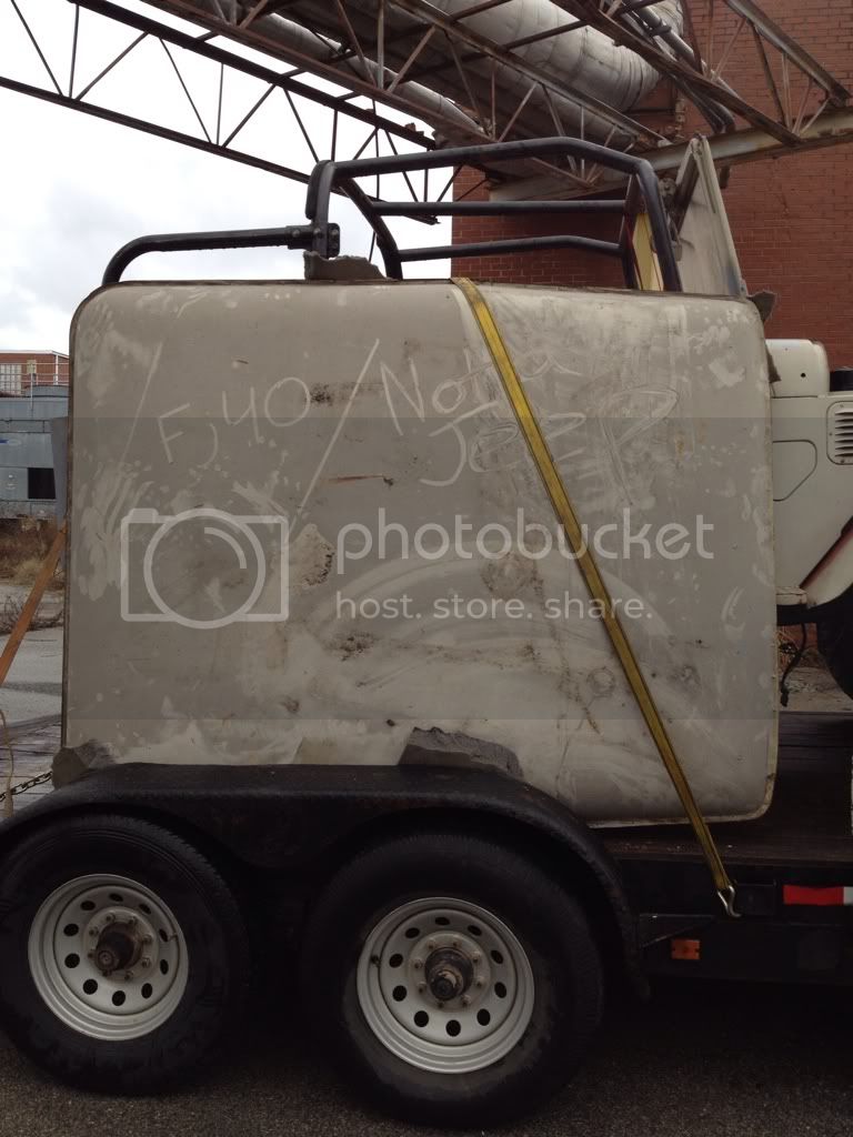

Loading it up to take home,
