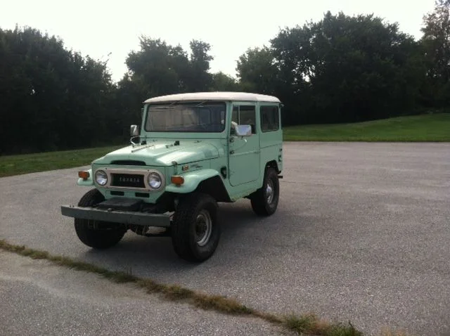

    Quadruplets - my '71 FJ40's build date is also 12/70, and may eventually be painted the same color as this one. My '71 is the one on the right side of the photo <----. The other one is my '76.

    77C883DA-DCE4-4E81-A965-9DF1755C63CB.jpeg 1C1A4E82-6C12-4A81-94DC-382B6E778F34.jpeg

    My 2/1971 was also Spring Green from the factory. I am just down the road from you in Paint Lick, KY! I would buy that truck as is, do the mechanical stuff, put a coat of wax on it, and drive it only on sunny days for the rest of it's life!

    Wow! What a beauty!
