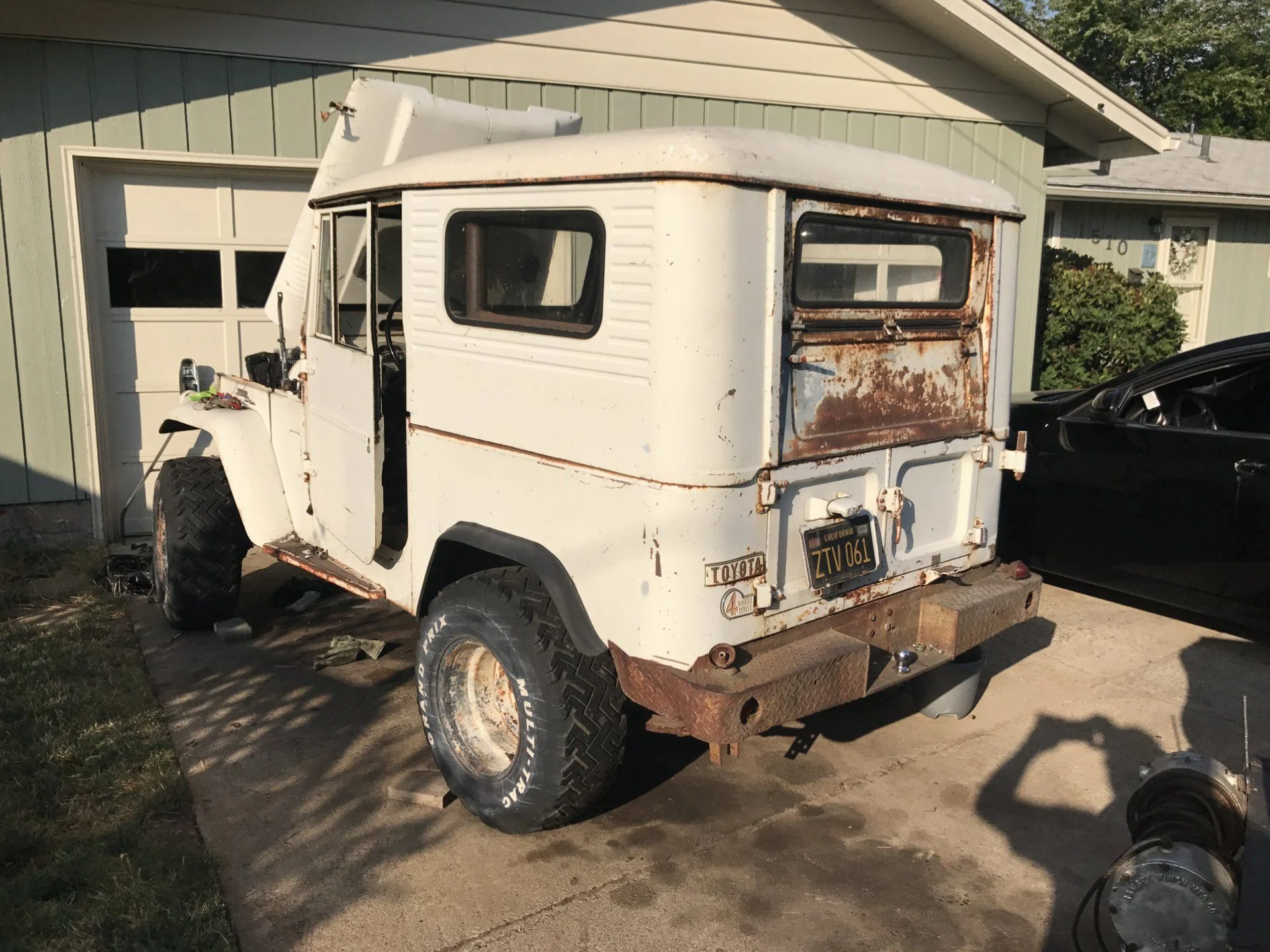

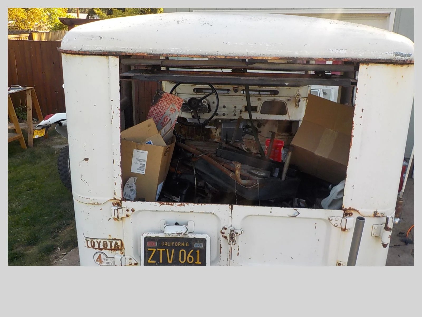

The truck is titled as 1966 but is a mid 1965 construction date. really towards the end of the "early" FJ40 style. It has been in Northern California/Southern Oregon for as far back as i can tell, and has been off the road for many years and was missing the motor, transmission, seats etc. I can see a faint sign painted on the doors, cant remember exactly what it says but when the light is right Ill take a pic.
On the positive side, it was relatively unmolested. The Lily white paint is original, no bondo or body repairs, no lift kits (other than the 5" rear shackle lift) or butchered sheet metal. It has a touch of rust on the rear sill, but other than that, really not bad. The corrugated roof is rough-i hope i can save it, but if I do go the restoration route this wouldn't be a good starting point.

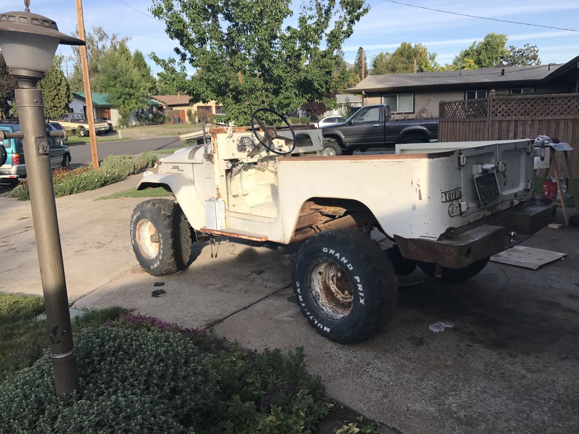

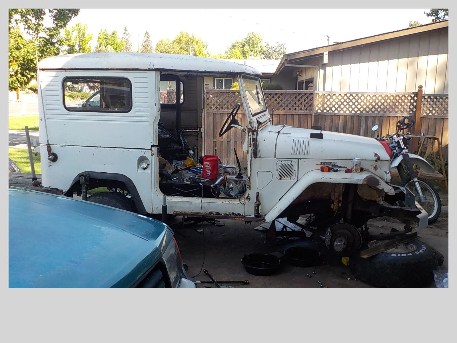

A pic. yes, I know, she is not the prettiest damsel at the dance.
For the last five months or so I've been focused on the mechanical stuff, and hadn't done anything cosmetically. I have a long weekend and thought I'd take a break from mechanical aspects and do something so it doesn't look quite as ugly.

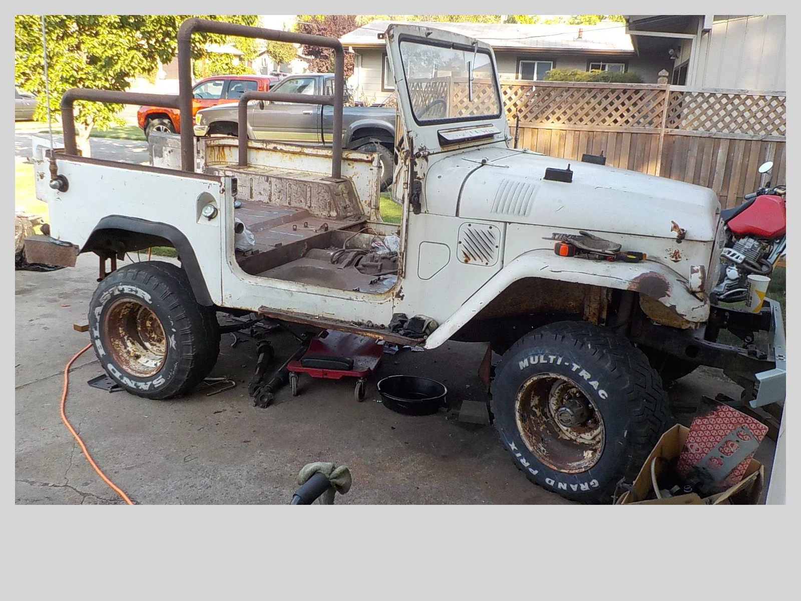

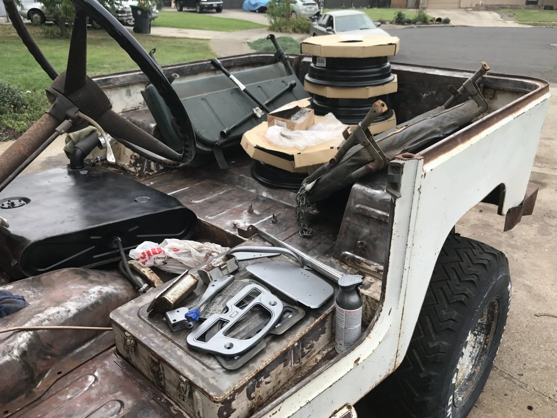

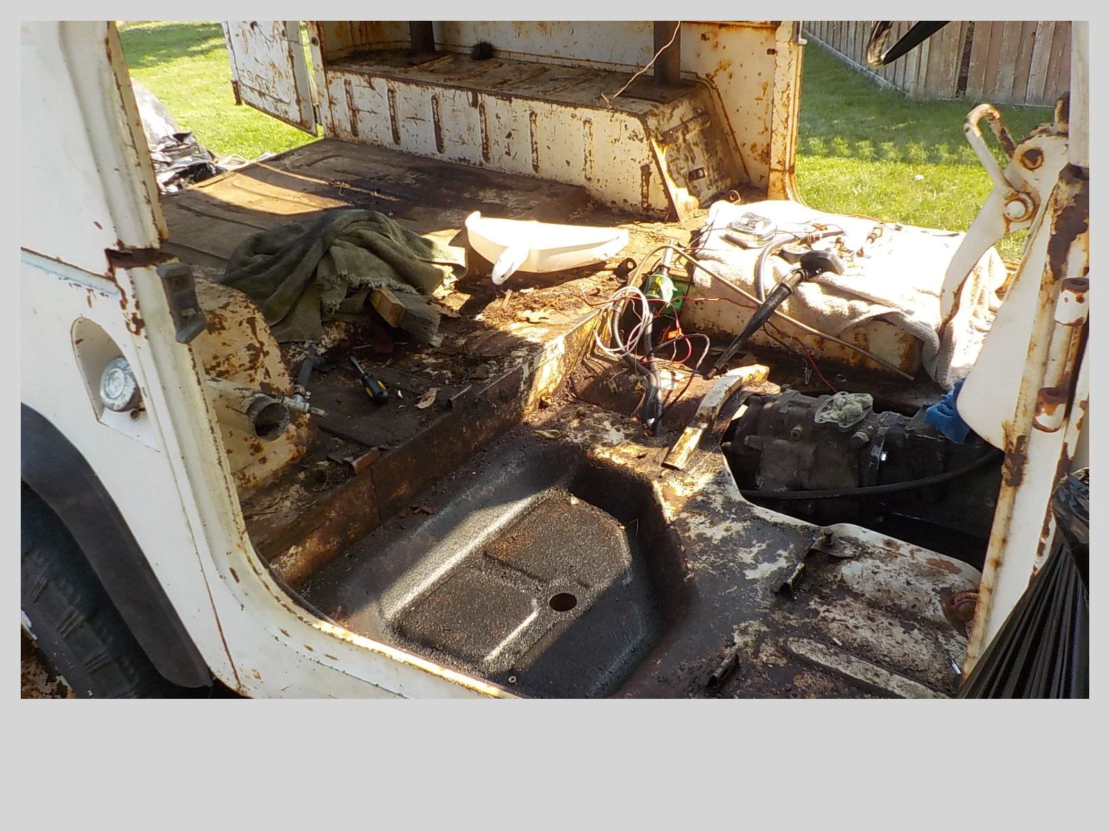

This is how she looked when I got home from work Thursday night. She's a mess:
The plan is to strip the paint out of the floor/interior and respray it before i permanently mount the gas tank and seats. I did my best to match the Lily White paint, but I suspect it will not be perfect. I'm not going to repaint the exterior. By noon or so this is where she was. I tend to work at a leisurely pace.

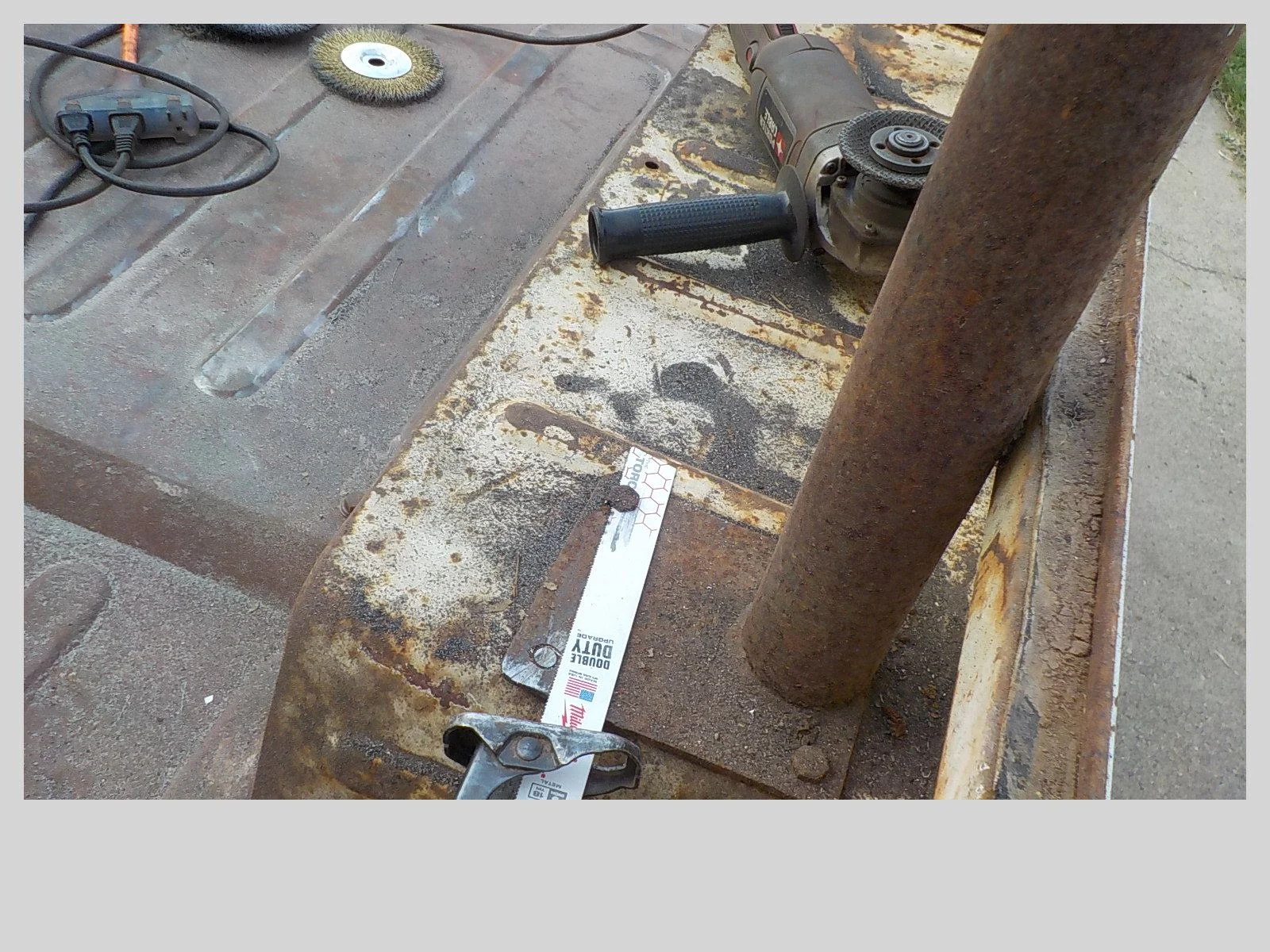

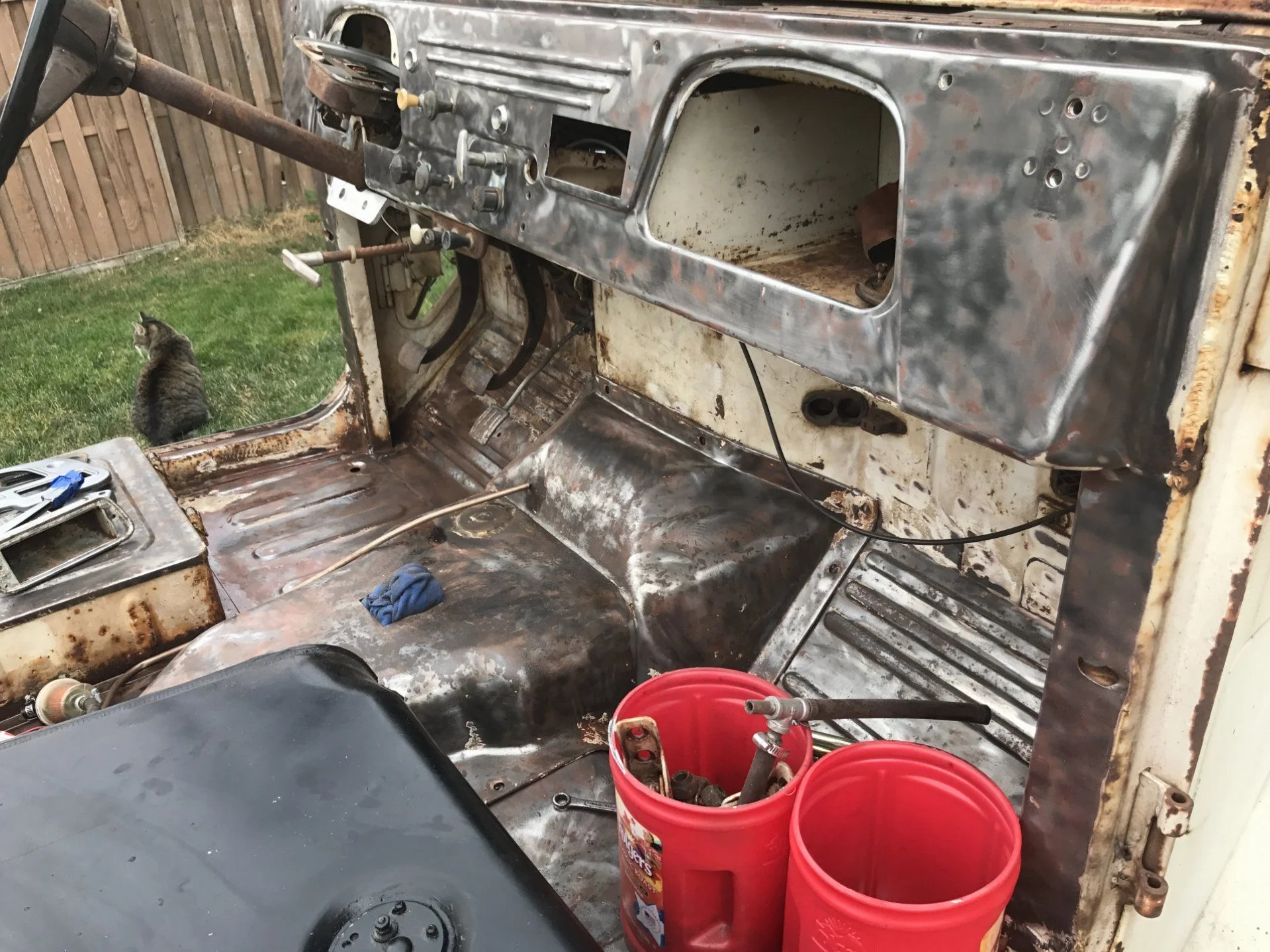

The quickest way Ive found to strip that stubborn old paint (alkaloid enamel?) is with a brass wire brush on a grinder. The stuff is tough and leaves a nasty taste in your mouth...should be wearing a mask I suspect...
So far the sheet metal looks pretty good. Very minimal pitting.

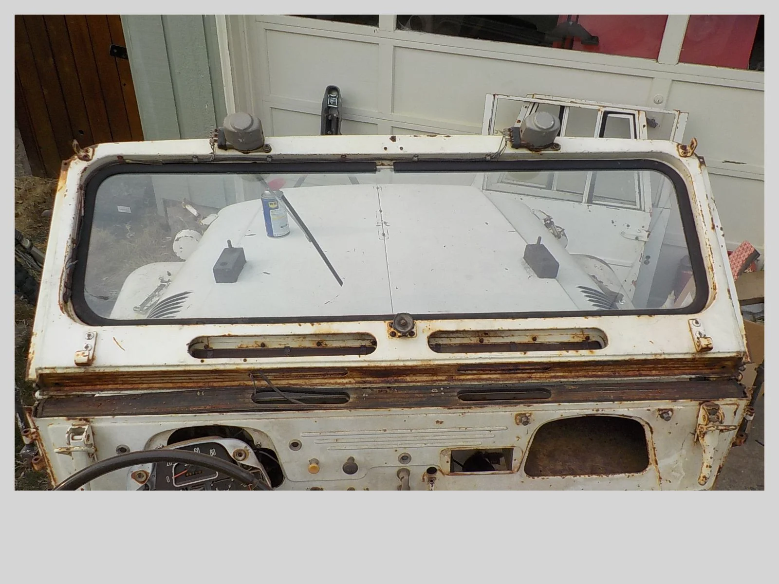

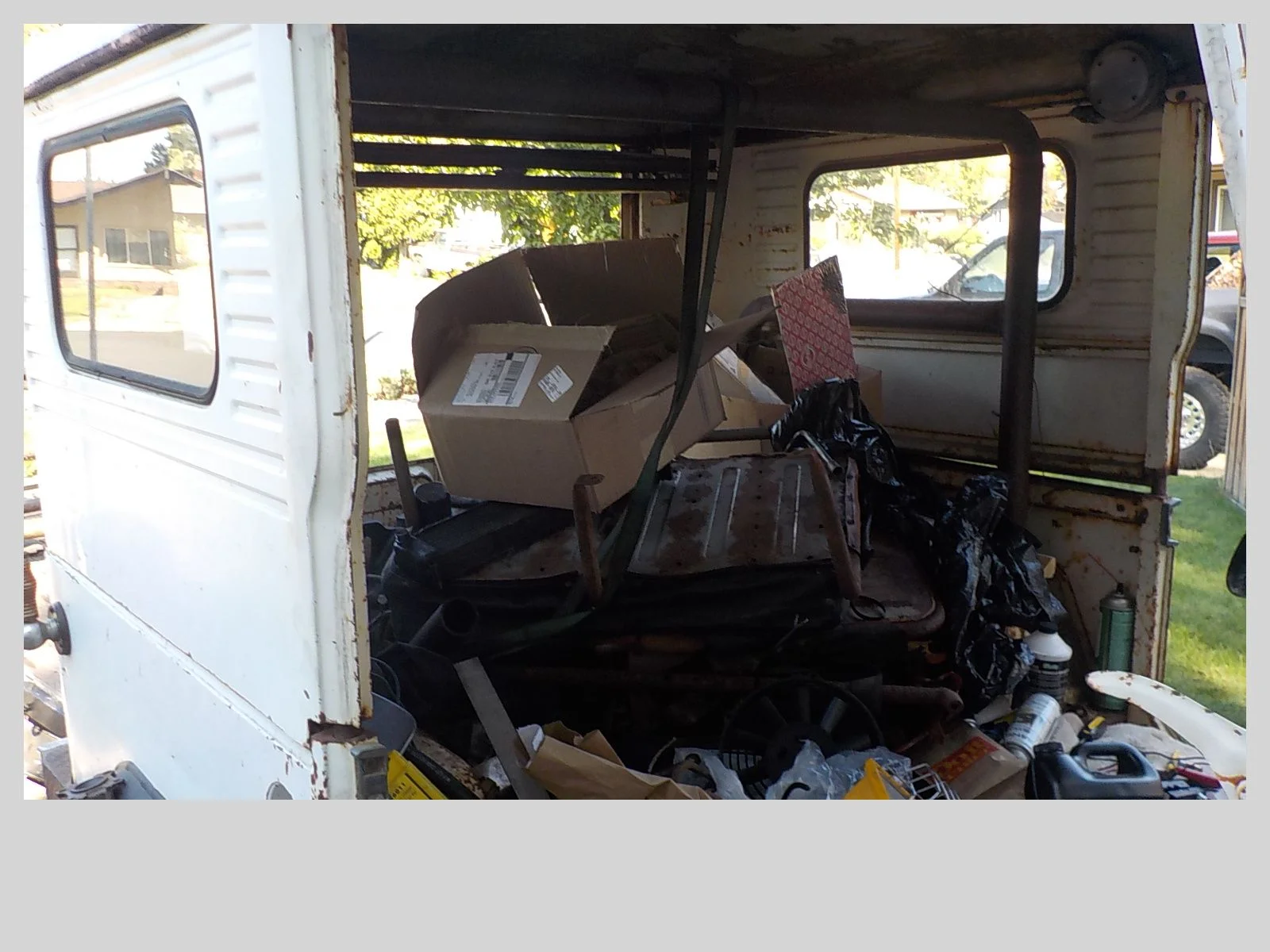

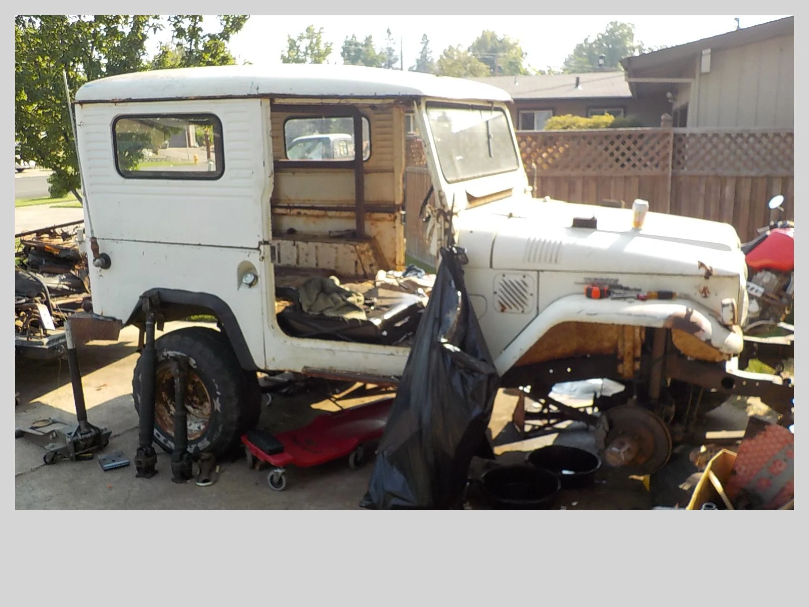

Had to wait until our son came home to remove the top. Even with three people lifting the roof almost fell apart.

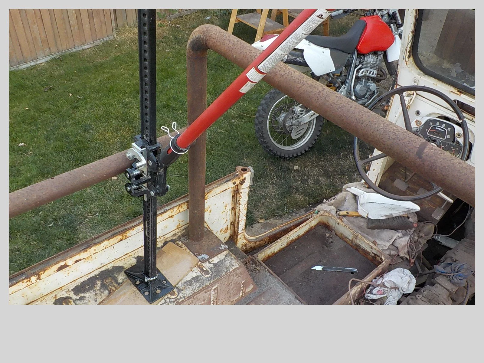

Then I ran into my first snag. It took over two hours to get the rollbar off. Even after the bolt heads were cut off, that thing would not come loose. Ended up having to use the hi-lift to get that sucker out.

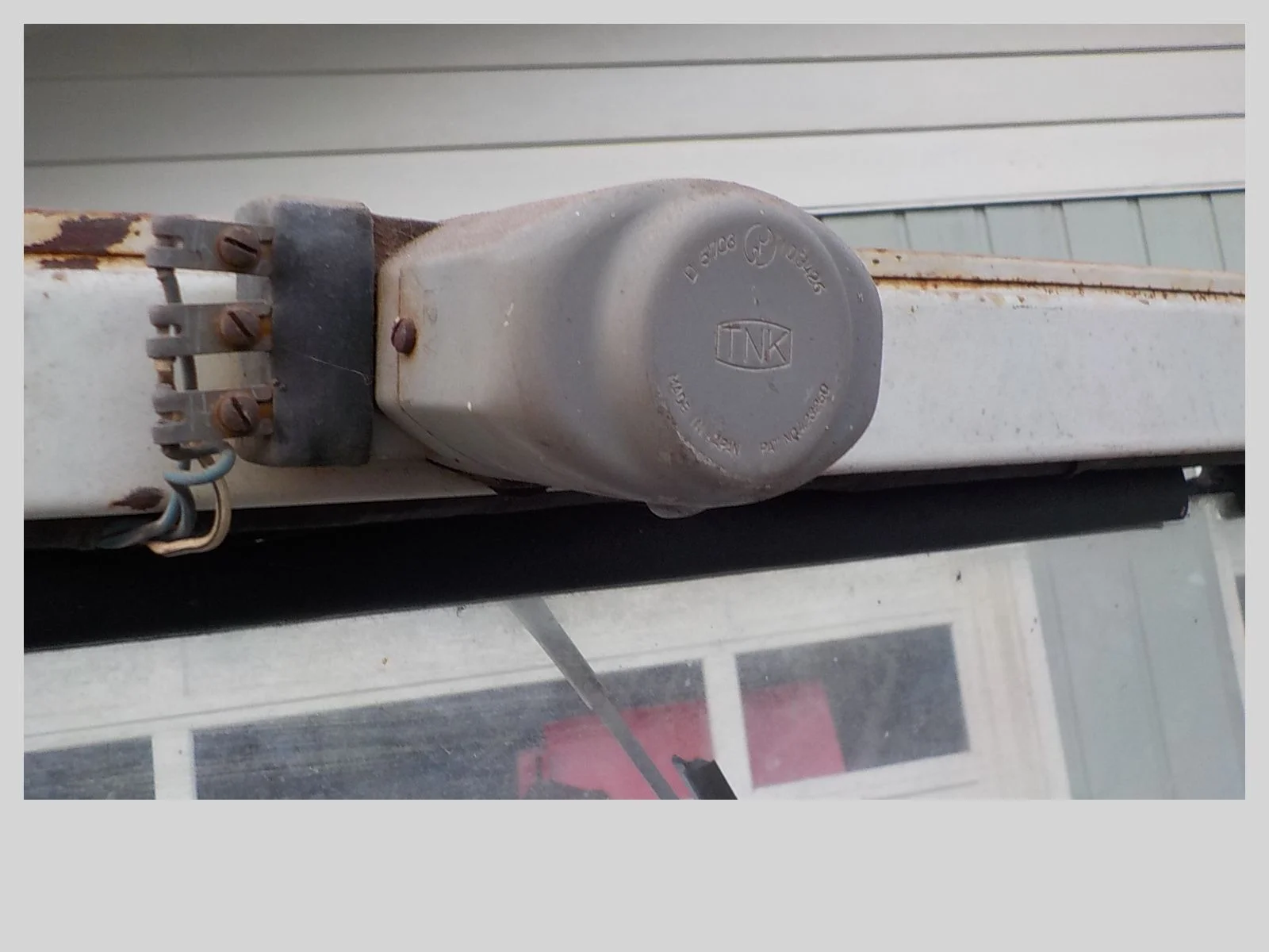

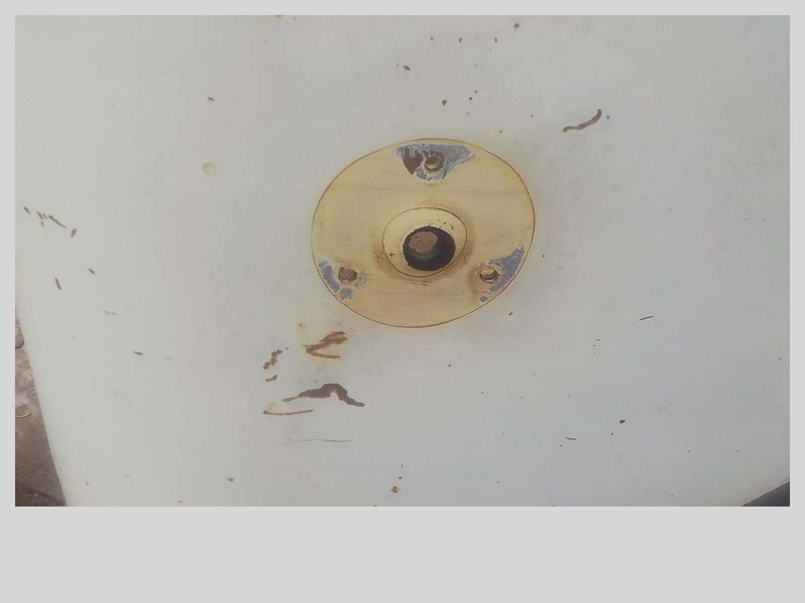

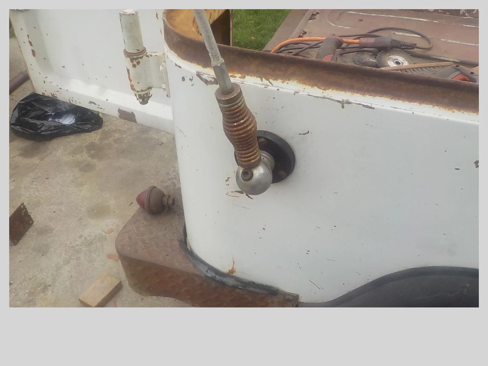

Did have a little surprise when I removed the "Breaker 1-9" vintage CB radio antenna. Cream/light yellow paint. Than wasn't expected.

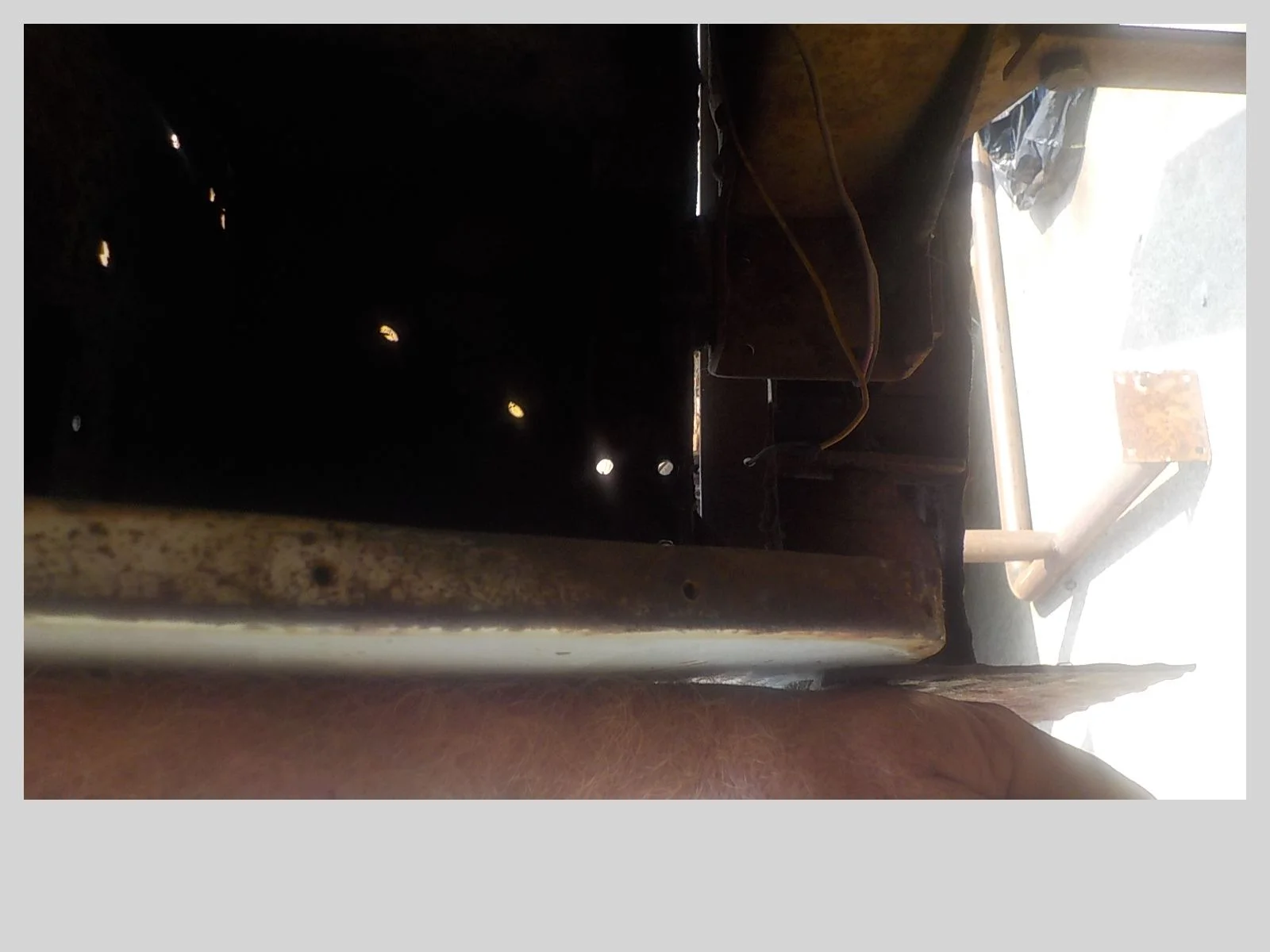

And a slightly more pleasant surprise-the metal underneath fender flares is in pretty good shape.
Didn't get as far as I had hoped. It still needs another day or so of prep work before I can shoot the interior, and I had a few hang-ups, specifically several switches on the dash could not be removed as the small screws were rusty/stripped. Since they are original and otherwise in good shape, Ill have to paint the dash with them in place. I have a Dremel tool with brass wire wheels that can get right up to the switch, not ideal, but it is what it is.
Several of the areas that can be problematic, like the drivers floorboard where it gets worn, or the rim where the hardtop sits and below the windshield were good. Don't think I've seen this much good metal since Twisted Sister opened for Ronny James Dio ;)

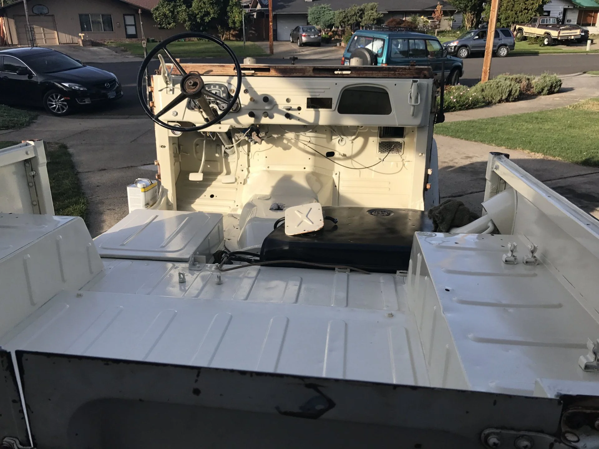

And I must admit, I did every rookie mistake possible. Drips, check. Dragged the air hose through wet paint, Check. Overspray in bad places. Check. Etc etc. But, nothing that cant be fixed:

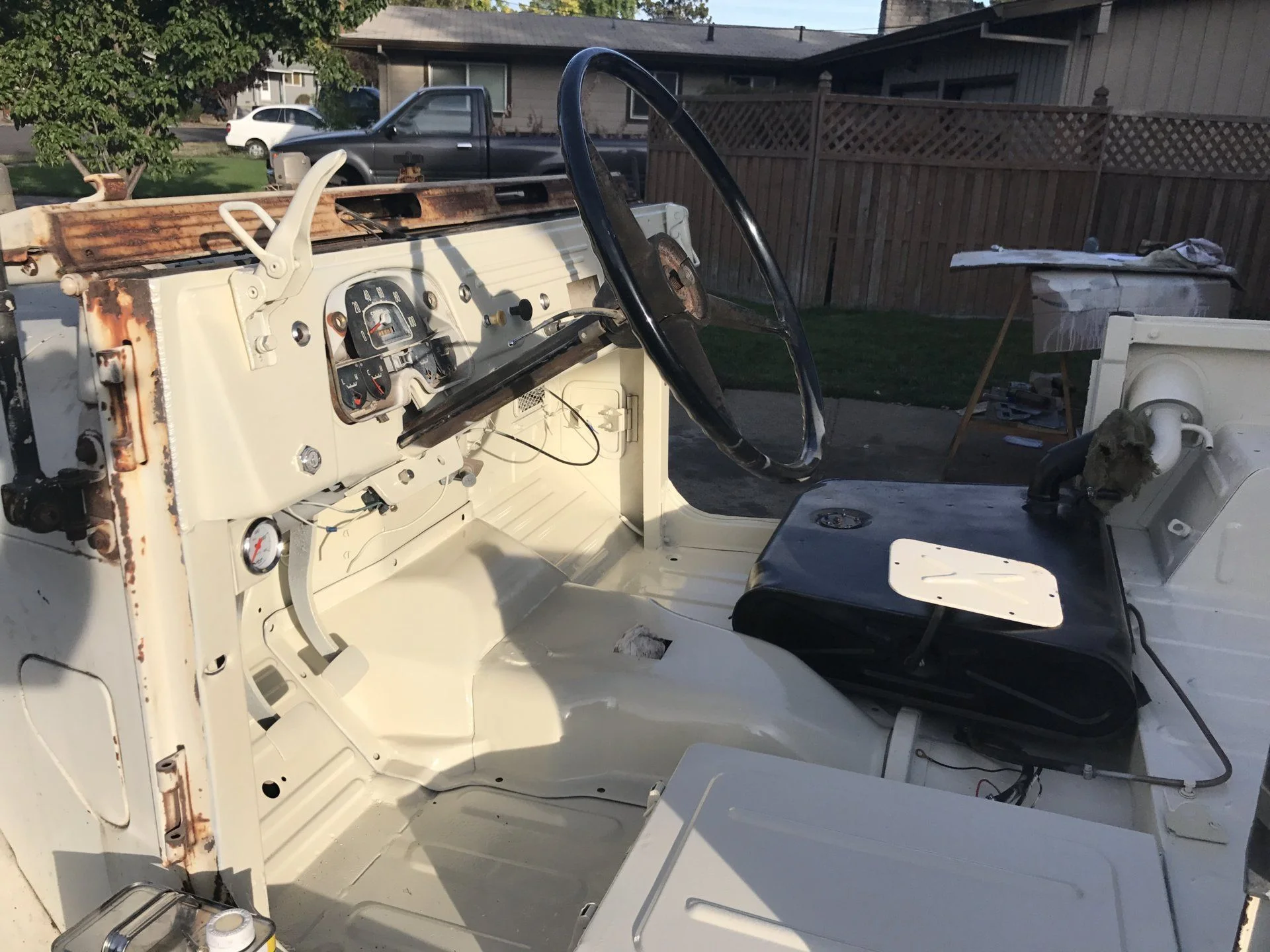

And a shot of the dash: You can definitely tell where The old paint ends.

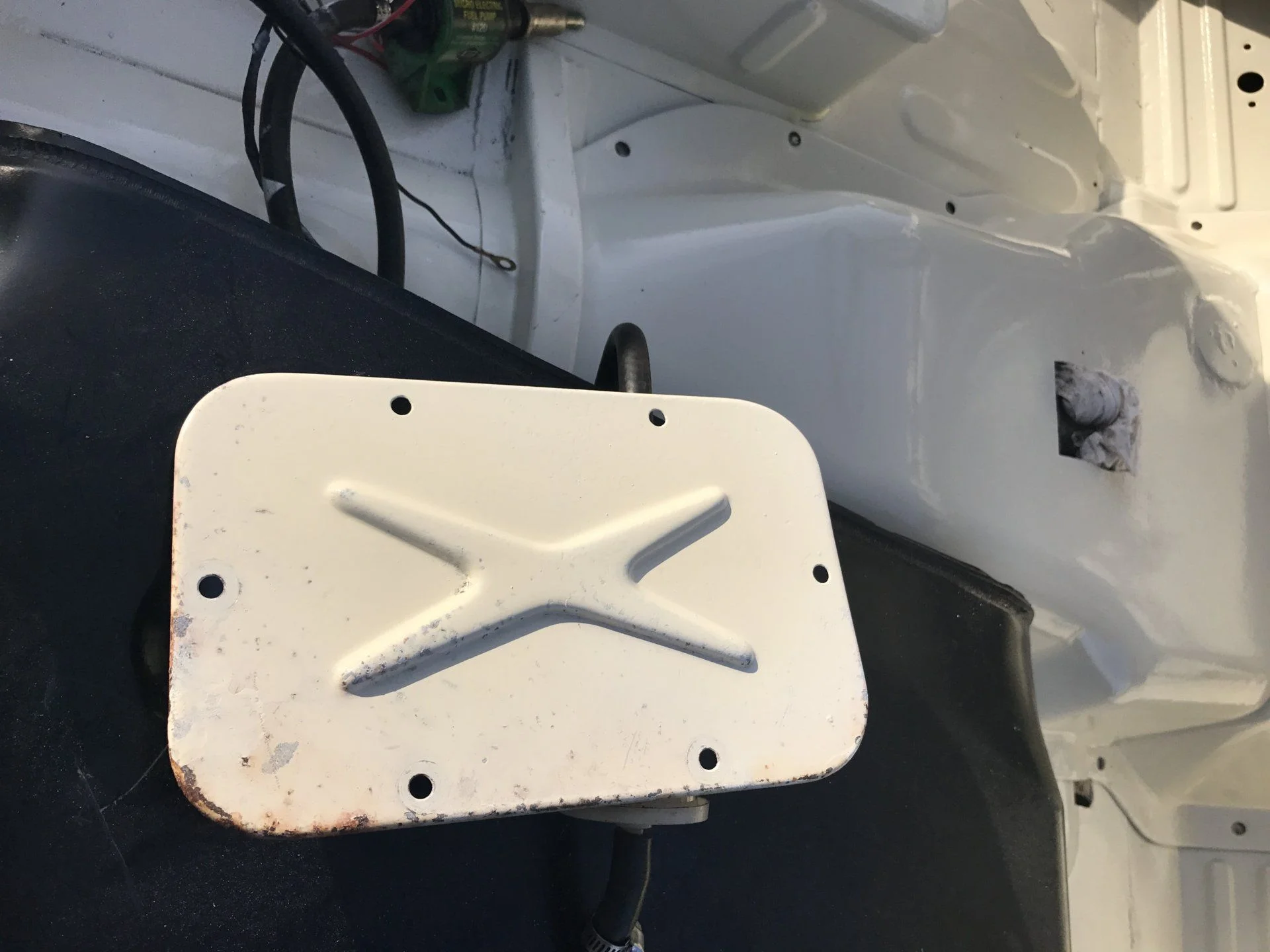

In various threads others I see that others have struggled to match Lily White (both of them), so I was concerned. My apprehension was raised further when the salesman at the auto paint store tried to match the paint under a florescent light. I could tell the color he matched wasn't close, so I asked if I could take their paint samples out into natural light and chose a match myself.

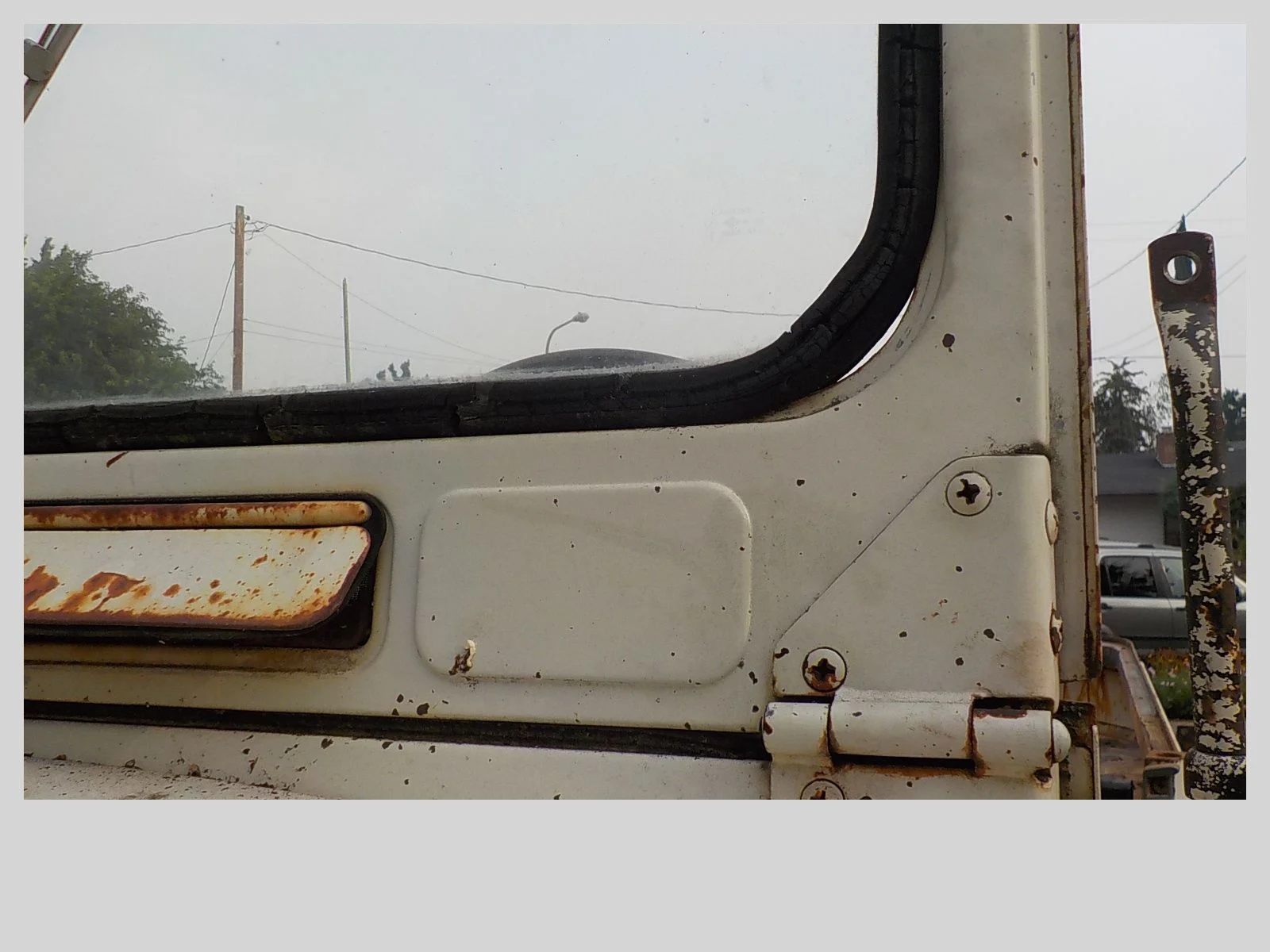

Below is a Lily White door access panel I used to match the paint. I painted half with the new paint, and the other half (with rust)I left. I let it dry to see if it matched dry (it didn't match wet) before I started painting the truck.

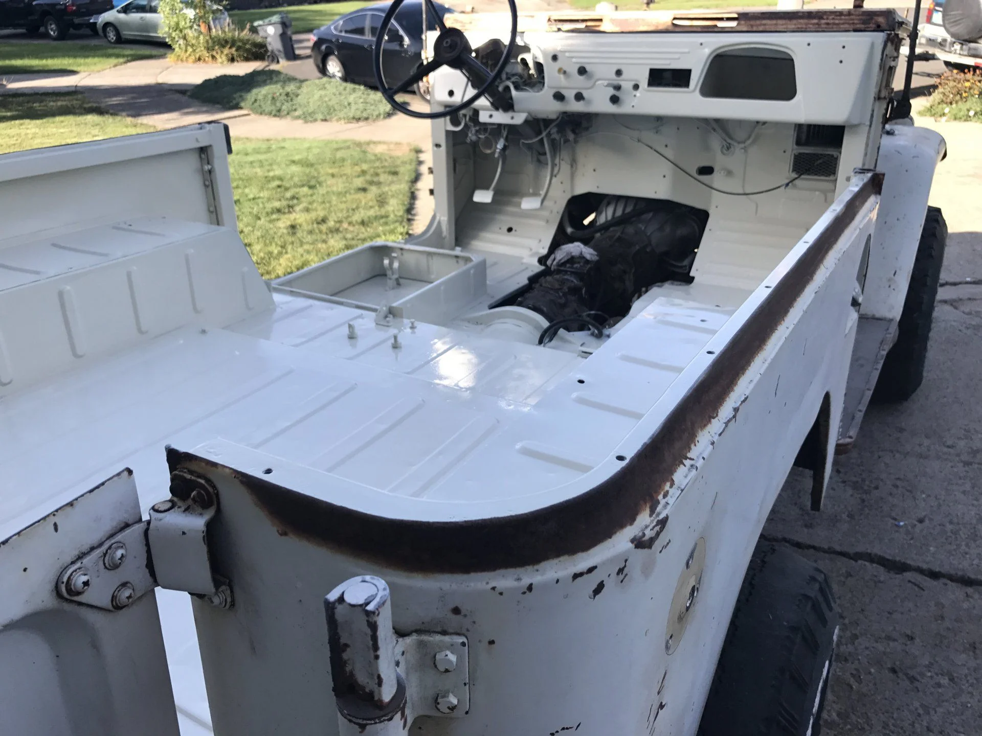

And a couple more pics: Since I didn't know how close the paint would match, I had to make sure none of the new interior paint was visible on the outside. It isn't a perfect solution as the exterior has its share of blemishes and surface rust, especially where the hardtop sat.
So goes another weekend. Still have a ways to go, but hoping to be on the road before winter.
