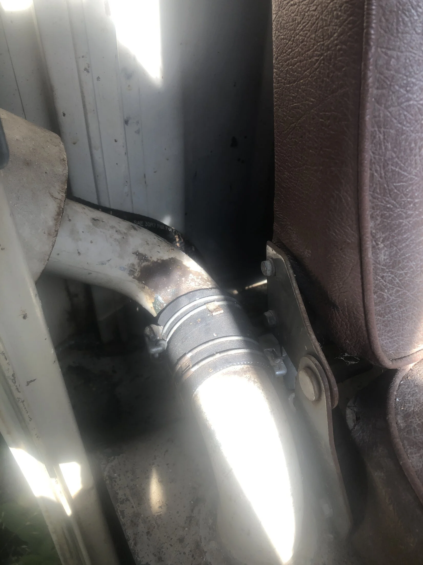

I am looking for an fj45 gas neck filler hose part. It connects the filler neck to the tank.
I haven’t been able to find one. The one in the picture is the replacement hose but it makes my cab smell like gas. The original one has a thicker center section in the inside of the hose that makes the fuel neck passage smooth the entire way down. The one I have gets gas stuck in the gap and is making it smell terrible. Thanks for your help!

I have some left over when I redid mine. I can send you a chunk! It’s generic Gates hose
We use the Fj60 hose and clamps and cut it to length.

Is it straight hose, or does it have inner section that is convex to match the filler neck and gas tank neck? I have some straight hose but it’s leaving a gas smell.
It’s a straight hose. It’s a non-woven rubber that is compatible with ethanol. Yours looks like a woven-reinforced wrap ? Maybe it’s too stiff to seal?
You may have a standing seam on one or both of your metal pipes that will need to be filed smooth so that the hose can lay flat. I seem to recall having to do that on more than one tank install.😉
