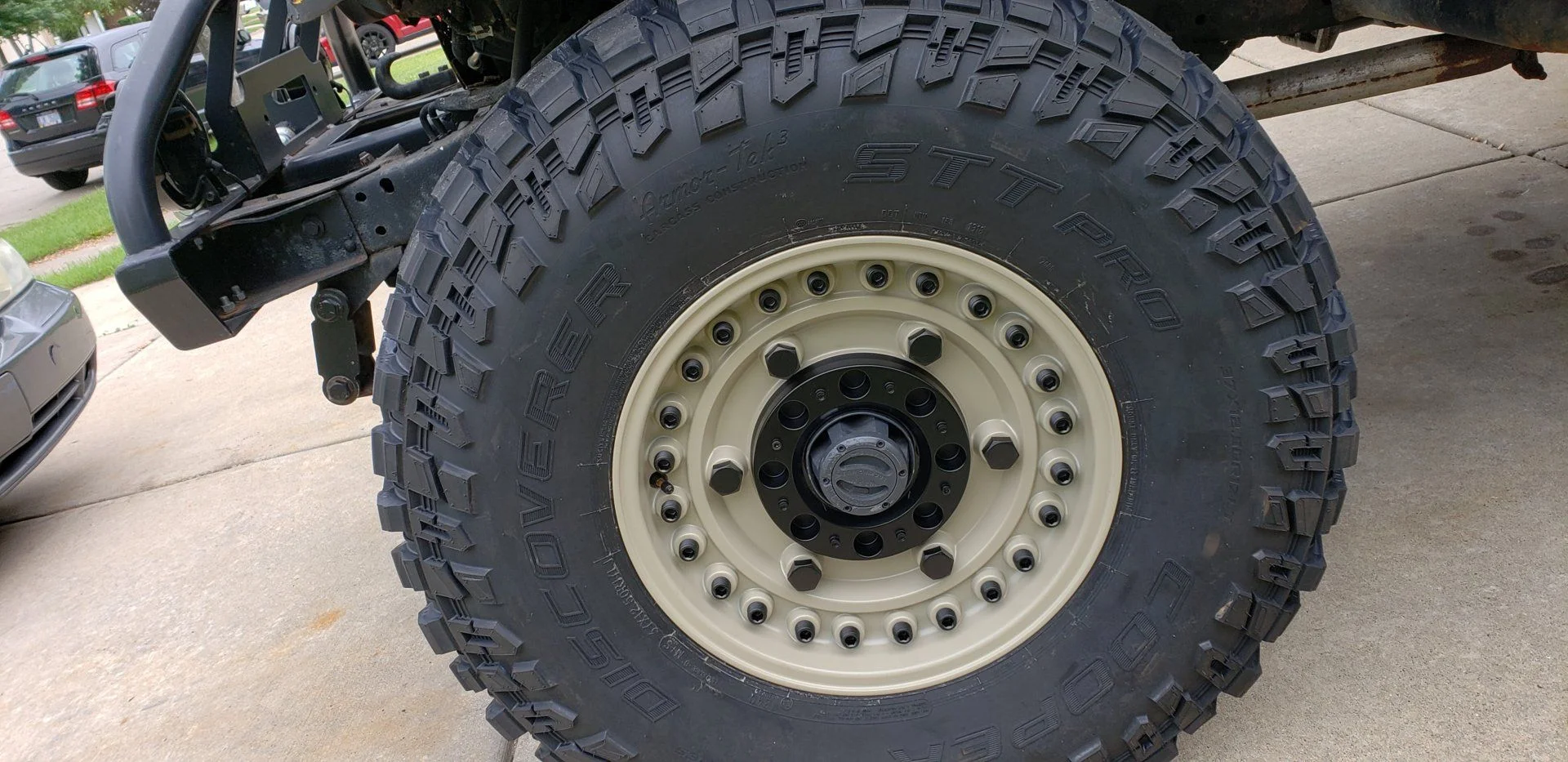

Posting my new rims and tire combination since I scoured post after post trying to find information on fitment and pictures always help tremendously. I wanted a certain stance and I knew 3.25" - 3.5" BS is usually the range used. There are, however, infinite combinations of rim and tire sizes and lifts on vehicles. I did find a few pics and info but not much detail or exact specifications. So, I am listing what I used and posting pics so this will help someone else on tire and rim fitment for their setup in the future.
I am very happy with my rim/tire combo and have no issues with turning radius. No spacers required. My vehicle has an SOA suspension.
Rims are Black Rhino Armory 17x9.5 with -18mm offset (4.5" BS) and tires are Cooper STT Pro 37x12.5R17

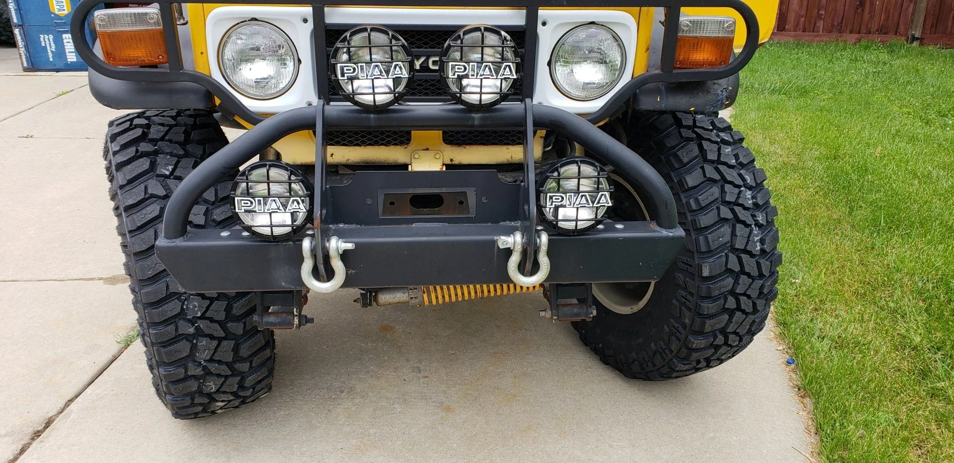

Stance

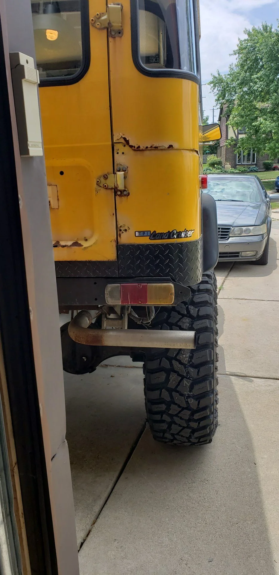

Profile stance

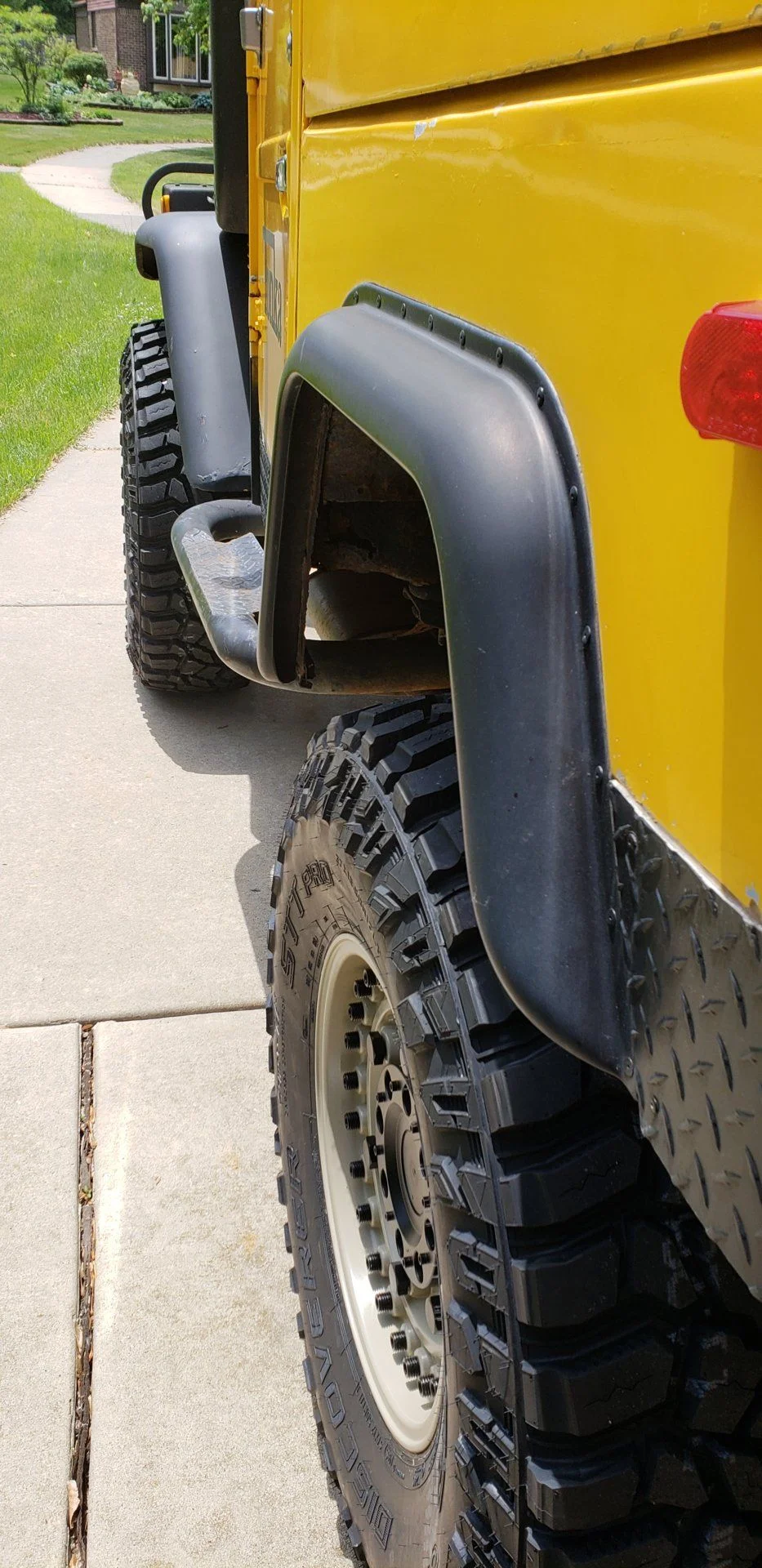

Turning radius at full lock left

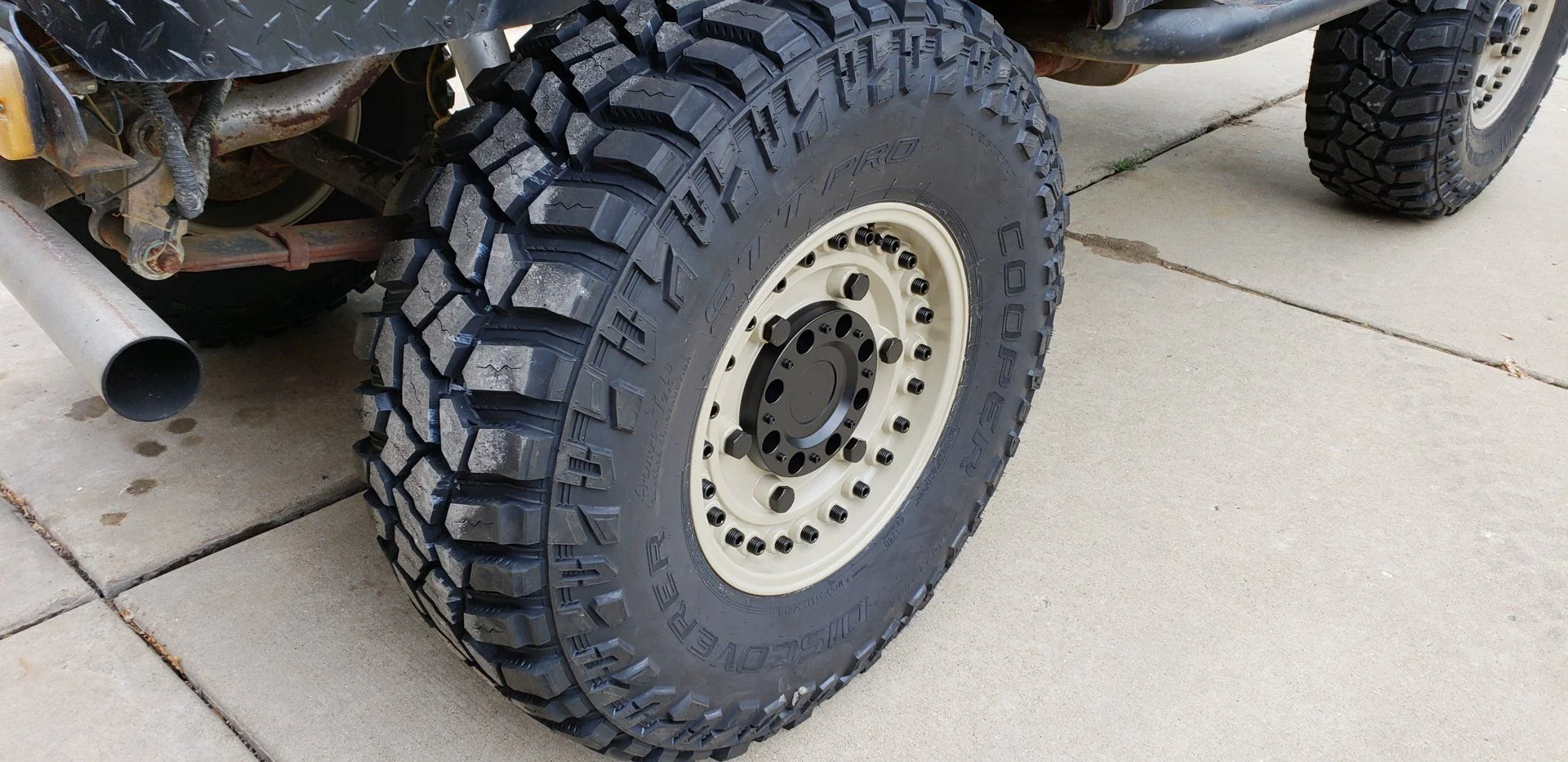

Passenger side tire and distance to leaf spring
Driver side tire and distance to leaf spring

yes a very nice stance, I think a desierable look for a lot of us. Unfortunately at the expense of using 17" wheels an tires.
@2001XJ, did you have to turn out your steering stops a bit?
looks good

No, I did not have to mess with steering stops at all. Although, the previous owner could have. I never looked.
