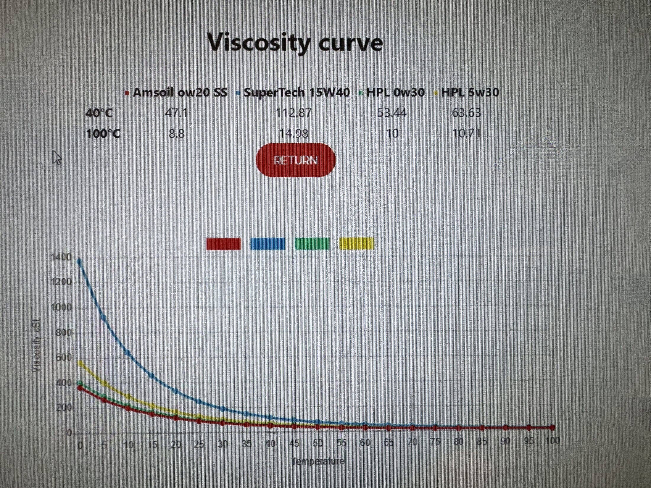

I ran a viscosity curve chart for you to consider found at Oil Viscosity Chart | Lubrication Tools | Interlub - https://interlub.com/en/lubrication-tools/oil-viscosity-graph/
I put in the cSt as requested using common solid oil Brands (HPL, Amsoil) and weights in use and the Supertech 15W40 you mentioned. The 15W40 is a thick oil for sure, especially around freezing temps that we are going to get for the next few months. Chart pic attached. Temp in Celsius
