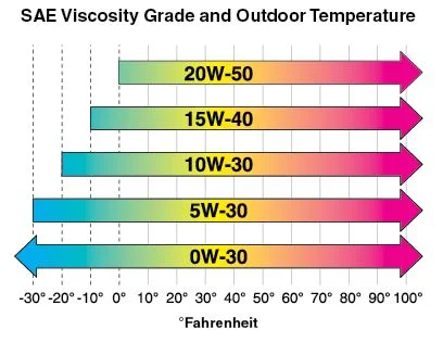

Now the next step up from that could be 10W30 or 10W40 or even 15W40 oil. I guess at some point cold start wear starts to increase, however in southern parts of the US which never get really cold, that maybe perfectly fine.

I am under the opinion that 5w30 \ 10w30 would suffice for both cold and hot areas, mostly in the USA where temps are greatly different in the seasons, as we have 4 typically.
Don't assume that 15w40 = less wear or even less heat. Blanket statements like that don't work in complex system.
It's been mentioned but cold startup wear is often more significant in modern engines, and where thicker oils generally are not going to be better.

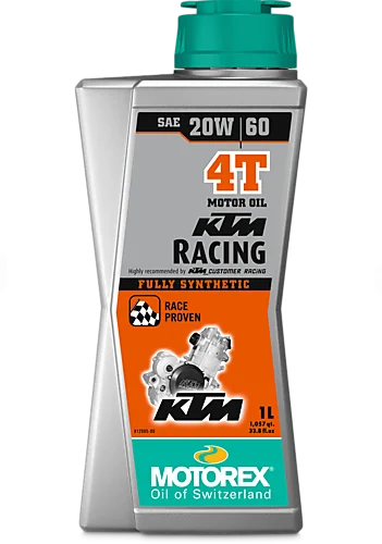

Around whether 15W40 is not good, I do wonder why Motorbikes run more viscous oils, so the oil flow paths is probably not the issue in our 3UR-FR. Now motorbikes are probably running this as a) they get thermally loaded higher so at operating conditions they need more to maintain oil film thickness and b) the trade off between cold start and operating conditions wear is in favor of the later.
All in all I would recommend going 5W30 or more expensive 0W30 or the 40 variant of either for lots of slow off roading at elevated temps. Maybe the OP should go 5W40 and satisfy his goal.
