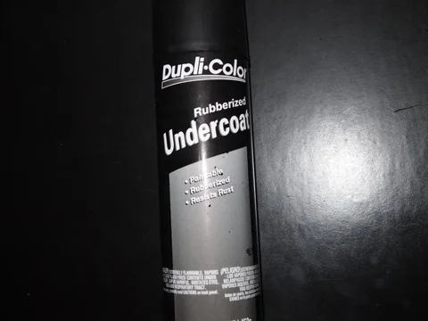

Dumb question, Any thoughts on product to recoat wheel wells?
Any spray can, that states undercoating will work fine. I just used this "Dupli-color Rubberized Undercoating" that I've had laying around for years.

I started my undercoating project a month or so ago, but it's not going to happen before winter.
Am probably going to go with Eastwood's product.
^That looks like good stuff, Smooth. I also keep a can of black spray paint around. If get around to it, I'm going to pick-up some fliud flim to get those tough to spot like bumper bolt & bracket areas.
