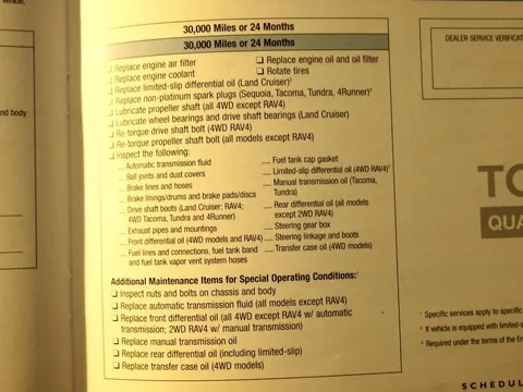

Yeah 30k is very quick. Most people do it at the same time as the 90k TB, if at all.
Yeah - everything I have looked at from Toyota says every 90k but I easily could have missed it.
I've had it done by a Toyota dealer twice now (every 90k) but I guess I need to find another way this third time.
I'm looking at a Toyota 2001 Scheduled Maintenance Guide that I purchased along with FSM from my local dealer in 2004. It states at 30,000: Lubricate wheel BEARINGS and drive shaft bearings (Land Cruiser)
Most dealer do wheel bearings but either miss drive shaft bearing which is inside the spindle or use NGL #2 it calls for #1. Not to be confused with propeller shafts which have 6 or 7 grease serk points done at 5k miles.

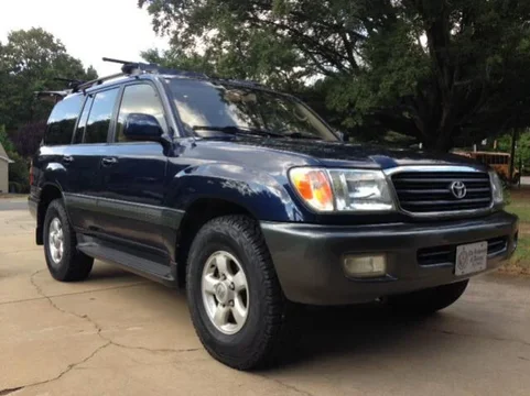

Just got the cruiser back from Scott Clark Toyota in Charlotte. Service from Justin was red carpet. 2k later, they: repacked front wheel bearings ,new brakes all 4 , new rear calipers , new 285 cooper ats-3 , f/r/c diff fluids , adj and lube propeller shaft , front right brake line , alignment , engine oil and filter , fuel system clean and TB , plugs , brake fluid checked good! , coolant flush , power steering fluid checked good! , looks like hoses addressed by PO
Mechanic/Tech said truck was solid as a rock, needed nothing else, everything perfect. Worked out the lockers, everything looked good. Feels tight and new! Thanks for the help and advice. If you are in Charlotte and looking for a good shop, this stealership is worth the trip. Called me every step of the way, sent me text pics on items of concern, great prices on tires and service items. Went through the truck with fine tooth comb. image-4189773597.webp
