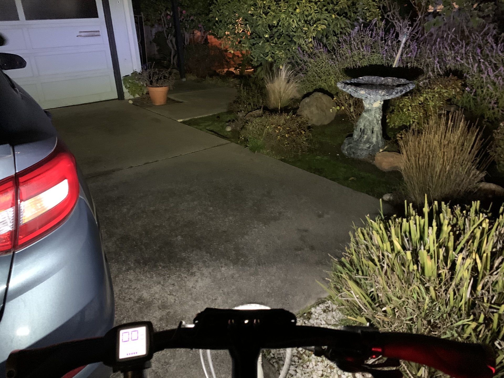

Yes. No issues. I actually just bought another set of these yesterday to install as work lights. And used another one as my e bike headlight.

This is the larger 10 Led version, on the bike. This are is normally pitch black. Running off the internal bike battery. It pumps a lot of light for a slim design. Best bike light I’ve ever used, should be a great work light on the side of the roof rack.
