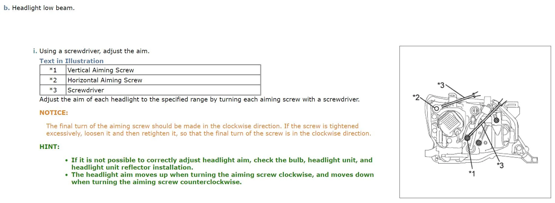

How did you adjust the level on your headlights when they are self leveling?
There are adjustment screws to set the effective zero point that they then “self level” from. They aren’t smart enough to know true level and get feedback about whether they are approaching that.. they just lean on AHC to keep the truck level and give feedback to further adjust headlights when it’s not via the suspension position sensors.
It's pretty simple, but on the LX you have to remove the two side engine compartment covers.
