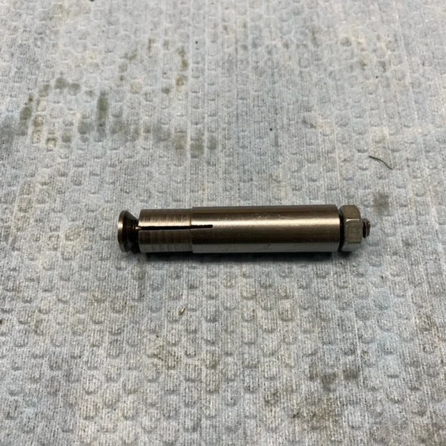

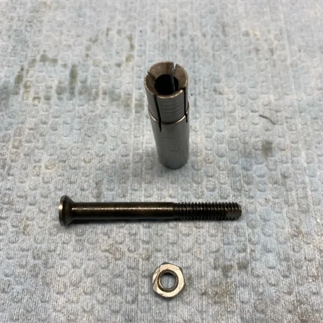

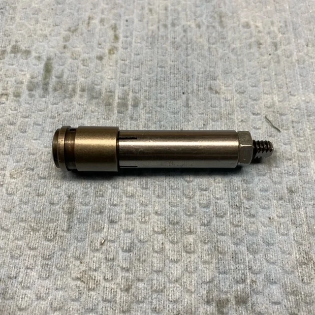

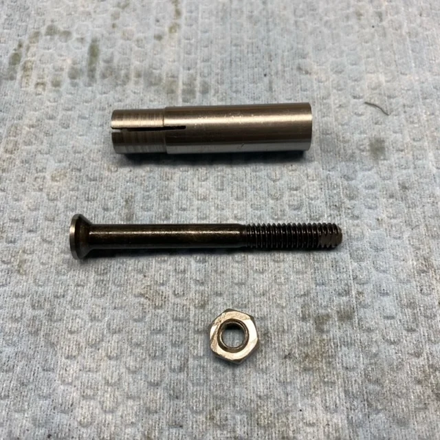

Thought you guys may be interested in what I came up with.
I've been dealing with high oil pressure and I changed my valve assembly out to new.
As you may be aware, the valve is a little tricky to get out.
Some people say to remove the spring, put the cap back on and blip the starter but that can make a mess and doesn't necessarily push the valve out.
Some other people use a rubber hose or a plastic handle.
I figured I'd make something dedicated.
1/2" DOM 1/8th wall, 2" long
1/4" x 20 chamfered bolt 2 5/8" long.
Hope this helps someone out!
Some of my friends thought it was cool idea so I offered to make them one as well.
Cheers
Mike
