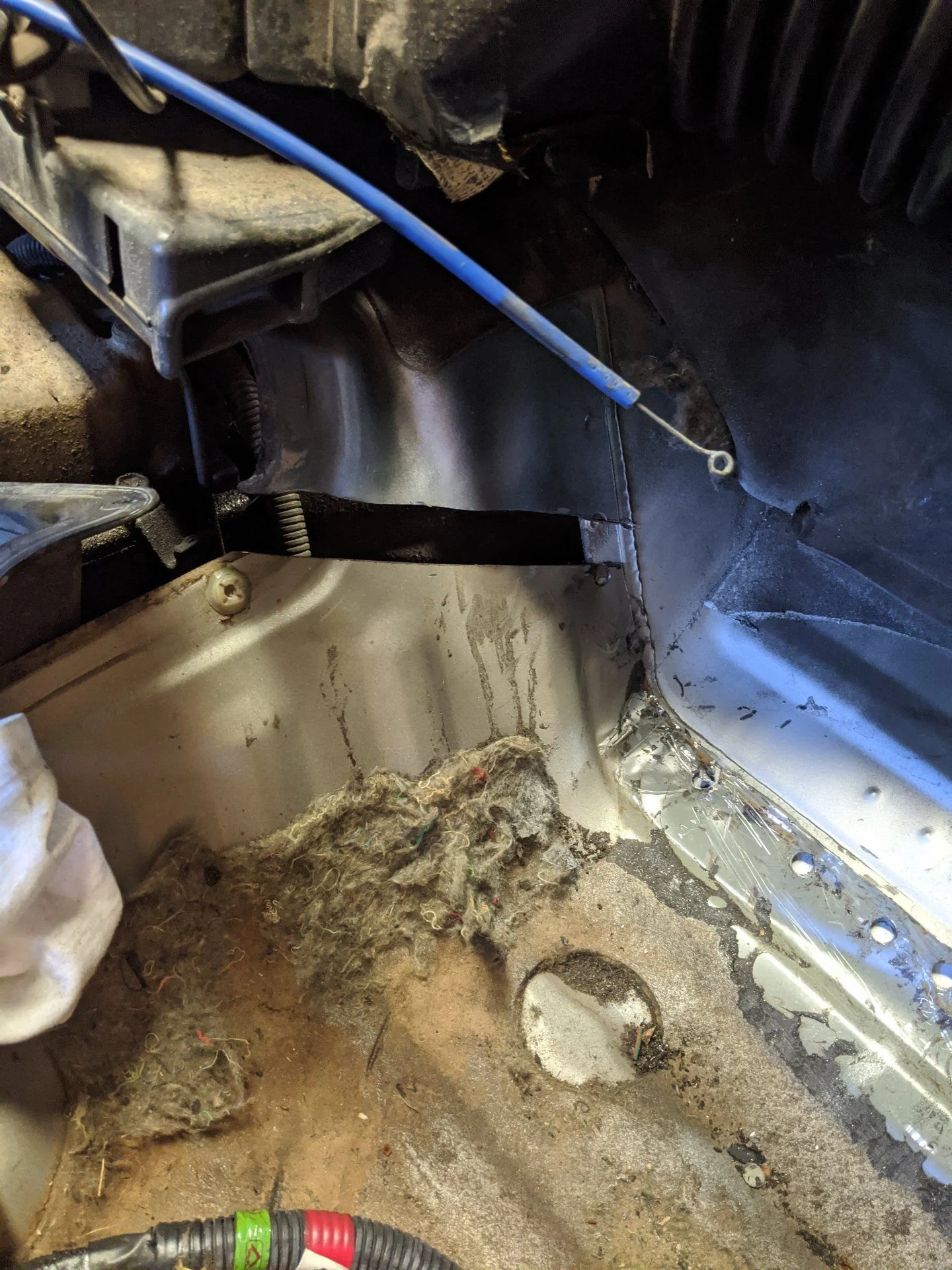

Yeah, I re-routed the fuel door lever to mid-console area. Seemed to work. My BJ60 didn't have that option so with the 61 body I had the option so I made it work. My hood release was already on the correct side. You'll need to be more creative than I needed to be I presume because you're actually swapping the drive side, where I was just swapping the body.
Electric mirrors apparently need to be whichever-hand-drive specific as their natural resting place is messed up if it's backwards.
I was thinking that. Now that I have it out of the way there's a fair bit of slack.

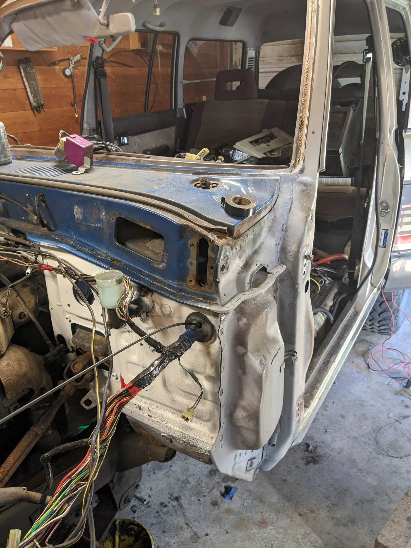

Time for some more cutting...
uxG_fznJGjndVlg1avuc3dzocW54OqXAEHGU1fDUlfUyg6PVZwMmaIOgKW3mHqr9pgNMy24huVK3x303vRhr4jszlNm0tWOwkPSwc2bVDrcSYlHBMbZWg_77NS_w-d54YGMhIJTswGQR0hihxLuz9T63PCY90CELOb_UFzJS2KfeJZ868jz8_IecjD-h7-imPcZGxf0STPNVvzVSWt2eNvjTllJh3rt9VmQNY-BjxfcxrAZaRx0OTExwrA4uLsd0eb9w6v3Le9ZFNpCwGNGloW4jvs7-S-gRlNu3RO_DY86XSDhTYJ8K3GraBky1PlhVL3wnkN253kTnWO_amyHRWBELGkEiksQY_jIB1Wr5Mw5_AbnEK5YZRKDZQykGW0bOl46sOR2MJqs81lNovvwDIy2O6JN93H-jtb-WQW9fvd9vkuFWWWmHdNPv7k8uAYJgJzDOl9iJizozqn1YK-g8x5K_6vmMjvmXac9FV1rdi8Pch-csR2D_01hdCL4SBkaKmjLLecwTfGPsH7ymlfC2rHq-0-rm-eNfDUUE4dyRarBcbXHFZccgeWHPji0GzNzM60tccpAO7ChyKfLUh9IN8fJLBiIyGZ9A8uHem1teLdtV97sFJAjTSWcWjJIEStPLQUAaaZgx5BgWJEP98eoaNOVMXj5DT-xuumvadkdAJtjVld_YYIYRZsF5YlgvfQ=w834-h625-no
I didn't really need to take it so far apart, but I wanted to harvest all the nuts and bolts etc.

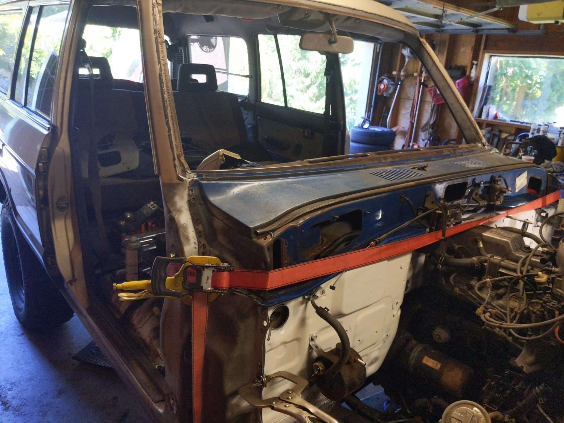

Back to cruiserland...
It's not RHD anymore. Course, it ain't exactly LHD either. :lol:

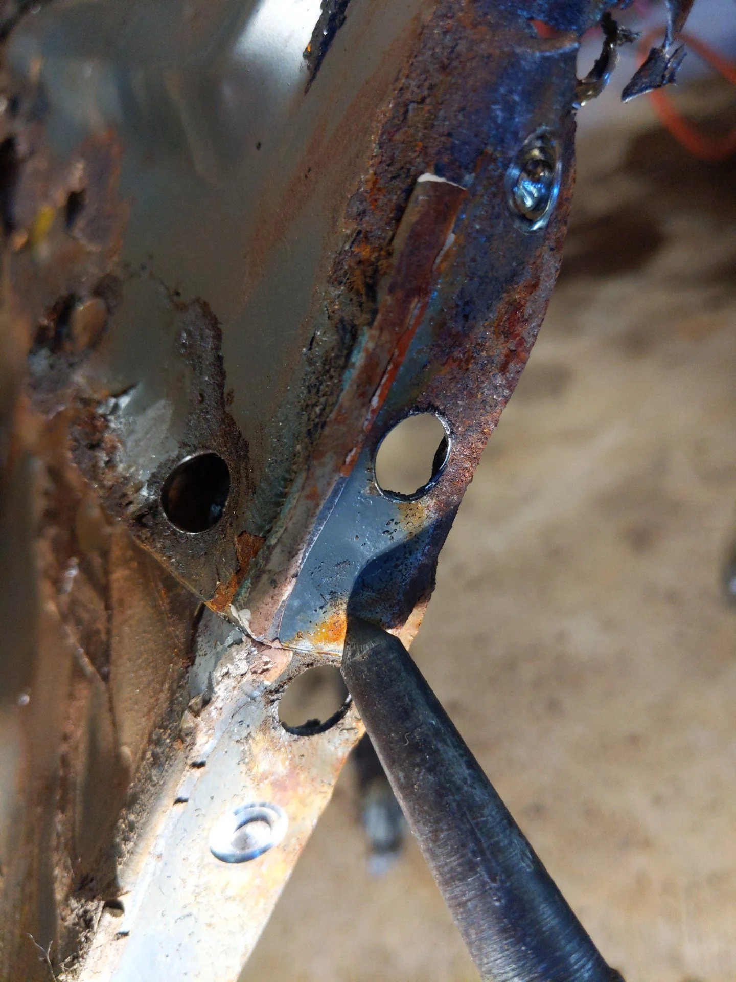

Ended up drilling the spots and taking the mounts. I had a spot of rust in the same spot as the blue truck, so I wasn't gaining anything by doing a cut and weld.
Now to make the blue one match and strip the harness out of it.

Just so there's a picture. This spotweld is hidden. That's the floor pan seam at outer edge.
Pretty much have to chisel it...assholes.
And wtf Mr Toyota?

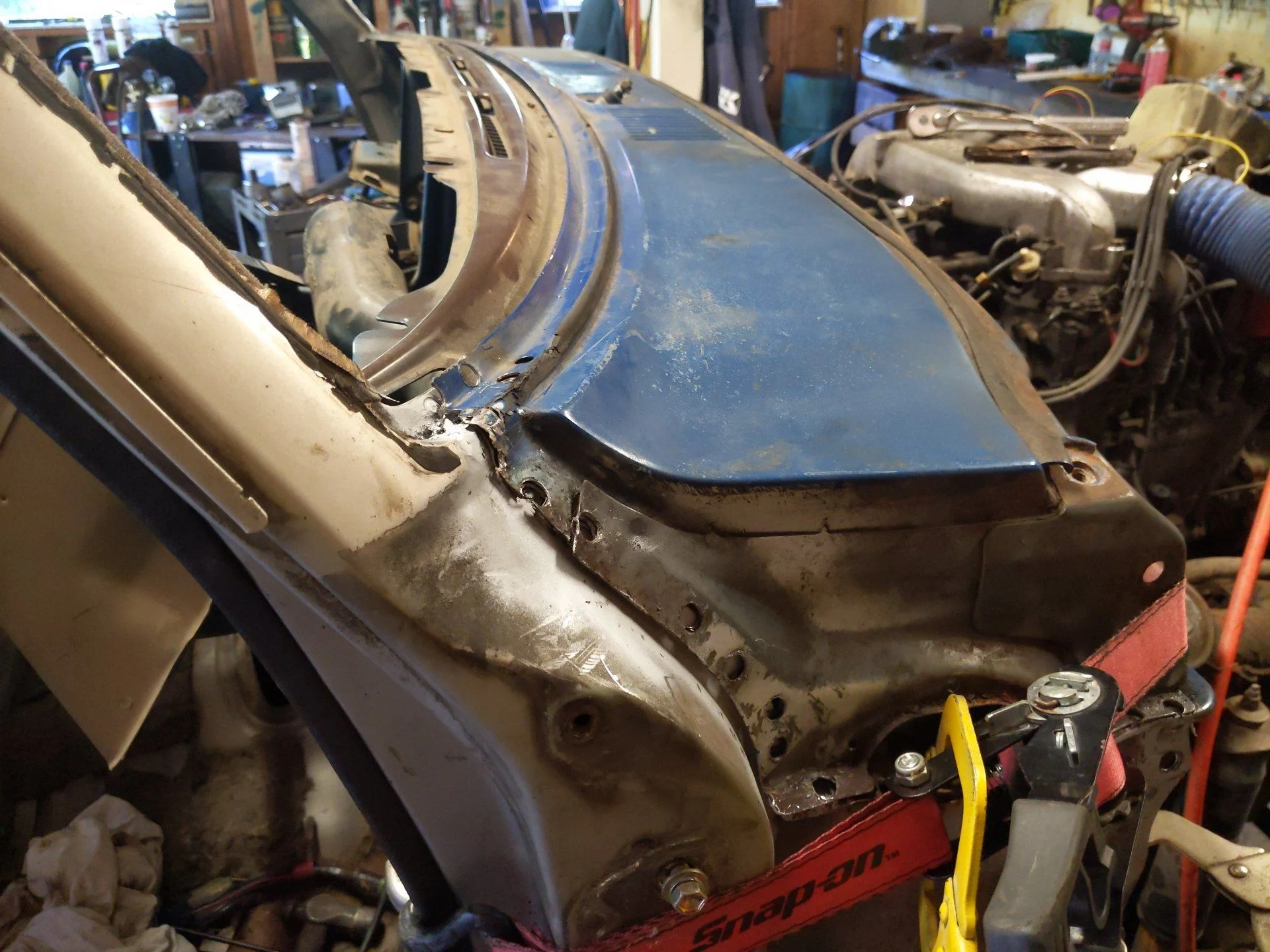

Never did that with the engine in before, was it much more of a chore? Wires for the sunroof and pod on the interior will be your only circuit to add onto the wiring harness maybe strip that section out of the harness. Looking good, big job.
Actually not too bad. It's not in the way of any drilling, just very close when you have to push the bottom forward to get it out from under the floor pan.
If I did this again i wouldn't take out engine.
Taking the body the rest of the way off would be easier I think...

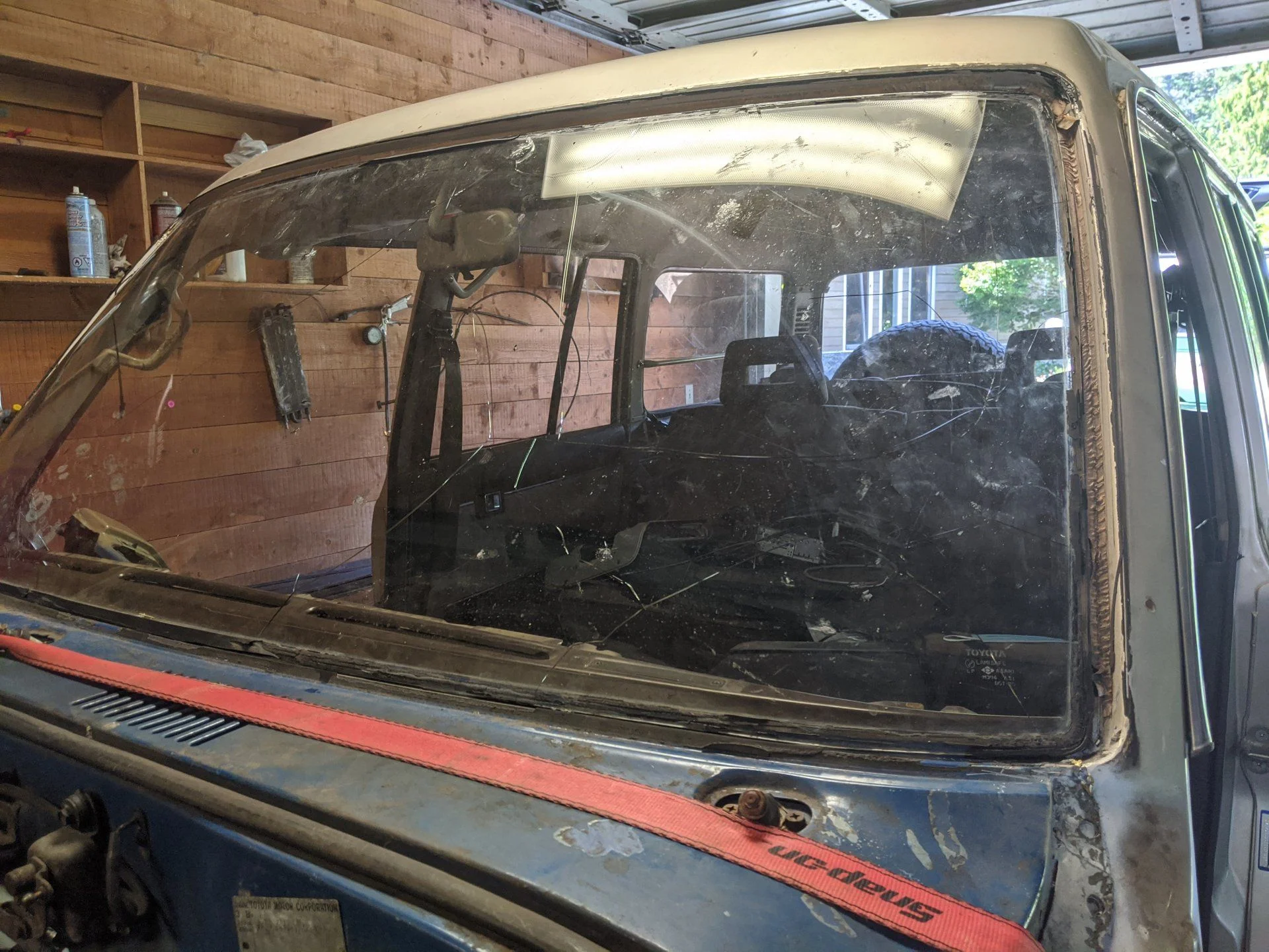

@PeeZed got me paranoid about the glass fitting so I stuck the vintage glass in for a test. Seems ok. About a seals width and parallel gaps.
One of these time it's gonna explode when I pick it up :lol:

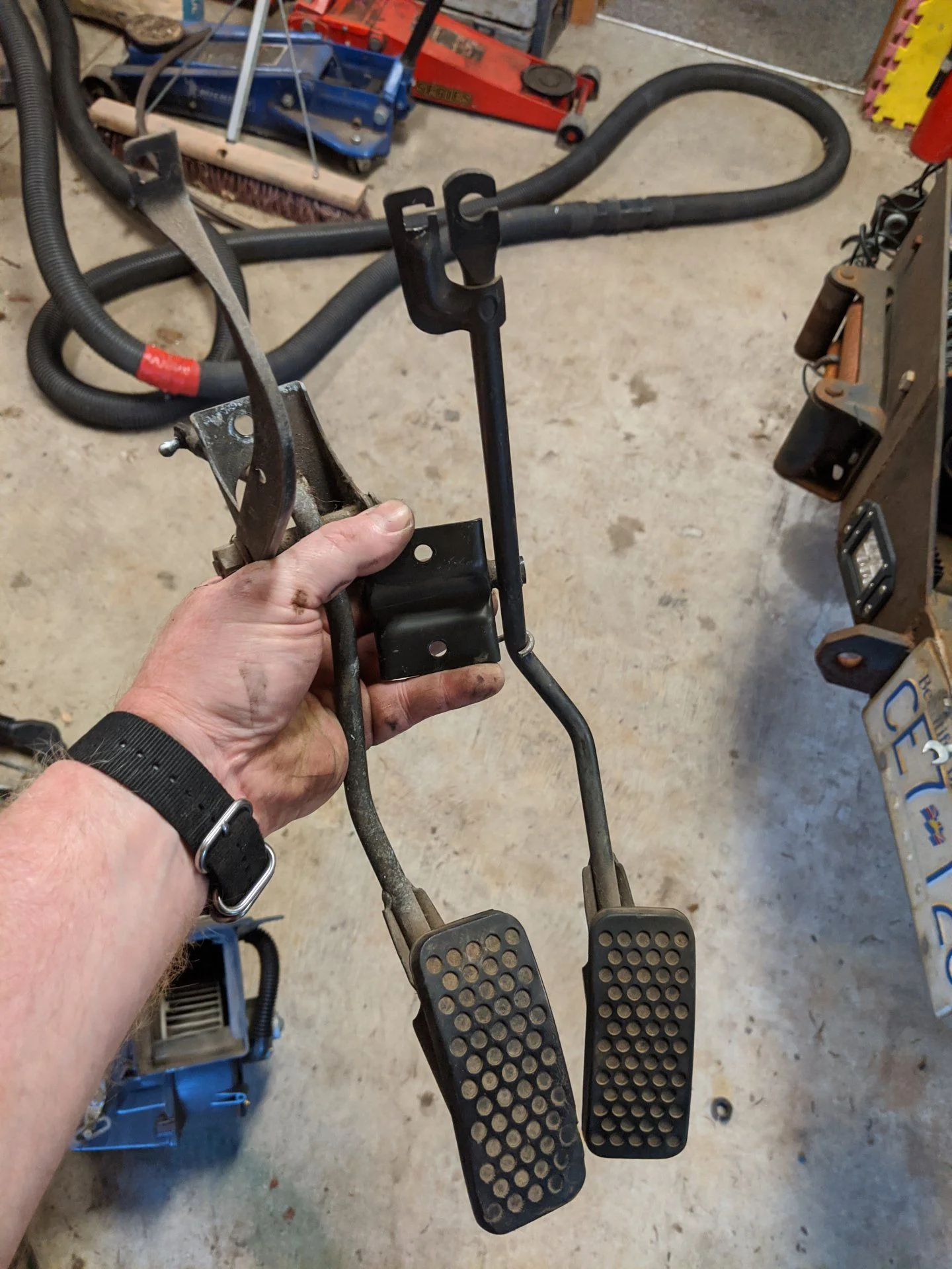

Throttle setup is pretty different from 3b to 12ht, so some mixing and matching of gas pedal parts. Still no there yet. More bending...
