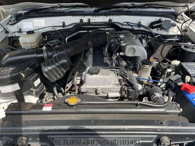

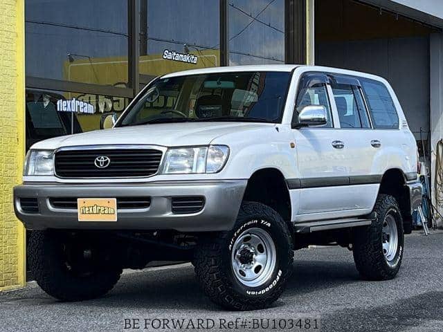

I was browsing JDMs for sale (for fun) and saw this, looks like 105 but looks like it has the 4500cc engine, lockers and manual :cool:
