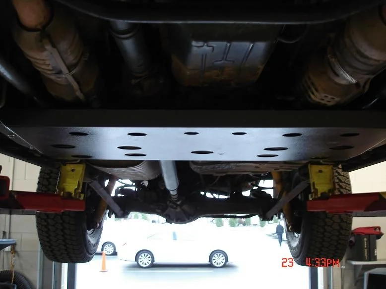

In an effort to add more tech to this tread. Here is a picture of my factory front skidplate and Slee ('cause they can always use another plug) belly pan. I believe the factory front skid plate is enough for any of the trails in Moab. I like the added protection of the belly pan but didn't feel the extra pieces of metal were necessary for the trails I run.:cheers:
The belly plate is the one that has taken all of my underbody shots so far.

Why not add the middle plate? Can't remember what is there but seem to recall something important like the transfer case.
T-case is protected by the belly plate. Middle plate only covers the front driveshaft t-bars and they are protected by the diff drop and the frame rails. I just can't see jamming a pointy rock up in there in just the right way as to do any damage. I have removed the cardboard piece that was installed from the factory. I also saw no need for a stronger front skid either. I try to put my wheels on the pointy parts. I worry more about the rear driveshaft and rear diff as they are closer to the ground than anything toward the front of the truck. I have bent 2 rear driveshafts. I just don't see the need for the extra weight.
Everybody plays poker differently. I haven't been to Moab, but I wouldn't cut corners with a $215 pc of protection.
