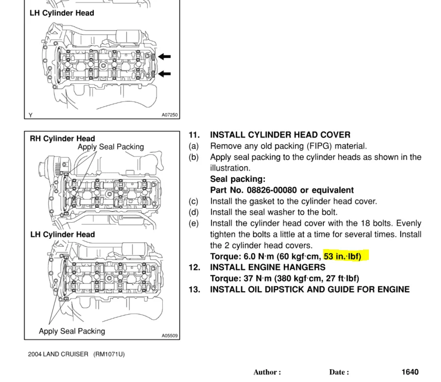

Actually, my question is I already torqued them to 56inlb yesterday (I drove 20 mils today no leaking so far), could I retorque them to 75inlb to prevent leaking? or this retorque could be a bad idea which will cause some leaking? (because FIPG already dried) what do you suggest to do?
53 in-lb is FSM spec. No need to tighten more than that. Over-torquing could snap the bolts, that would be bad. Toyota Engineers are pretty smart as well...
I'm not a Toyota technician, but I would go to the FSM spec and leave them. After a few months of driving, I would check them at the factory torque spec setting again.
The cover is held on by bolts with rubber crush washers to try to alleviate the over-torque scenario you are describing and all you would be doing is crushing those rubber washers further, (which is very common).
