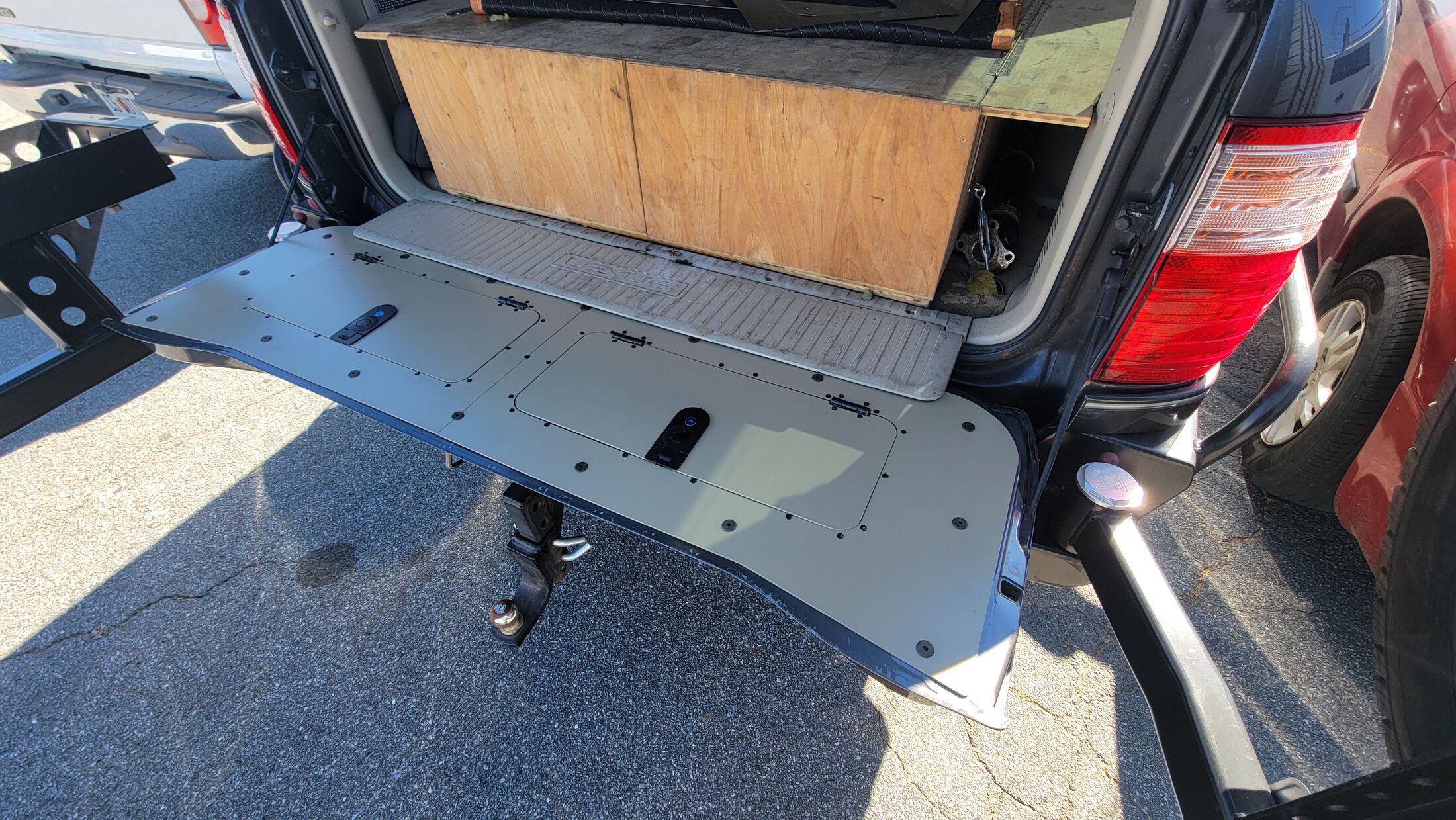

Mine will come in 12ga steel, unfinished. Will include latches, tension hinges, and hardware to bolt it all together. I'm eyeing $275 for the kit, not entirely positive about shipping yet but all-in it'll undercut any other kit out there.

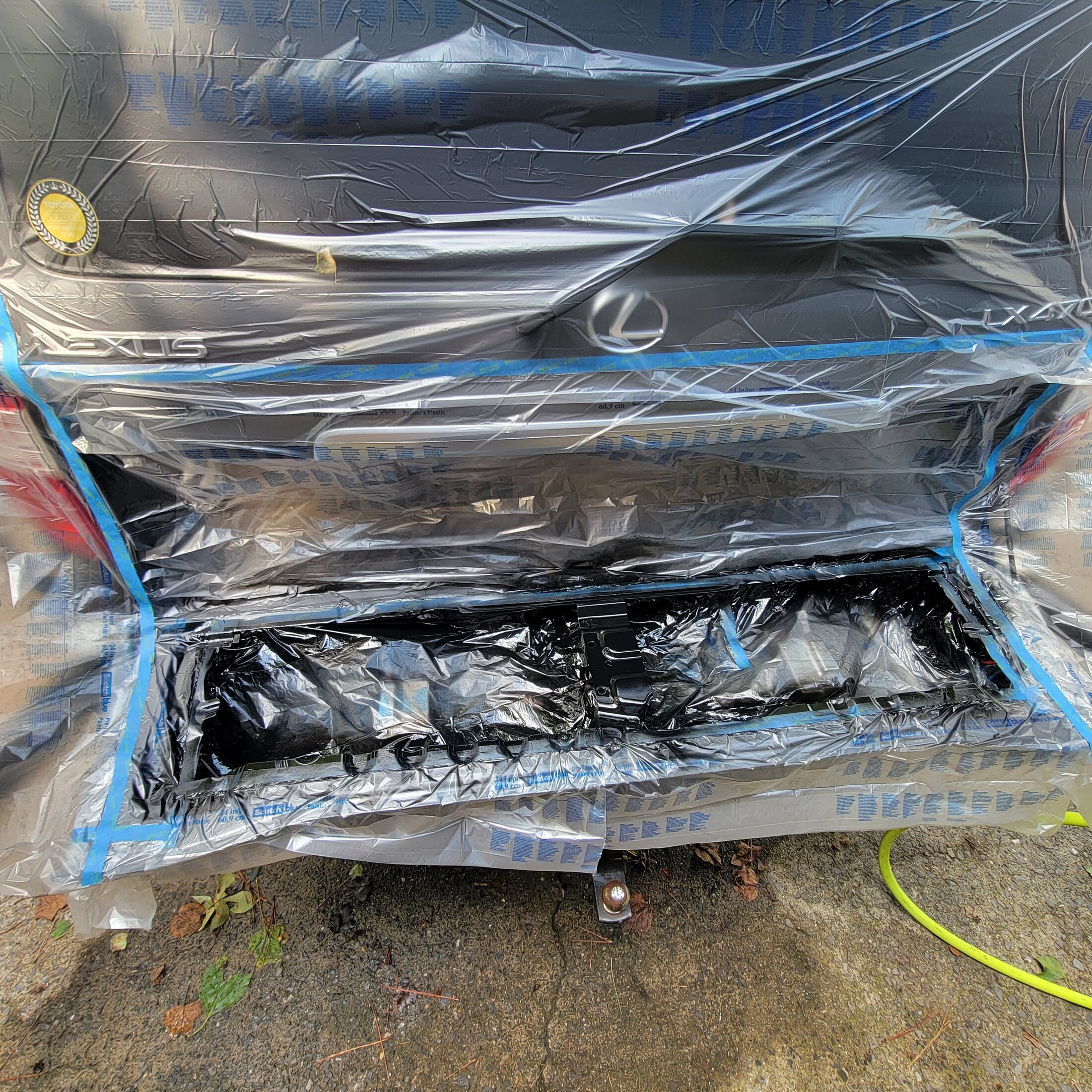

I have just a few pictures of the initial install process. The kit will not come with a liner but I would recommend it. I added my own triple layer sound deadener inside the cavity. Eventually I may include a sheet of sound mat in the kit but not at this time. I will take more pics when I get back stateside next week. In the interim:

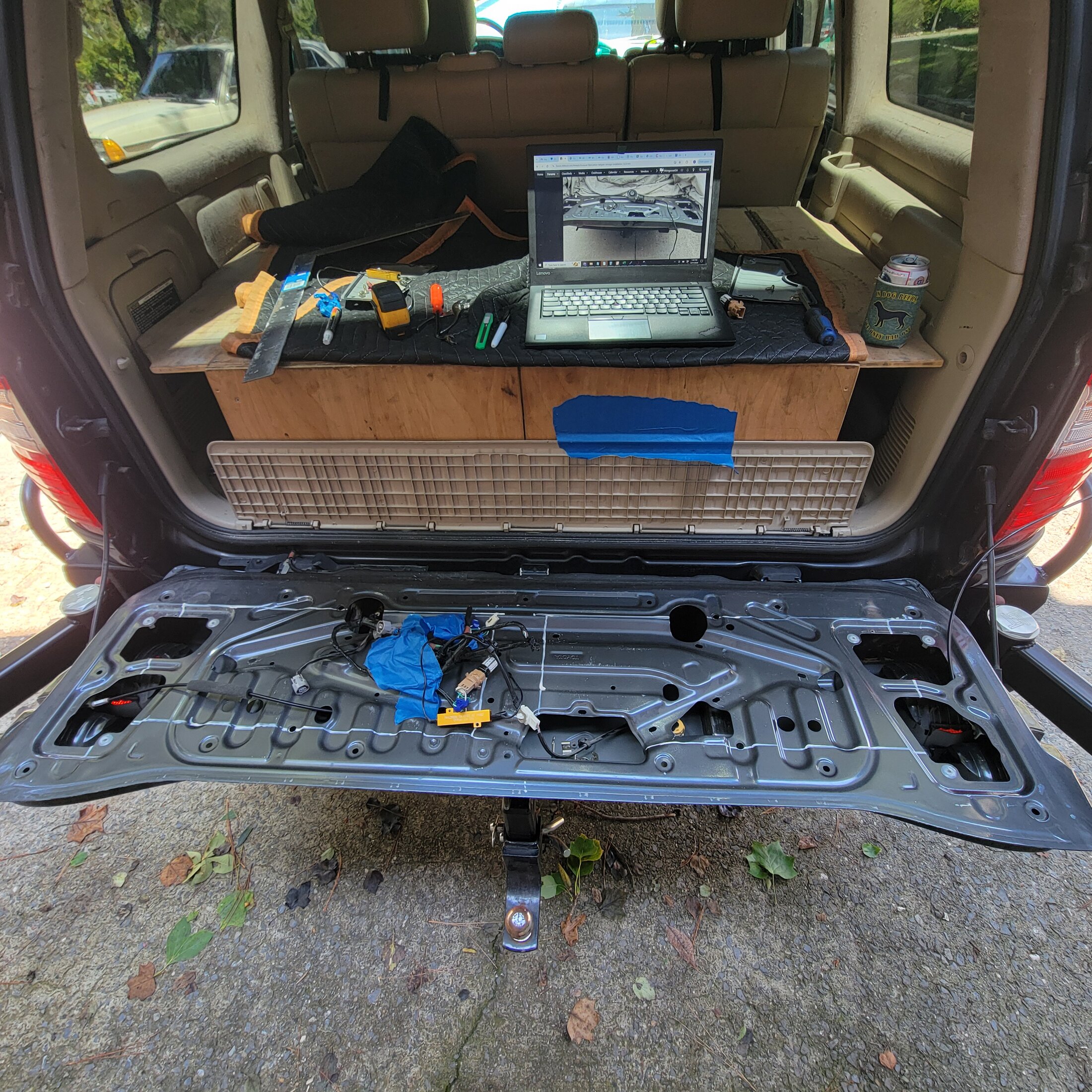

I've also been dabbling in a little project. I've resisted doing tailgate storage because I went to close a buddy's tailgate once, and the damn thing was 100lbs of damn near impossible. I figured my Ms would never be able to get in and out of the tailgate. But @LJE inspired me with his soft-close addition, so I stole his idea and ordered a pair of struts for the tailgate. This enabled me to finally let me freak flag fly and chop up my tailgate.
Since I'm doing this myself, I had no template to use as if I'd ordered the Huracan kit. So, I just copied photos from install DIYs. @Wermz came by because it seems like I never cut any sheet metal without him around. Thanks, buddy.

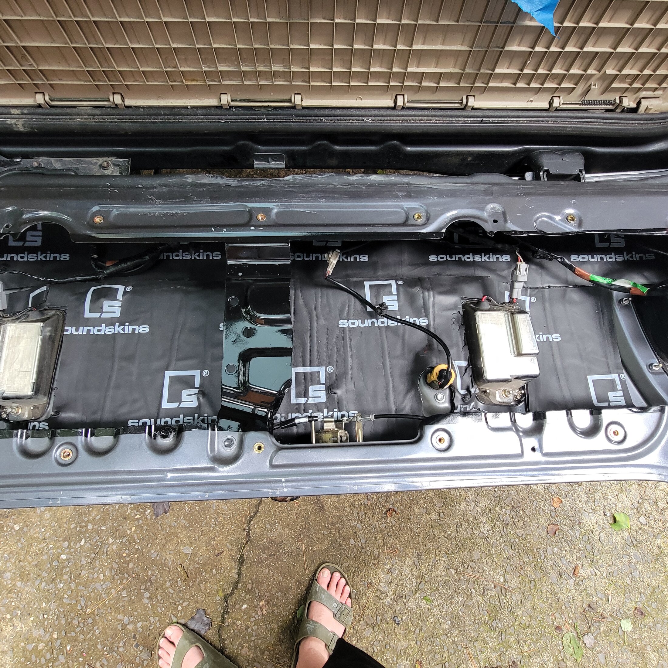

And then I sound deadened the entire cavity. While in here, I had to rig a solution for a broken plastic holder for one of the rear latch cables, and I (actually Ryan) fixed the horrible rattle that my reverse light panel has been making forever. Now I get a nice solid "thnk" when I close the tailgate and hatch, with no backtalk.
The hinges gave me a hell of a time in prototyping. I wanted to mount them completely underneath the panels, but couldn't find a worthwhile hinge that wasn't cost prohibitive. Ultimately I ended up having the hinge mount beneath the panel, but the barrel of the hinge does sit proud of the steel. Interestingly enough, the plastic gap filler flap pops up over the hinges, but the latches are actually the catch. I'm going to be including a soft foam type material to place under the flap so that it will be elevated just enough to clear everything. I am also very open to other design ideas to further improve the product. I'm neither a designer or an engineer, I just want to make good use of my plasma CNC table.
