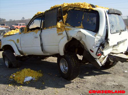

This 80 got pinned between two semis http://www.gotcruiser.com/80srock/80srock.htm#80
I agree, pman. The Tundra frames are absolute jokes. It will be interesting to see what the third generation offers as it's due for an update soon. Yes, Denso makes EVERYTHING from the ignition system to the AC fan. The use of a single manufacturer for something like this must improve reliability, from a manufacturing standpoint before they're even put in the car.
what is all over the 80?
