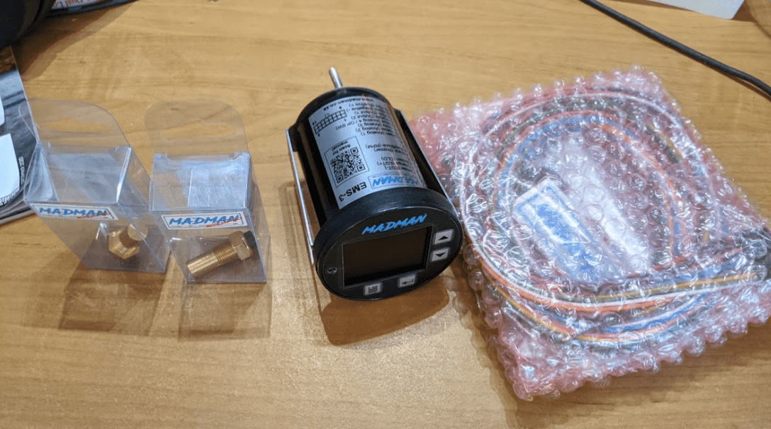

I'm looking at the same Madman guage, let us all know what you think of it!
Madman gauge is pretty great. Its replaced my egt and oil pressure gauges, plus added a lot more. It comes with an alarm already attached to the harness, and its loud enough to get your attention, and annoy the hell out of the wife. Coolant level detection is pretty neat, it uses two stainless screws put in to the side of the reservoir (or radiator end caps if you want to drill in to them) and reads continuity of fluid between them. Display is nice and bright, and I have no trouble seeing it in full sunlight. The gauge also has a light sensor that dims the gauge in low light situations. Convenient because you don't have to wire it to a headlight circuit. You can dedicate the gauge to one readout, which I usually have set to EGT if Im going over the mountains. If another sensor triggers an alarm it will still alert you to it and switch over to that readout. Its designed to work with a bunch of different sender models, so theres a lot more fiddling involved than with your normal gauge kit to get it set up correctly. Overall I think this could save me from a catastrophic failure, and given the number of gauges it replicates is a steal price wise.
There are a few issues, though.
1. I saw the oil pressure glitch out and read very low and trigger an alarm. I didn't use a Madman supplied sensor, so this could be the issue. Its only happened once so far. It worked fine with on my old gauge.
2. Water temp intermittently reads very high. It could be because of my sensor position, which is at the high temp outlet between the engine and radiator. But it gets close to the 150c sensor max in certain scenarios. I just bumped up the alarm setting.:flush:
3. Egt update frequency seems slower than the Auber gauge it replaced.
