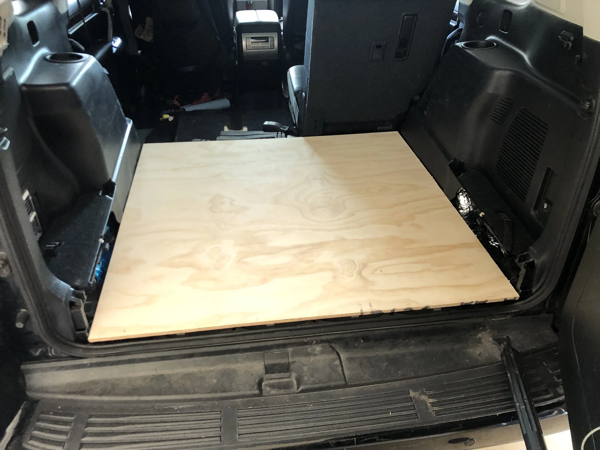

Building a rear seat delete platform. Im prototyping with cheap plywood but plan on finishing with baltic birch.
Does anyone know what the manufacturers are using (i.e. goose gear/ adgu)? Three-quarter seems like overkill but half inches a little thin unless braced properly.

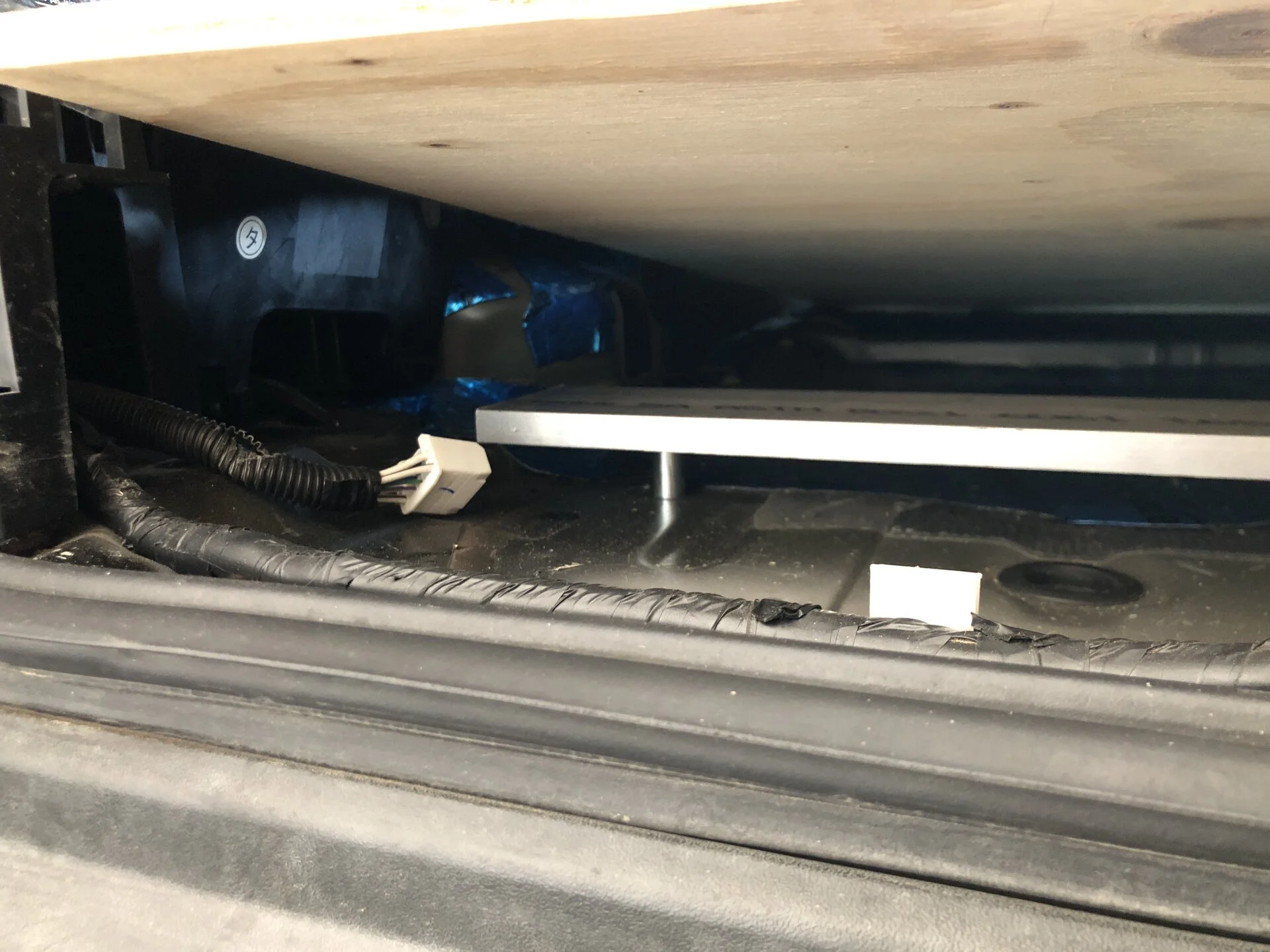

1/2” with support should be fine. I’m going to use 1/4” aluminum as that’s what I have laying around, with some support so it doesn’t flex. I plan on moving the key sensor and the wires that run along the edge to get a little closer to body level.

Building my own unless a great one exists. My plan is to build the platform and make a video and post .ai or .dxw files for my design. Got any good designs I can refer to? Aluminum deck sounds good if you can brace it well. I looked into HDPE and it's not that cost effective or much better than baltic birch with a coat of bedliner.
There are things I like and don't like about Goose gear and Air Down gear up which are the two I've researched most. The Goose gear design would be super easy to knock off but it's weak with minimal metal. Air Down gear up has the right idea with the aluminum bar but I hate idea of sliding boxes over that huge slab if I don't have drawers in.
I'm going to try to combine the best of both in my design by putting the flat bar underneath.
Prototyping with a piece of mid-grade plywood (42.125x41.5" covers from the sill to the back of the seats) . I just reused the factory covers that go behind the wheel wells for now and I think I'll put a power panel in there for my fridge on the L side. Probably just cover the gaps with ply like Goose gear. Going to use @THEOZMAN 's 3rd seat harness for the fridge/usb panel.
