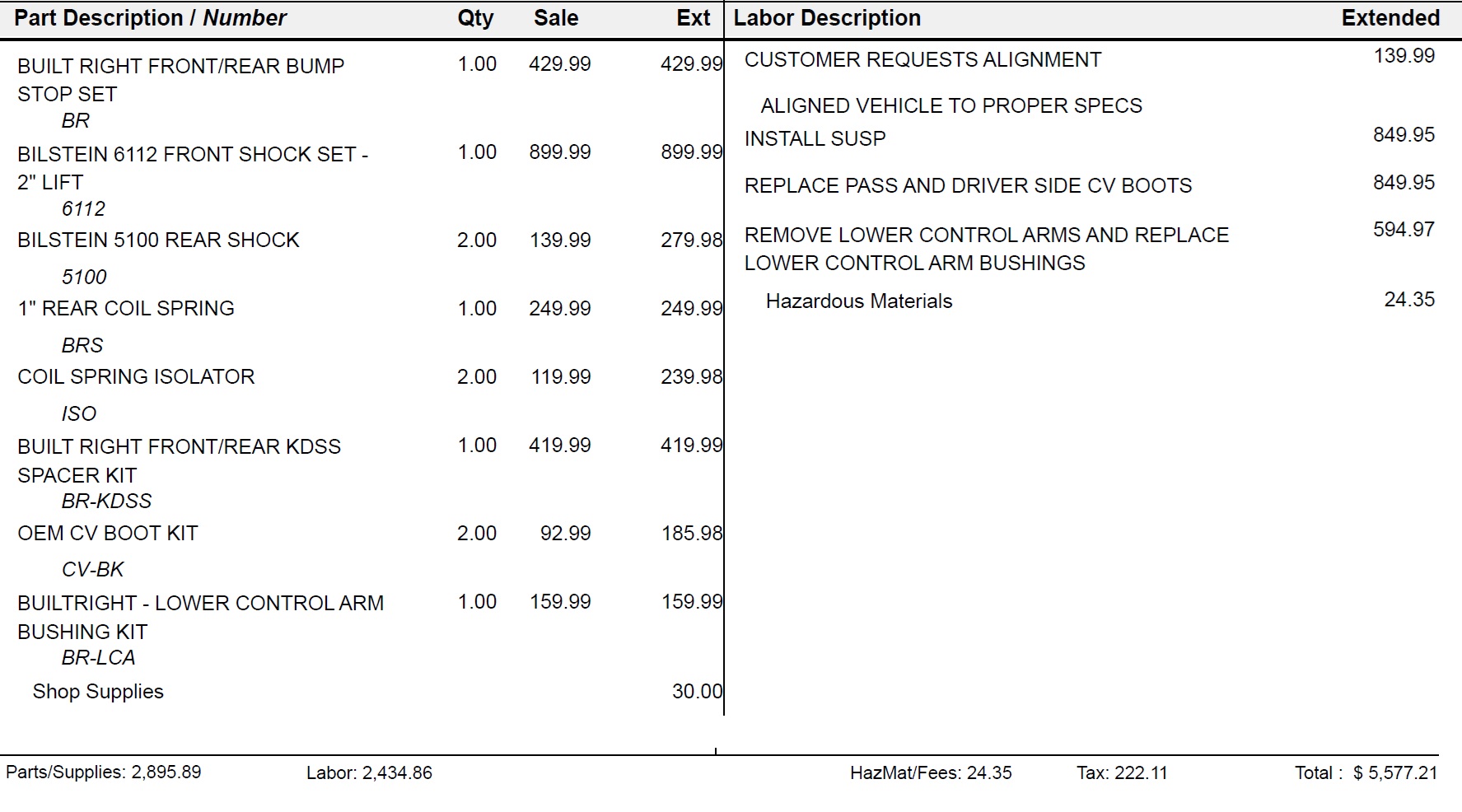

The shop recommended a Bilstein 6112 front/5110 rear shock lift (2" front, 1" rear), with an airbag delete.
I've attached their quote.
It seems like a solid lift kit, but I'm wondering if it's worth just getting the 6112 on the front to replace the leaking shocks, and to continue using the rear airbag suspension for a while. I'd be doing this for the point of saving money (upfront at least), and getting to know the car and what I want to do with it better.
Is this likely to cause some asymmetric behavior or premature wear and tear? I also imagine it might affect the rake and I'd have to lift the rear all the time?
Just wanted to get some opinions from the experienced folks here before I pull the trigger.

P.S. Purely out of ignorance of not being familiar with lift kits, what do the bump stop replacements and KDSS spacers accomplish in the below quote?
6112 are Monotube digressive valved shocks. The OEM are low pressure twin tube design. They would have very different damping characteristic. It would induce some weird handling characteristics.
I do like 6112 but they do not 2.5" diameter rear shocks. The 5116 they recommend have pretty high failure rate on this platform for some reason.
Dobinson IMS are only 50 mm piston for this platform.
Ironman is coming with new Monotube with 57mm piston. No reviews yet. I only know @GXO is working to get the first prototype for GX460 fitted this week.
OME MT64 seems to be a bit more expensive and probably geared for heavily loaded vehicle.
Apache off road AX2 are pretty affordable and they been getting good feedback. I would choose this over bilstein 5100.
To me Bilstein 5100 is excellent choice only if paired with stock spring and your vehicle is stock weight.

Also... Just saw they are replacing LCA bushings.... I would imagine it would be cheaper to just replace them since they just bolt on essentially? Or even upgrade them? I would definitely double check and look into this.
Just looked myself, Yeah you are about $800 deep in replacing parts on a LCA when you can get a new OEM one for about $250-$300 a side... That's about $500-$600 for brand new oem ones that have all new everything and something you could easily do yourself.... As well as if you want aftermarket options you could go with freedom off road I think they are like $360 a set, and moog $130 a side? Or some more expensive options dirtking, total chaos etc.
SuperPro LCAs are a middle ground that has gone through all the fancy Aussis engineering that folks over here don't have to do. I will probably need to get those, myself.
Yeah, the pre purchase inspection showed the bushings beginning to crack. The parts cost is fairly low, but the labor is a lot.
I had also considered whether it was worth just replacing the entire LCA.

Definitely would say it's worth getting new LCAs instead, since not only will it be cheaper, you will have new ball joint and bushings all in one for cheaper plus the LCA itself, since the LCA comes with everything.
