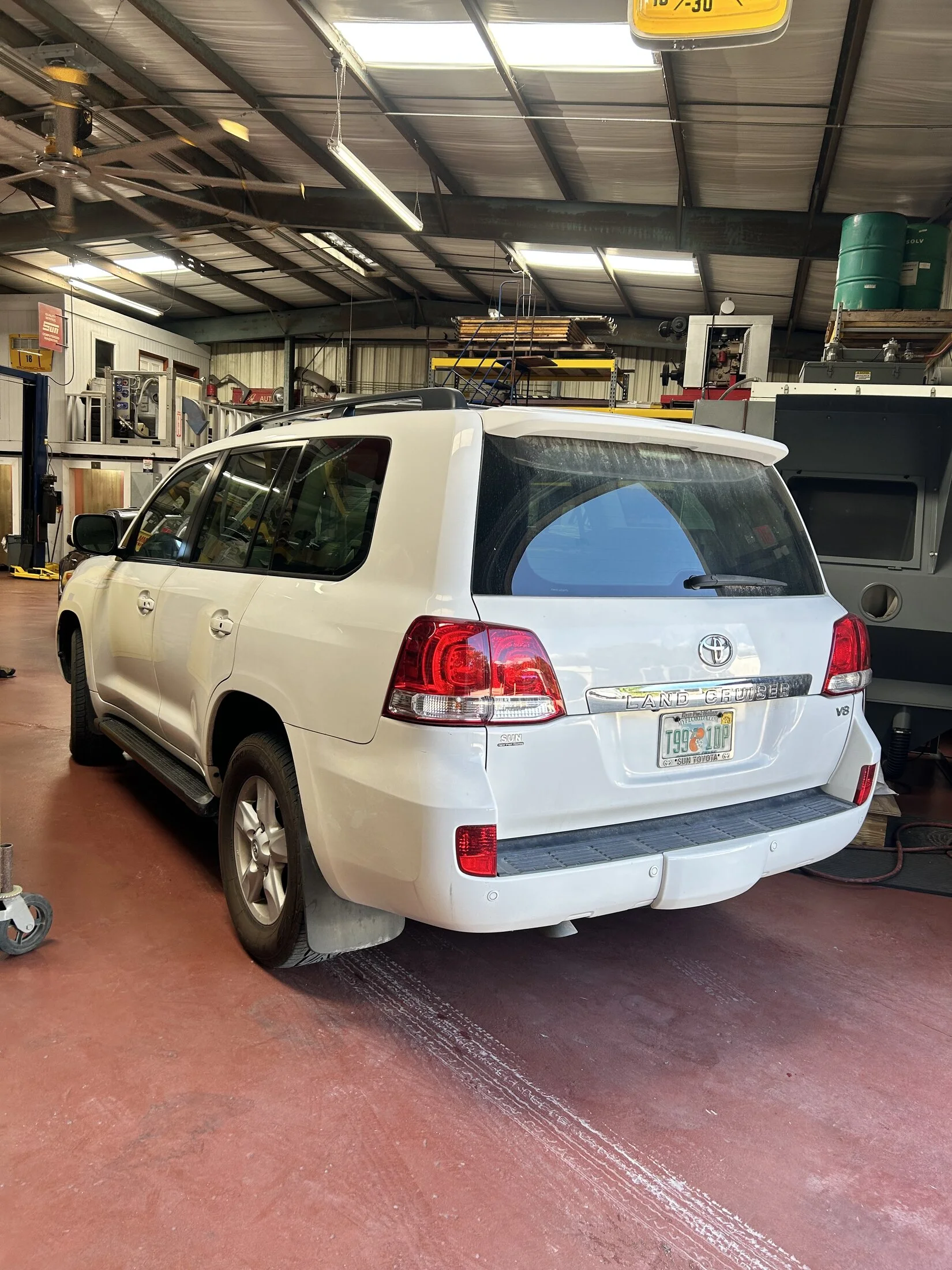

The truck was bought new in Florida and one owner. Never crashed and anything it ever needed it was given. Elderly grandfather started to slow down on washing it and that’s about it. Did an oil change on it today and found a few things. Fuel sending unit sticking from sitting so long empty. Some control arm bushings cracked . But, the drain plug was stripped coming out so oil change was done by a dummy and didn’t have a factory drain plug. Looks like a lower oil pan is in need. Pretty simple repair it appears. Airbag light on and my scan tool won’t access it. I’ll figure that out… I sold Snap on for 10 years so I have access to a tool.

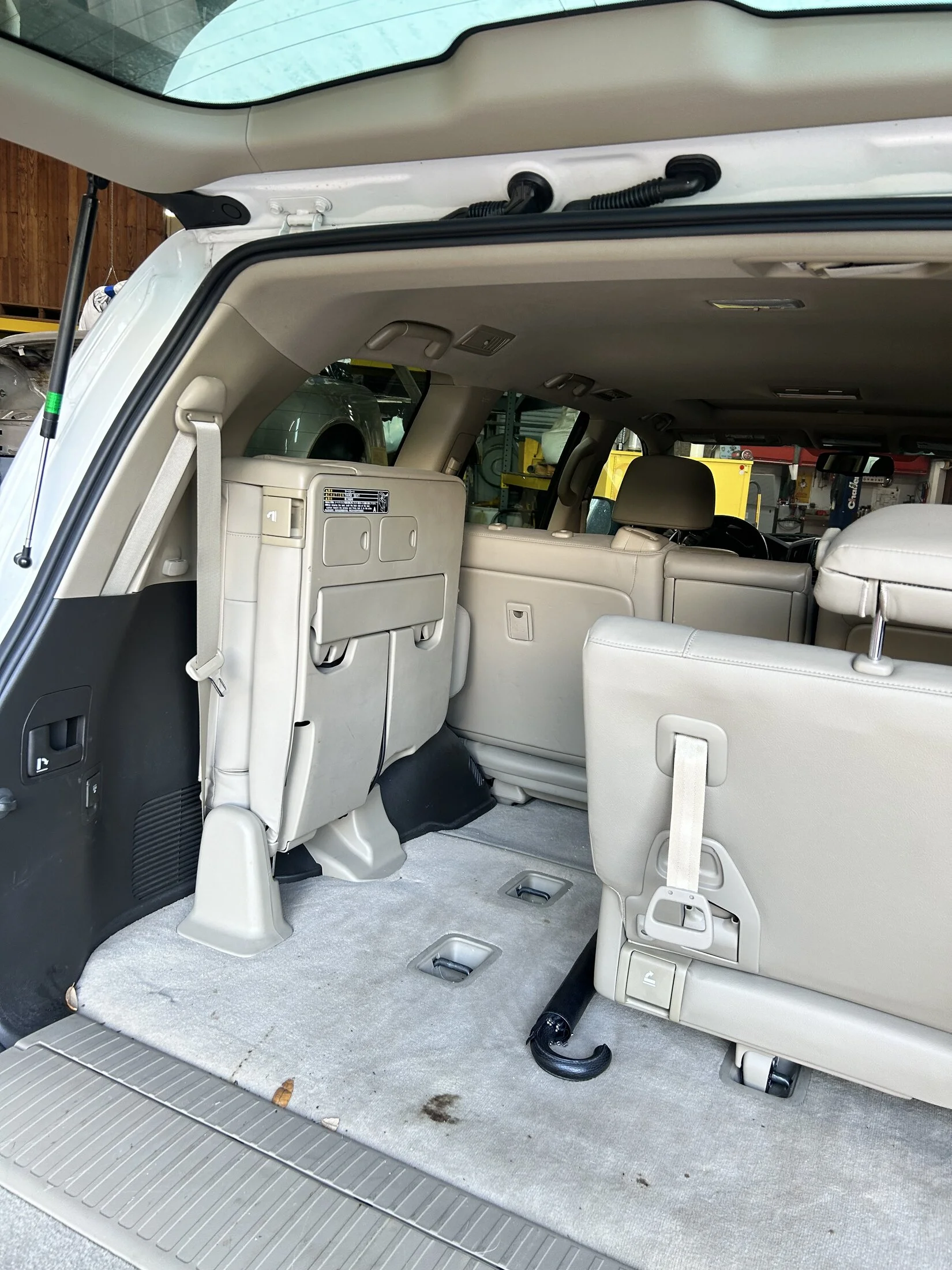

Zero rust visible anywhere on the truck and maybe not the most ideal interior / exterior colors but it is what it is… I’ll get through that checklist and check valley for any signs of leaks. Here it is. Oh back seats had humans on the maybe a handful of times. Rear jump seats probably never.

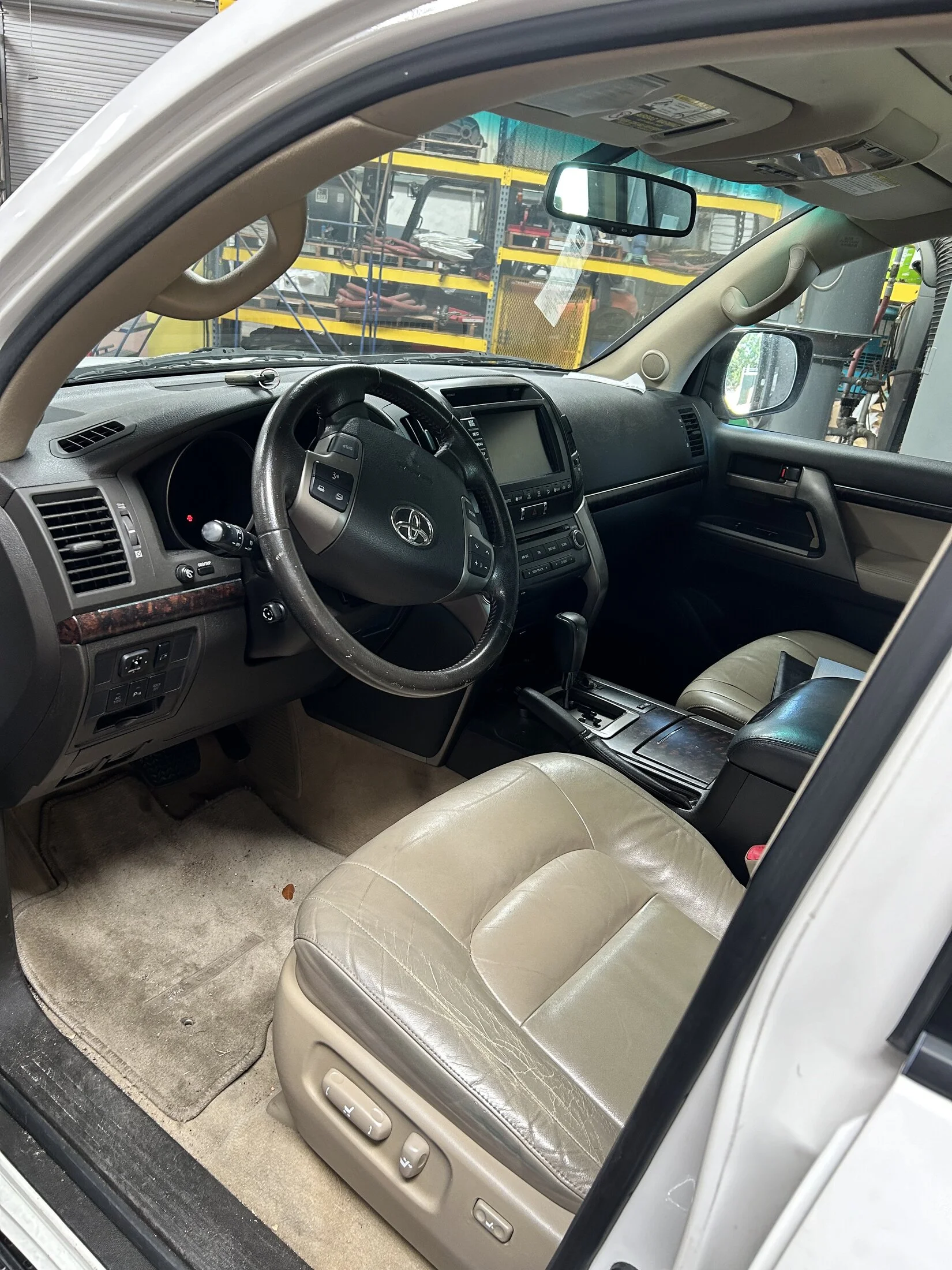

How did this Land Cruiser come with a fully leather wrapped wheel? I thought all of the US spec cruisers came with the fake wood wheel?
I see the leather wrapped wheel as a pro :)
Truck wasn’t spec’d with the upgrade package. Notice it doesn’t have the rear DVD player as well. The non-upgrade trucks got a full leather wheel and a shifter that lacked the faux wood grain insert as well.
Oh interesting - you learn something new every day.
