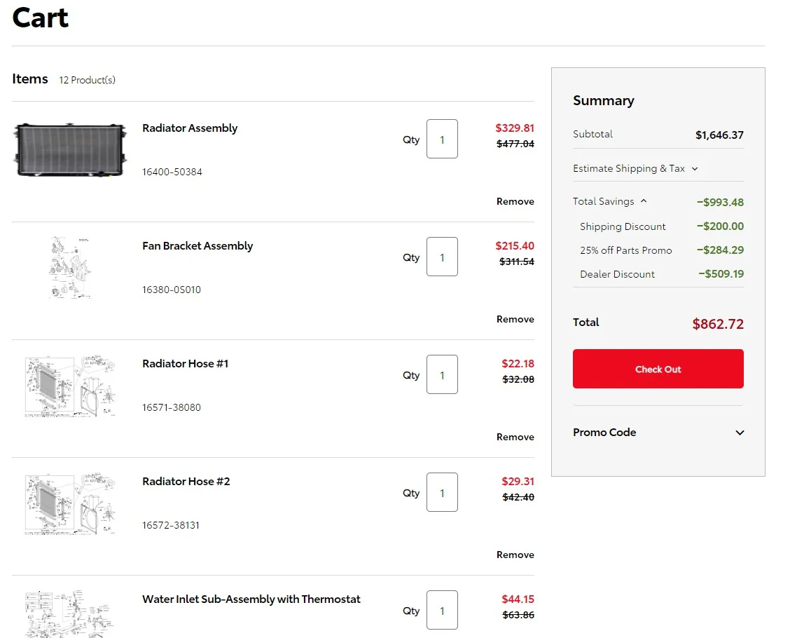

Thanks for the list! Just picked up a 87k mile 2013 LX that has the stress line across the front of the radiator flat spot. While I could put it off for awhile, I'll take advantage of the current 25% and grab the parts now.
