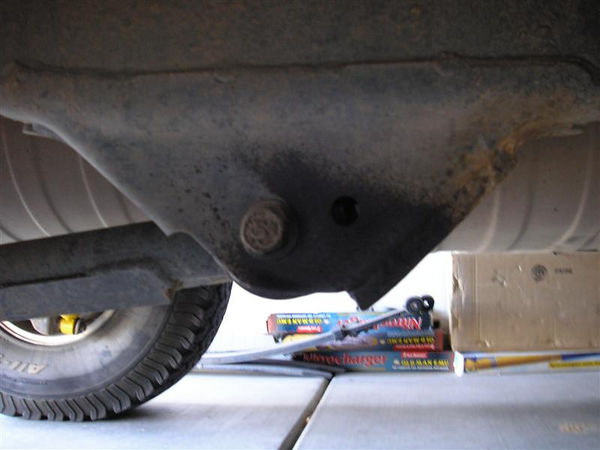

I also looked at that bracket and other than welding a ramp on, I don't really see any way of installing something. Also that bracket has a much better angle and does not hang down anywhere near as bad as the 96-02 4Runner link brackets. I think once people add a mild lift and some bigger tires, the mounts will no longer be an issue, but reguardless of height, you'll bend the stock .120 wall links.

Rubicon Express Super Flex Joint Link bolted in to a 2007 FJ Crusier frame bracket.
Lower Links.
Top is a 1998 Isuzu Rodeo
Middle is a 2007 FJ Crusier
Bottom is a 1996 4Runner
Since all of the custom parts are the same, I'll order up some 1 1/2", 1/4" wall DOM tomorrow, order some more RE SF ends and build up a set of FJC lower links.
