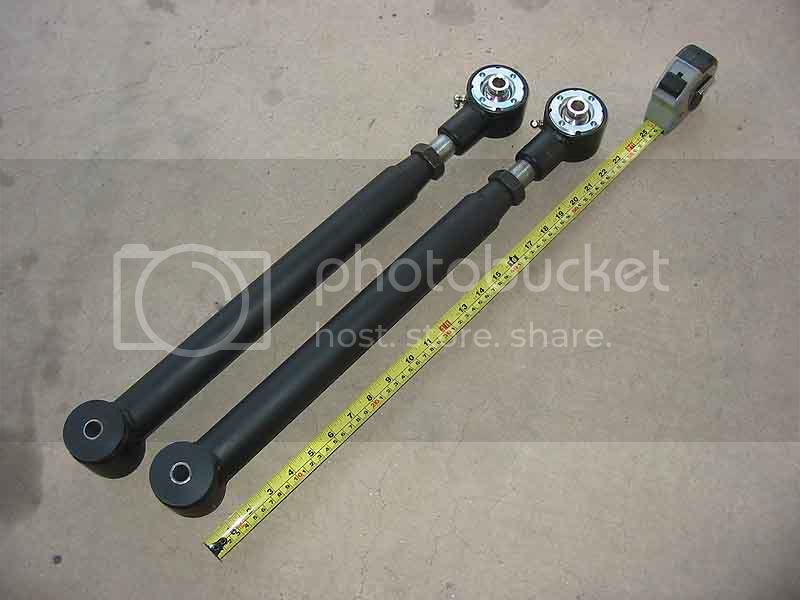

Today the tube showed up and I cut and notched 2 center sections for an FJC. I also made the brake cable bracket for the side of the link. Increased that to 1/4" from 1/16".
"If" the RE ends show up today as they are supposed to I'll have a set of these done tomorrow.
:cool: We will need pix of them!:D
This is awesome guys. R&D hard at work with minute by minute updates. This is good stuff.
THIS is what this hobby is all about.
Ok they are built.
2 sets of 4Runner links and the FJC set were on the list for today.
Now they all go off to get painted, then tomorrow assembled and will be 100% complete. Ready to install on an FJ Crusier. I'm also willing to bet the little side brackets could probably hold the truck up as well. I don't think the stock 1/16" ones would last long out on the rocks.
