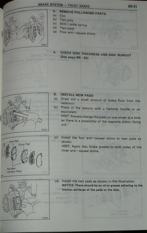

FSM Front Brakes (3 pages)

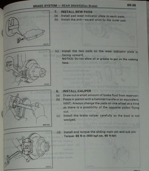

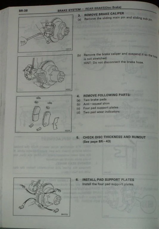

Rear Brakes (3 pages)
last page
Just follow the steps -- you should be fine. The fronts are easier than the rear simply because you don't need to unbolt the calipers for the front brakes. A 1 :banana: job...if that.
I agree on that. The fronts are alot easier to get the pads in once you have the caliper retracted. It took me a bit of time to get the rear pads to slip in, just be patient. It is easier to push in the caliper in the back though.
Here are some things I do/learned. Don't forget to remove some brake fluid from your resevoir and keep the cap off. I use a turkey baster. Do one side at a time so you don't exspell the other caliper piston. Pushing in the caliper pistons can be a bit tough (for me anyway). I alway try to use something soft ie piece of wood to avoid scoring the piston. I have used a large c-clamp, channel locks and other 'pry' like tools to push the pistons back in. The rears are easy since the caliper is removed, 1/2" wood strip and a c-clamp. The fronts are harder to access.
Here is a question, why are the rear calipers bolted with a greased pin? Are you suppose to regrease it? It doesn't mention that in the FSM when outlining rear pad replacement.
