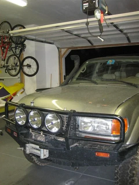

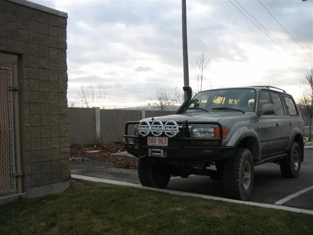

Well I received some Hella 4000s as a fine Christmas present only to find they don't fit very well into the ARB on my 80. So last night Wildyoats and I (mainly him) did a little fab work and install.

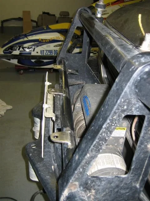

After debating about building a light bar that would bolt on to the existing tabs and the license plate bracket we decided to grind and weld some shock tabs on bar. The plan was to have the center light sit out a bit further but they ended up pretty much the same. Center light is a pencil beam. Outer lights are the eurobeam with the city light. Went out last night and drove around the sticks a very good upgrade. Of course now the 2nd battery has climbed to the top of my mod list.

Are you concerned about air flow into the radiator?

Dave, I think you are going to find when the outside temps get above 85 degrees, three lights will greatly diminish your airflow for both cooling and AC. I had to rearrange the height on the ones on Kaderabek's truck a couple times before I resolved it, with only the two lights.

You know I was a bit concerned about it. Obviously January is not the best time to judge airflow. I'm sure I'll update this thread come May or June with new info. Luckily I only drive about 2miles to work and most of my slow 4wheeling will be in the 40. Hopefully by mounting them foward I'll get enough air flow to run cool. The majority use of this truck will be on faster dirt roads in the 45 - 60range. Not pushing the motor too hard. But enough flow to keep it cool. I can always put them on the 40 and get some smaller lights later.

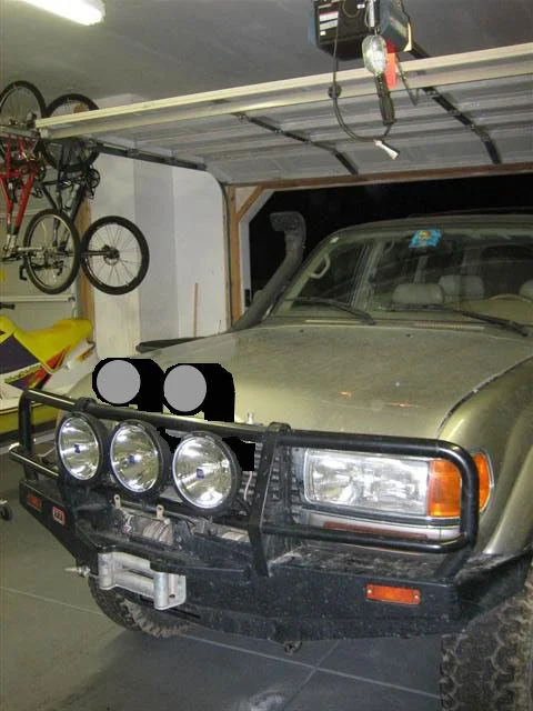

I also thought about a center-mounted pencil beam for night time driving, with two floods ("Euros") on either side, in the normal positions. Actually, what I was thinking about was using ARB's clamp-on bracket in the middle of the bar to mount the light, but either have the light folded out of the way normally, or removed entirely. That way I could swap it between trucks as well as aim it for specific uses when I actually did use it.

What exactly do you mean by a 'bit' of a problem? I've seen the lightforce and I can't imagine I'm any more restrictive than they are. I don't drive very hard at all. A noticable heat increase I'm not too concerned about. if i have to stop every 30mins to let the motor cool then I may need to think of other options.

Could you mount the outer 2 lower? Like on the fairlead mount if airflow is a problem?

When I first mounted the dual Hella 4000s, they knocked anough air off the condensor that the AC wouldn't chill, even at road speed. At the same time I noticed in heavy traffic that the temp was a little higher than normal.....not good in Texas. So I raised the lights with spacers and moved the Warn control box out of the way and it solved both.
