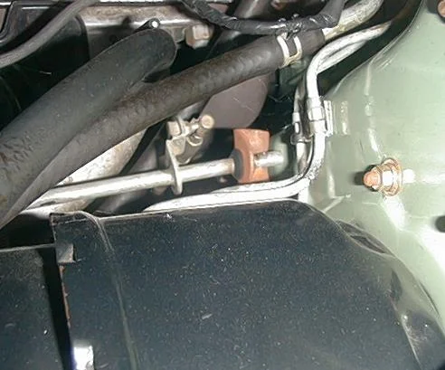

Finding parts seems to be the easiest thing. Putting them together correctly is a whole 'nuther story! I'm having trouble understanding how bracket "B" in my photo attaches to the carb. From La Duke's pics in the link it almost looks like it goes under the vac diaphragm? Anyone want to post more pics? Pretty please? I need to understand the movement of this linkage. It seems to need a pull from left to right(looking forward from the driver seat). Does the linkage twist and pull the arm hooked onto the ball dealy on the carb?
Part 'b' has a pair of holes in it, that match the base of the carb perfectly. This sits on top of the carb and the nuts that tighten down the carb, also hold this bracket on.
You can see that in the pictures...
Yes there is a rod that attaches to the carb and the pivot rod, that twists, and attaches to a bracket on the firewall. The piece that attaches to the pivot rod going to the carb does move linear from left to right and vise-versa, depending on the position of the peddal.
There is a return spring that attaches to that little extension from the carb pivot bracket, (part 'b') to the same location on the carb that the linear linkage piece from the pivot rod attaches.(or real close to it)
Hope you are not completly confused...
-Steve
The first pic is from the firewall looking toward the carb.
second pic slightly angled so you can see the linkage connection on the "B" piece.
Third is the "B" bracket from the drivers side fender. The nut in the pic is the left rear carb nut.
Hope these help a little. Let me know if you need more.
