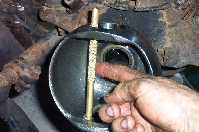

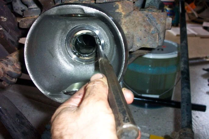

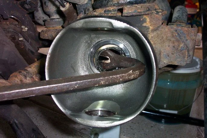

I didn't read an easy way to get the inner seal out, but this worked for me: With a drift distort the seal on one edge, carefully. Pry it out on the opposite edge easily.
That tapered drift also saved me from losing the snap ring, I stuck it in the threaded hole on the axle end so the snap ring couldn't fly across the garage.

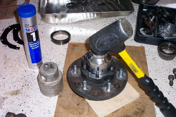

I drove in the wheel bearing races and seals with big sockets. Here's the 2-1/8" that fits the wheel nut. I greased the hub before driving in the race, then degreased with brake cleaner to get out any shavings generated. I push a lot of bushings and bearings at work, tight fits like that often generate shavings. I also chipped a little chrome off my sockets. Thats what I use my 3/4" and 1" drive sockets for the most, pressing in big stuff.

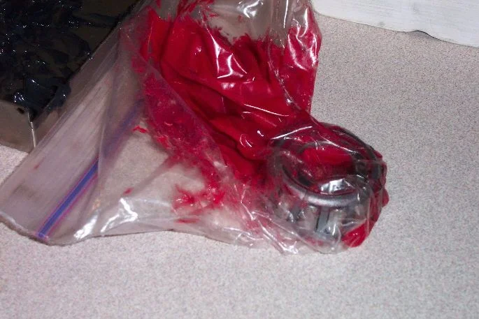

The best bearing packer ever, a ziplock sandwich bag. Freezer bags are a little stiff.

I've seen a few seal pullers, I'm not sure what the T-type puller is. From my research it sounded like everyone had trouble with that seal, so I assumed the pullers weren't working out. I got a grip on it with the prybar, but it wouldn't budge 'till I deformed the seal. Anyway, I wouldn't post solutions that involved specialty tools. I'll probably haul an arbor press home next time, not a helpful hint for most guys.
