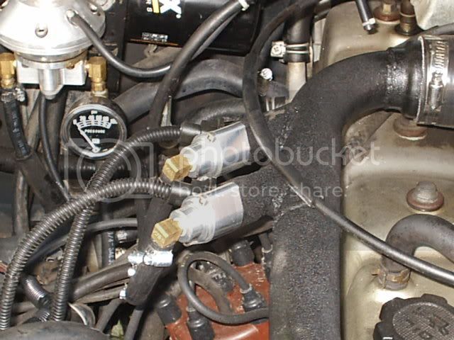

After going the FMU route, I decided to try somthing with a much wider tuning parameter. I've had a full stand-alone on a Miata before and the results were phenominal.
I was familiar with several AIC's, including the Split Second one I ended up going with. Found it on Ebay for $125 so I couldn't resist.
The injectors are two Accel 30lb (high impedance) units. The Injector bosses (mild steel base) were difficult to find because most people use aluminum ones. Finally found some out of Canada.

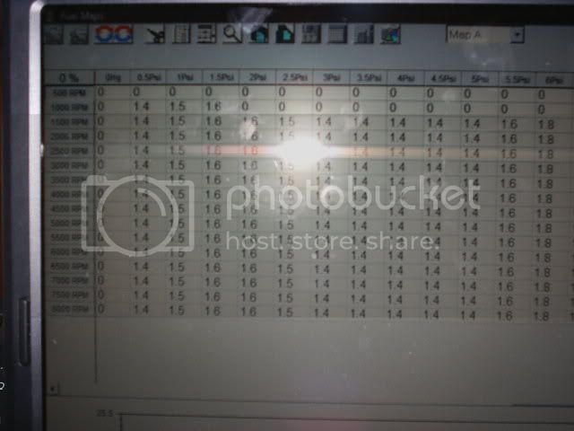

The unit itself receives a vacume/boost input, as well as one from the tach reading. The software goes .5 psi at a time, and in 500 rpm increments. Together they form a grid with cells that allow you to fully program the fuel delivery a cell at a time. It also has an auto fill option to get a base map started.

Went and did some tuning this morning (on the street) and worked a few bugs out. The a/f ratio was initially going lean at the onset of boost and then getting way too rich under full boost. This was with a linear map, (1 2 3 4 etc). I assume this was being caused by the transition from the closed loop to open loop operation of the factory ECU.
As you can see on the table below, extra fuel was needed at the onset of boost to correct the problem. Then you program a little less fuel when the open loop takes effect. It took a little fiddling with but this map provided pretty good results. Once I'm comfortable with the changes it may be time to pull even more fuel at higher boost. Still a tad too rich.
