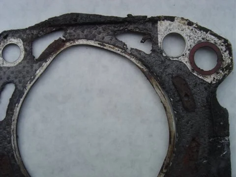

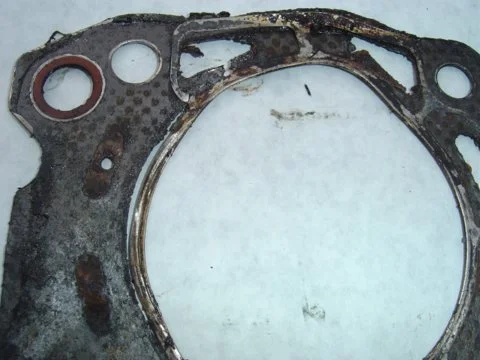

Classic fire-ring failure. Please send me that gasket.
Nator,
Had been loosing coolant for a while, and figured it was the leaking radiator. May have been, but maybe not. Got a new radiator, and at first thought it was taking a little longer to clear air out than normal, then noticed the coolant loss gradually getting worse. Got a #6 misfire code, and did the bubble test. Ordered the parts. Never overheated, never blew out the exhaust that I could tell.

By the looks of the gasket, it appears that 1/4-1/2" of the gasket was protruding from the head. Did you happen to notice this beforehand?
With that much gasket protruding, the gasket had to have been deformed and I'm surprised it lasted as it did.

wow not even near being round.
The head bolts were all tight, so I really have no clue how that happened, or maybe even how long ago.

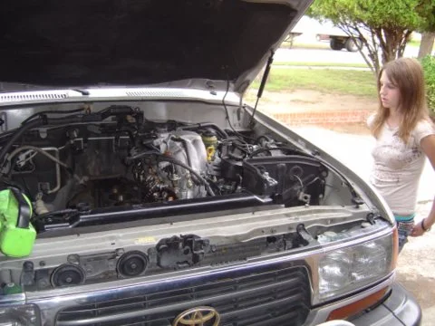

How did you manage to take the head off without taking the air intake manifold off?
I unbolted the EGR from the intake manifold, disconnected the PHH metal tube from the manifold, then unbolted the main wiring harness from the firewall, then just twisted the head clockwise out off the block so the EGR and PHH tube would come right out beneath the wiring harness. It was heavy, but I did it by myself and with the hood on.

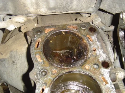

Just as an update, after I got the head and combustion chambers all cleaned, took it to the machinist and he said it was perfectly level. Said it was good to go back in without any milling.
Got the head installed back in it this afternoon, and was really worried about the amount of torque I had to put on those bolts. The 29 lbs was no big deal, it was the two 90 degree extra runs that made me think I was gonna bust something.
