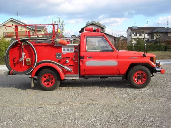

So, gents, this thread is to help those that feel buying a firetruck with low milage and converting them back to a pickup is a good idea.
I bought this truck with that very idea. a cheap truck with low km, unbolt the fire box and install a new Toyota original box and you have a cool rig.
My original guesstimate was under $10,000.
well that budget got blown out of the water quick, the pruchase price was 1080000 jpy with auction fees and contact fees. roughly $10,000 jus tto buy the damn thing.
then there was trucking to Yas, trucking to Japan 4X4 who is doing the transformation.
then the fun began, for me it was just the opening of the cheque book and okaying a continuing lits of parts.
