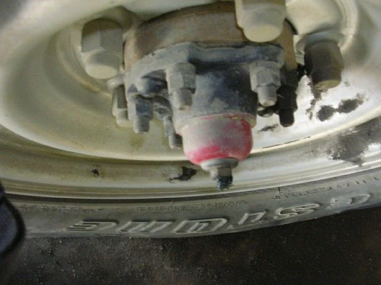

Picture from my underground unit, My DD nipples are shorter.
They can be ordered or if you are capable take your birf's to a machine shop and drill out the +-8mm hole on your dust cap end.

The pic of the extended grease nipple is from an underground HZ79L, made this way for ease of daily greasing.
My daily driver FZJ80 has the countersunk nipple, this more likely the best senario for people who use their units for more than hauling groceries as the dust cap will protect the nipple from rocks.
You can always purchase the longer nipple if desired.
