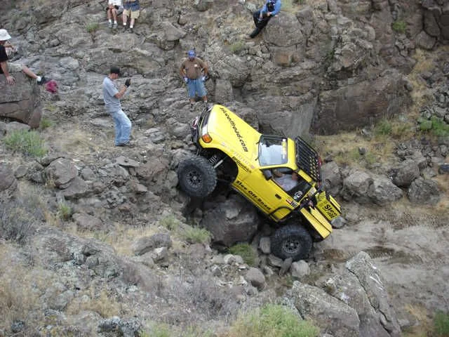

I have a M8000 on the ShortBus (weight about 5400lbs) and have dragged it out of insane places with an without broken parts. Have never stalled it out. Have used double line pull sometimes, but never had it stall. None of this was mud or snow, just rocks.
Places like this.
