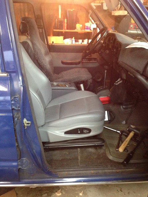

I have BMW m3 seats in mine and love them. I'd drive 10 hrs in them any day. worlds better than stock. the only issue people have with them is the side bolster is a pain to get over but I'm tall enough it's not a problem for me. sliders as a step would also improve the problem. they have aftermarket seat heaters and are powered. I don't know how they compare to other seats mentioned above but my back doesn't hurt after a long drive anymore. only thing that bugs me right now is they have a weird squeak when i hit a bump. I still have to sort that out

You may have already found this post in your search...but I put BMW e30 series "comfort" seats into my 85 FJ60 a few years ago. Had to make simple brackets. They are very comfortable, but sit high in older 60s. In later 60s and 62s I don't think the height is as much of an issue.
