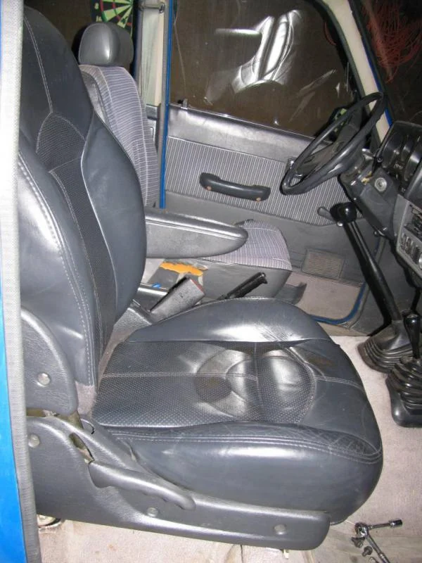

If you didn't notice they are not black! This is a good thing as I was not key on them being black. I would call them a blue grey and in my opinion perfect!

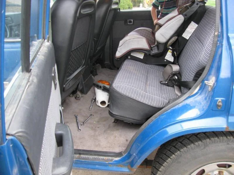

I installed the passenger first as this is my daily driver and I was not sure how long it would take. This was the trial and mockup so I can document everything on the driver side so people can see how easy this was.

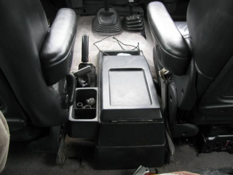

They looks great. Is the color close to the grey interior? Looks like a good fit when looking at your center console!

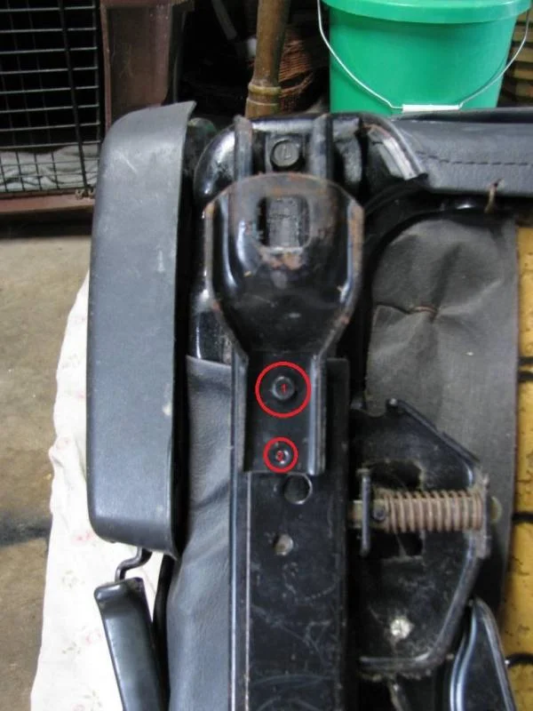

Here is the bottom of the original seat.

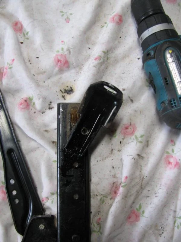

To start the 4 metal press studs (Sure this is not there actual name) need to be drilled out.
Drilled out. I used a chisel to cut the excess off.

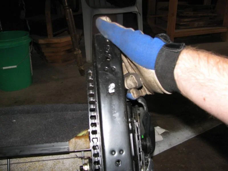

If you were to take the sliders off the pt cruiser seats I counted at least 4 on one side. Also of note these seemed like very hard steel to me it would be advisable to use some oil when drilling this unless you want to buy a new bit.

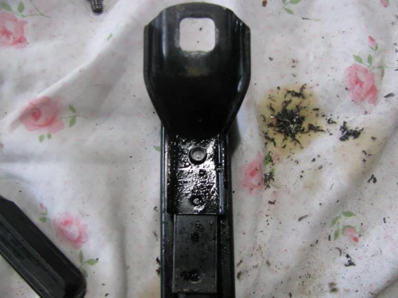

The small bottom one is some kind of weld. After drilling the stud out I was able to smack this with a hammer to twist it and break the weld.
Needed to drill out the brackets to accept bolts.

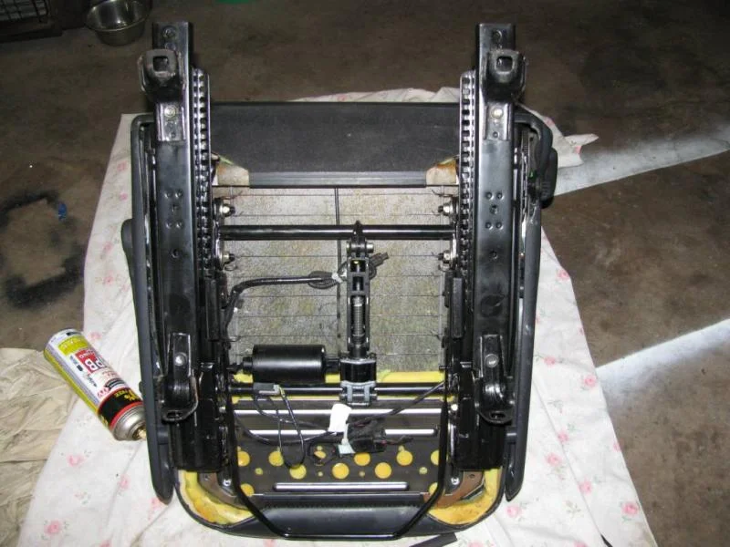

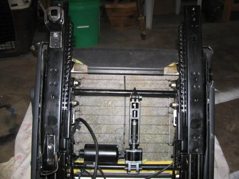

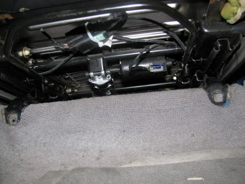

Here is the new seat bottom. (Not heated but I have heard they are available)
Hard to read but the yellow connector is for the air bag. I just cut the wires and put some heat shrink on it. Bottom black connector is for the height adjustment. I had planned to wire this up at a later date for the :princess: but I think it will not be needed but I might still wire this up.

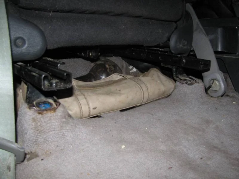

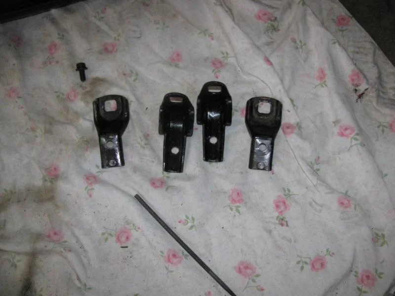

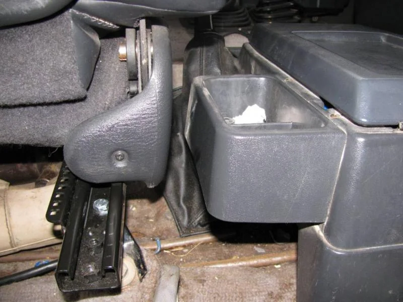

One side installed one side not. the front mount is using a captured nut. The back mount is a bolt through a slot that existed in the slider before.
(Front mount is at the bottom of the picture)
I fed the bolt in from the inside of the slide just to be easier to install the nut.
All four brackets installed.

I did take measurements but I did not document them all but I figured that I would have to splay the brackets out just slightly to meet up with the mounting locations inside the truck.

The difference in width if I recall correctly is that the original seats have the sliders at 15 1/8" the PT cruiser seats were more like 14 1/4" so I am not sure if you could use the same mounting locations on the PT cruiser seat but there is room to move the sliders.
View from the back the front door is closed. Fits like a glove!

Here is the center console from the back. The passenger arm rest needs to be up for the console to open all the way.

For you Biche! Plastic on the left is part of the PT cruiser seats and matched the leather.
I think if the plastic on the console was not faded it would be so close no one would tell. As it is now I am super pleased with how close it matches.

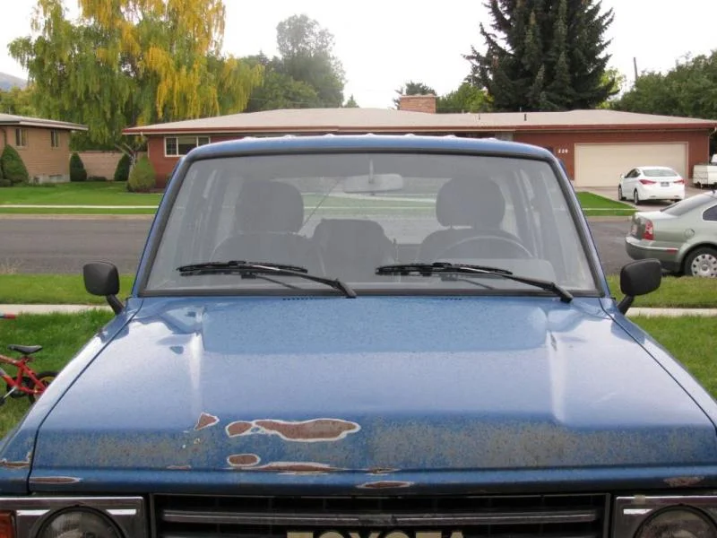

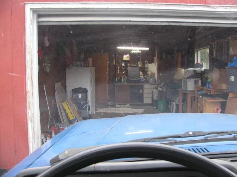

And for kicks here is the view out the front window from my eye line.
