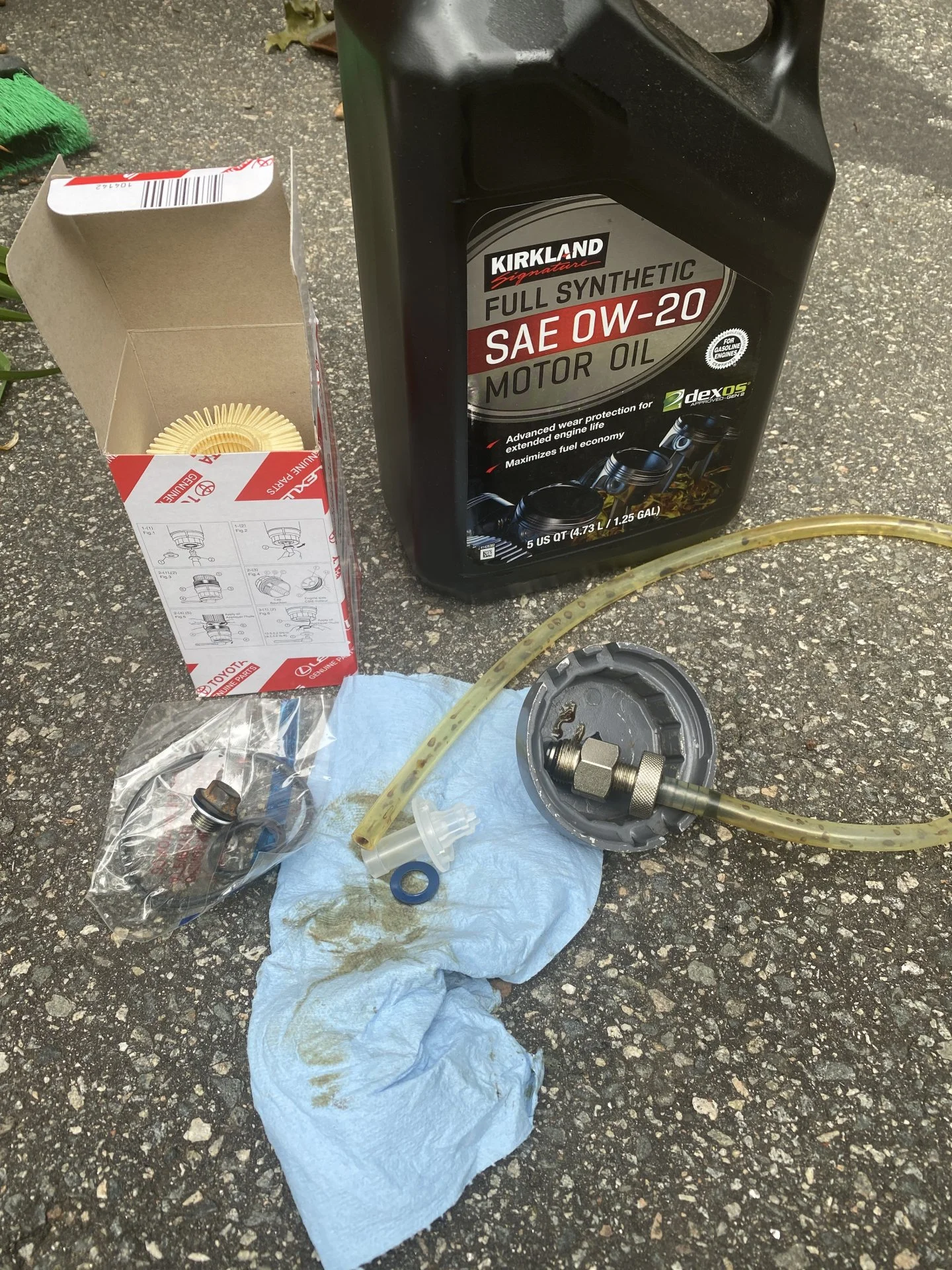

This 2015 has got to be the worst oil filter location of ANY vehicle I have ver owned!!!!
Seriously Lexus/Toy, you JPNs have really figured out a way to work the system. And I thought VW and Mercedes was bad. HA!
No way I’m doing this oil change, screw this sheee it! I did the 470 and that’s bad enough. But this!!!
If I can get my wife out of this rig, I’m done! Ha!
First five LCs, no problem. The sixth, eeh. But this one, this 2015 570, holy crap!!!
what if you’re down and NEED to do a change. It’s not like you can spin off an old clogged filter, drop the plug and let her rip. Repeat, refill.
Here, you need an orchestra with wet suits and a hazmat clean up crew close by, with a Snap On roller box full of gadgets! Oh and… make sure you BYOB!!!
…a plastic jug!!! This is laughable!!

Glad you survived.

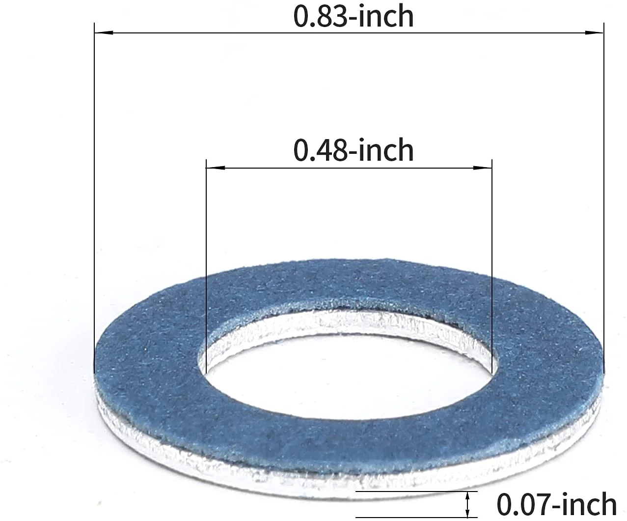

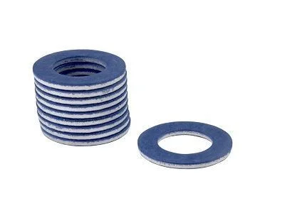

One note, you appear to have used an incorrect crush washer on your oil drain plug. The correct part is Toyota Part# 90430-12031 and looks like this:
HTH

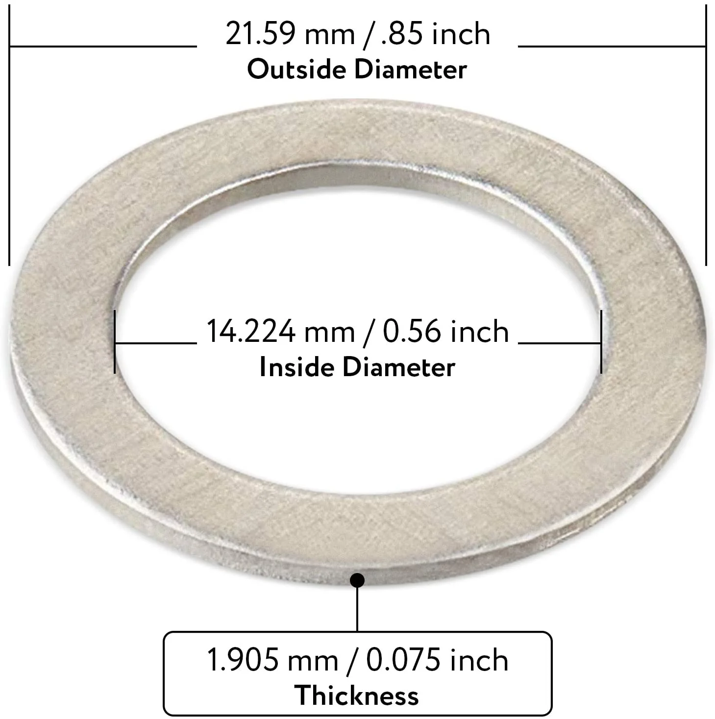

P.S. I noticed the crush washer you used was not sitting perfectly concentric with the drain plug flange which means the inner diameter of the washer you used is too big. My guess is the washer you used is based on a size required for Honda engines and has the following dimensions:
Whereas the factory part has these dimensions:

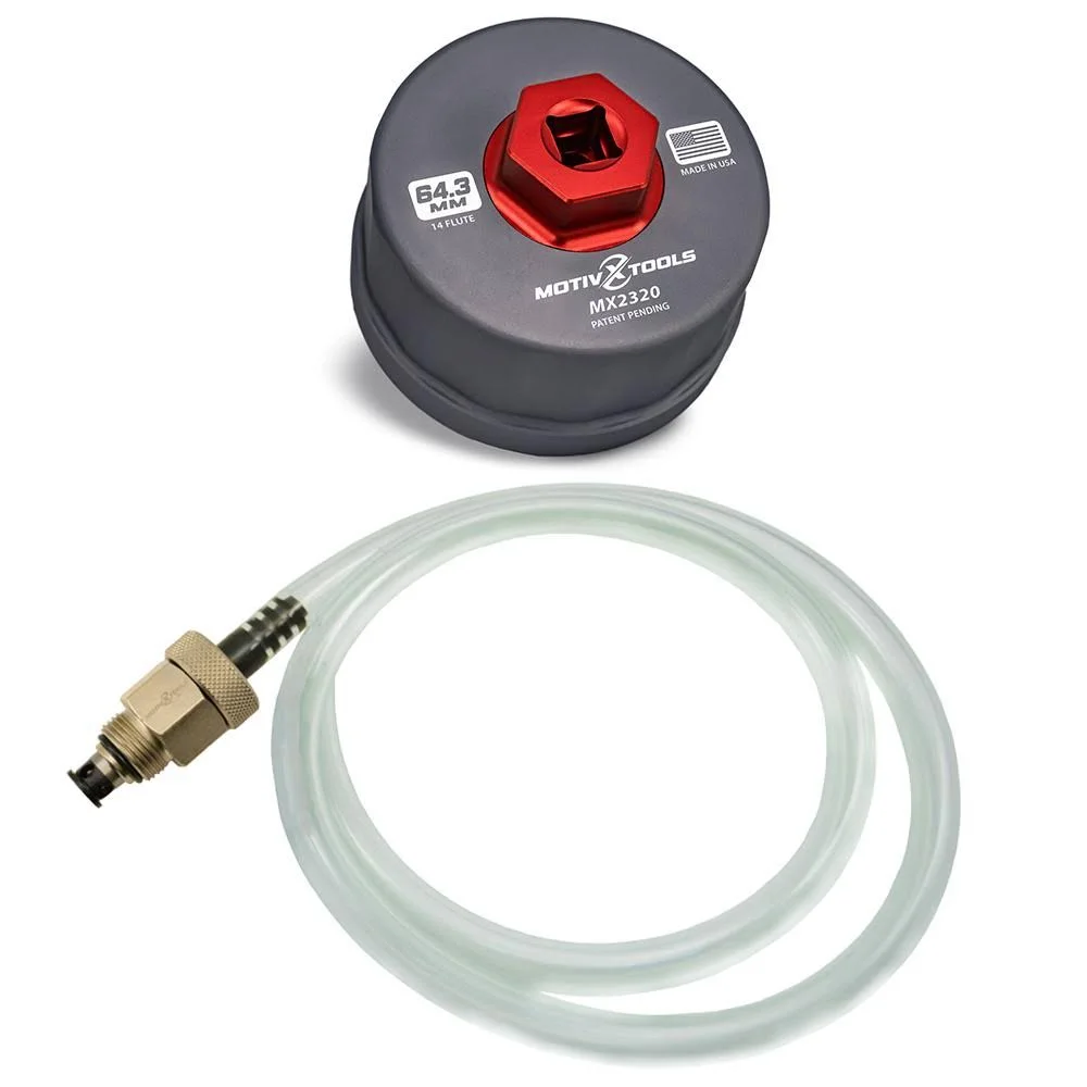

While my FJ 62 is "easier" to change than a stock 200, the sideways mounted filter always leaves a mess. My old Tacoma with the remote filter right under the hood was the easiest. The 200 generally is not a difficult vehicle to change the oil.
That said, with the addition of a Fumoto valve, BJowett filter canister and bud skids, a 200 oil change it is now a breeze and a very clean operation.
