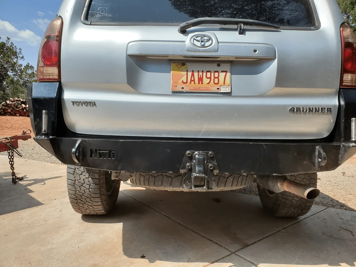

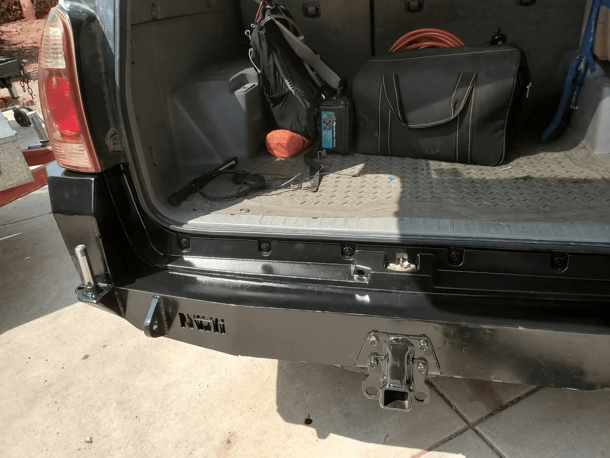

Come to the breakfast this sat and check out the bumpers I put together by ordering pre-cut pieces from NWTI. Honestly, I think as your first project, this is the way you should go. Why? For one thing, when you have a pre-designed and pre-cut kit arrive at your shop on a pallet, it's EXACTLY like playing Legos for adults. :rofl: . I kid you not, it's fun to puzzle it together. Once you actually start on this project, you won't be stopping because it's really fun to tack everything together and watch it slowly come together. Just drink some beer, and slowly build it. Slow is good, otherwise, you'll warp the s*** out things. You can tack the whole thing together in one weekend then spend as long as you want completing your weld. So, you'll be driving around with an unfinished bumper but who cares.
I've built bumpers for all my rigs and this was by far, the most fun I had. When you're not designing, cutting and noodling from scratch, the project moves faster and your desire to complete it stays at a high level, IMHO. I really hated cutting and cleaning up steel before tacking. While CAD'ing a bumper is fun, it also takes a long time and to be honest, there ain't too many ways to build a freaking bumper ;)
Coastal Offroad and 4x4lab also provide bumper DIY kits for our rigs so check them out too. Mine is from NWTI out of WA state. My bumpers have my personal tweaks but having a good foundation to start with is really sweet. By doing a DIY kit, you'll be proud of your work and learn fabrication/welding at the same time. Your welding skills will improve exponentially on projects like these. Cost will be 1/3 less than a finished unit, typically.

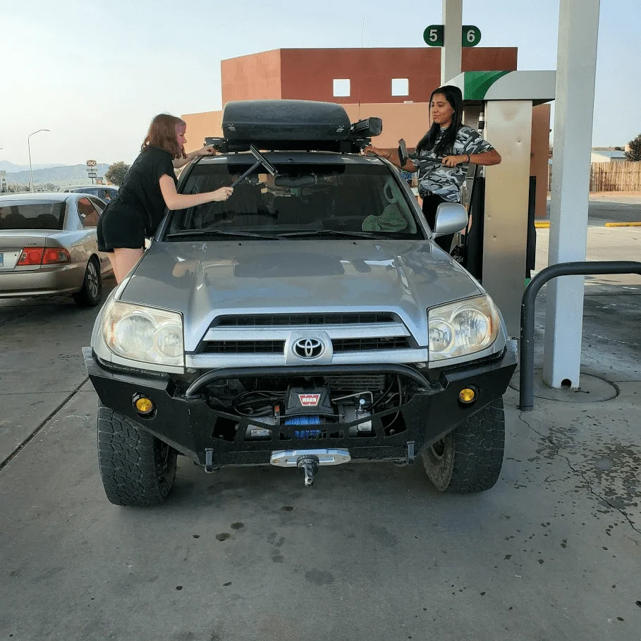

My bumper needs were due to the huge amount of plastic bumpers that were simply falling apart. 4th gens have mondo amount of plastic as bumpers. The plastic clips were broken and the two bumpers were barely hanging on while rattling over bumps. I thought long and hard about building a hidden winch up front behind the stock bumper to keep it light but that plastic POS needed to go.
The rear bumper motivation came from needing to haul four bikes and fuel cans. I can spend $$$$ on a quality hitch mounted rack that accommodate four bikes while sticking out four feet behind the 4runner or spend the same amount of money and build a quality bumper with swing outs. :meh: One is easy and the other one is fun, for me at least!

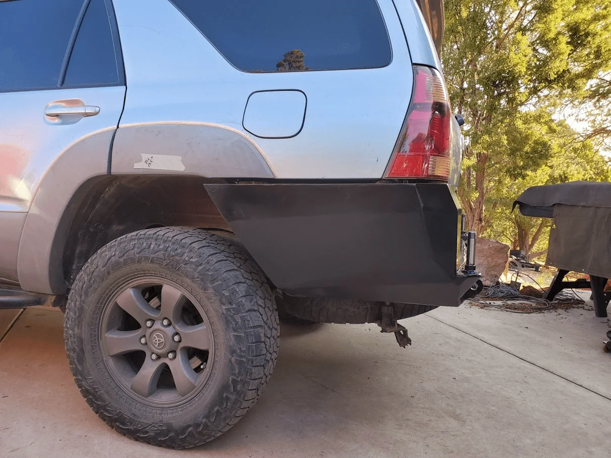

Adding my 5 cents to the bumper kit discussion.
I have the Coastal Offroad bumpers. They work fine, but honestly I'm not the biggest fan of the fitup, I'm a decent welder, and TIGed a good bit of it, and its still a bit more rough around the edges than I would like. When they shipped, there were a few pieces that were missing, and it really wasn't worth all the hassle getting the pieces to line up as good as it could. You'll still spend a lot of time, beveling, fitting, grinding, and then still get something thats just ok in the end. That said, it does mean I'm much more willing to wheel it hard, because I know it can stand up to the abuse and I don't mind patching it up, especially when compared to a 1k+ bumper.
I think next time around, I'll either get a tube bender and make my own, or pony up for some of the really nice ones.
