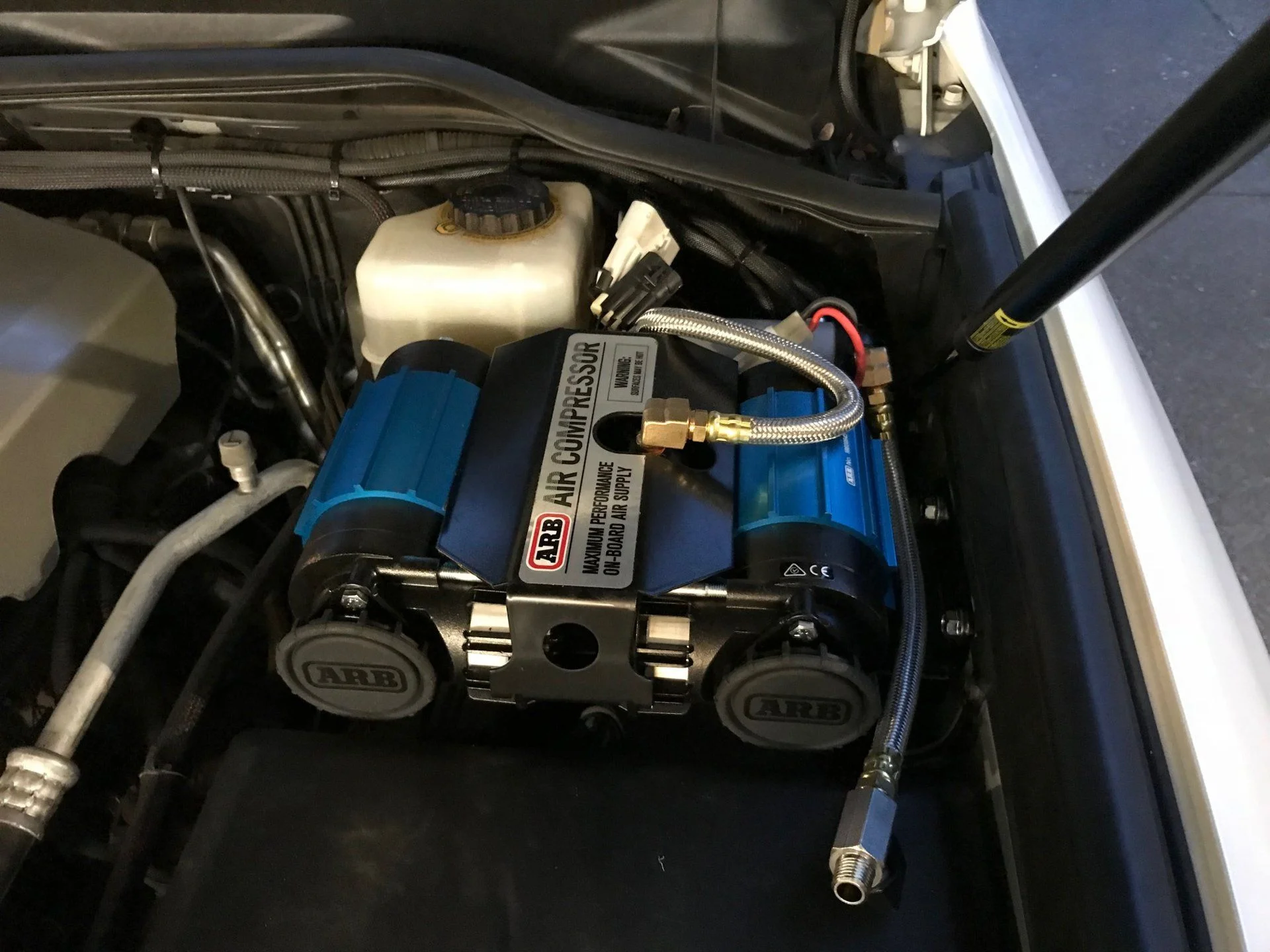

2) Yes, 1/4" NPT. The Slee instructions show the ARB hose with the elbows offset. My hose came with both elbows pointing the same direction. In talking with Slee, they say you can rotate the ARB hose fitting, but mine appears to be crimped on at the factory. Regardless, my solution was to run a compressor drain hose (Husky brand). It is more flexible than the ARB and the male elbow nests perfectly at the top:
