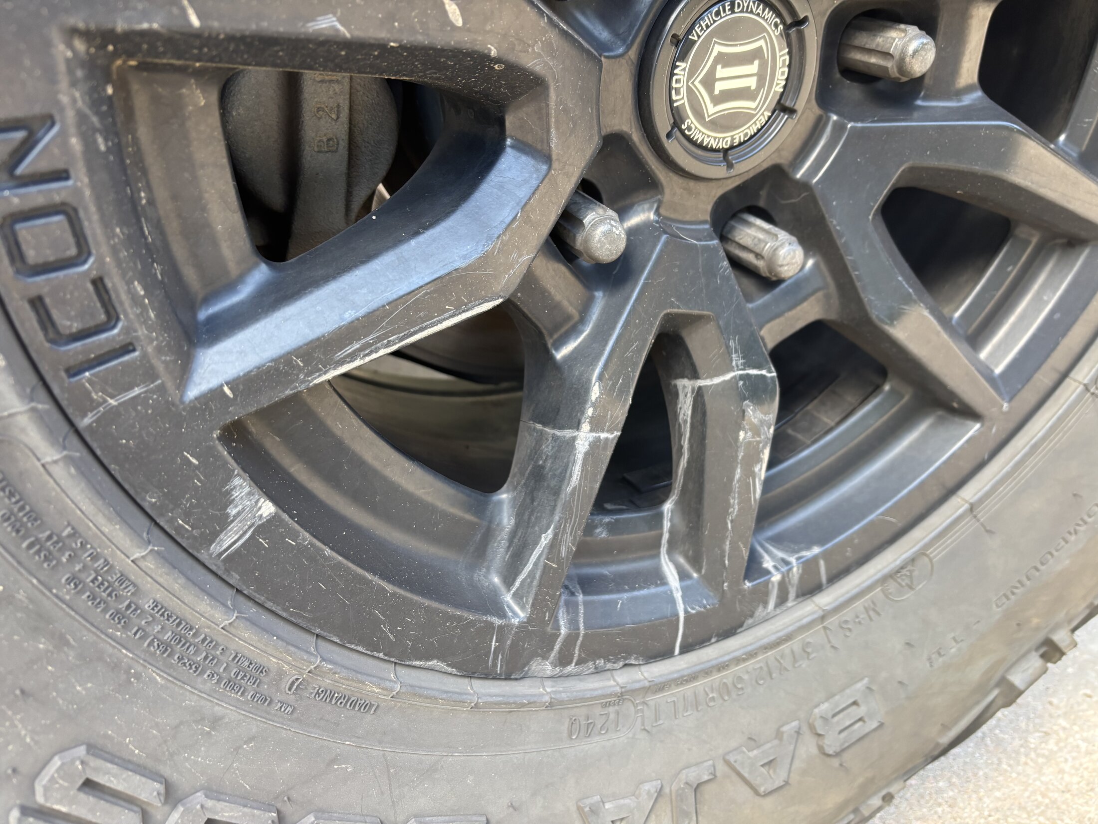

Yup, love the vector 5s on a 200 series. Probably my favorite wheel aesthetics wise. At this point I have seen 6-7 failures. I have had terrible exposure to anything Icon. I was rooting for their alloys.
This is the second one I cracked. The other one was just one spoke and I have been using it as a spare for the time being. I broke two spokes this time.
I’ll use this thread as a PSA and a selfish post for suggestions on what to grab next.

Rear shock failures, wheel failures.. Icon is seriously dropping the ball on the 200-series.
Pretty scary.. the failures on these was my deciding factor to go BBS... I originally really wanted them.. Glad you caught it OP!

I run the rebound pros so this hits close to home.
How heavy are you? The vector is rated for 2750lbs each so you could be near the limits on those. I chose the rebound pros for their higher limit of 3200lbs.

I’m deliberately super light. Drawers in the rear and sliders , That’s it for added spring weight. A ton of suspension work, 4.88s, locked and 37s. Could have been the 37s for sure but I broke the other one on 35s so…
