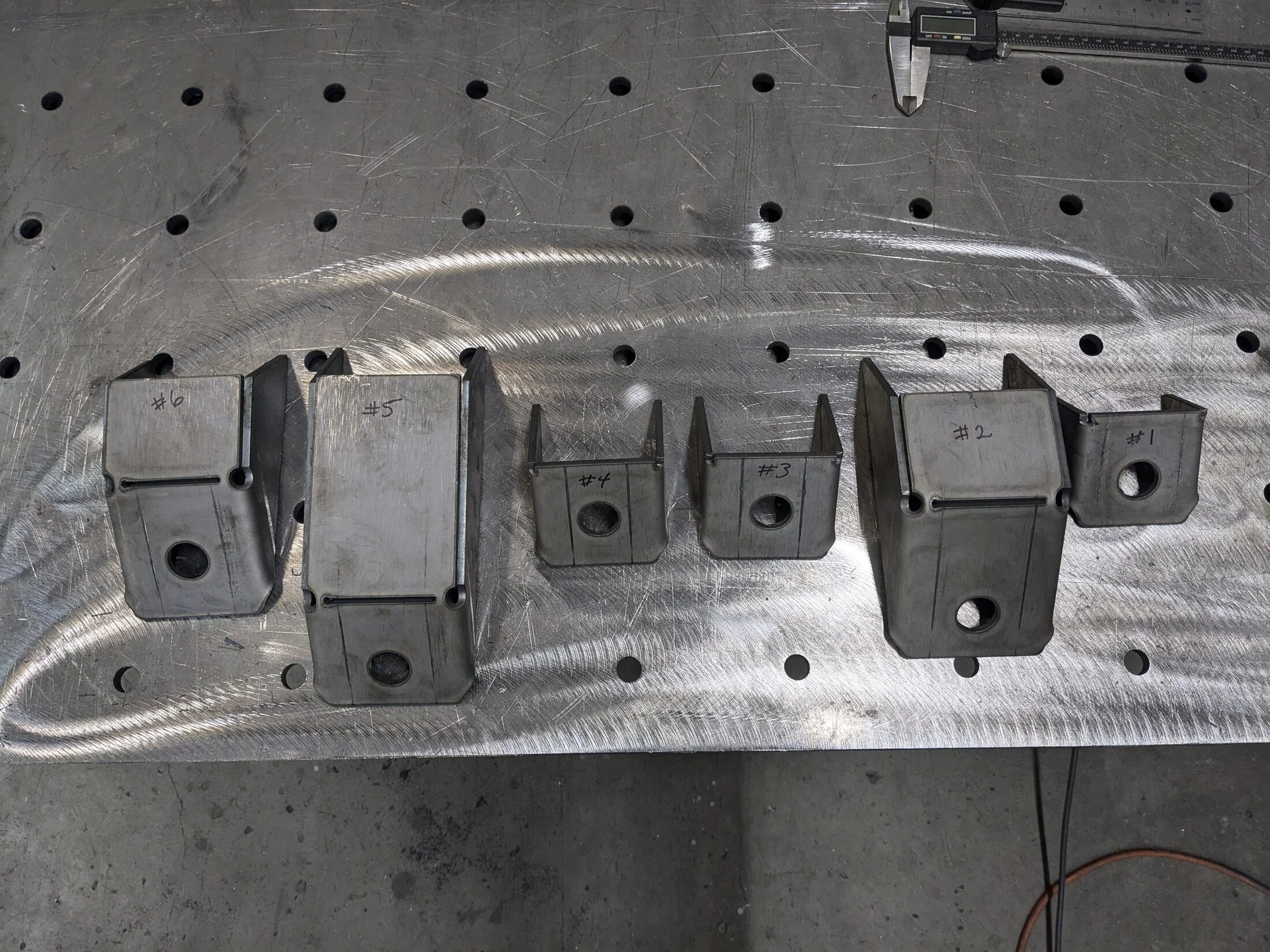

Front axle link brackets are ready to go. Link ends for OEM bonded bushes are ready to go.

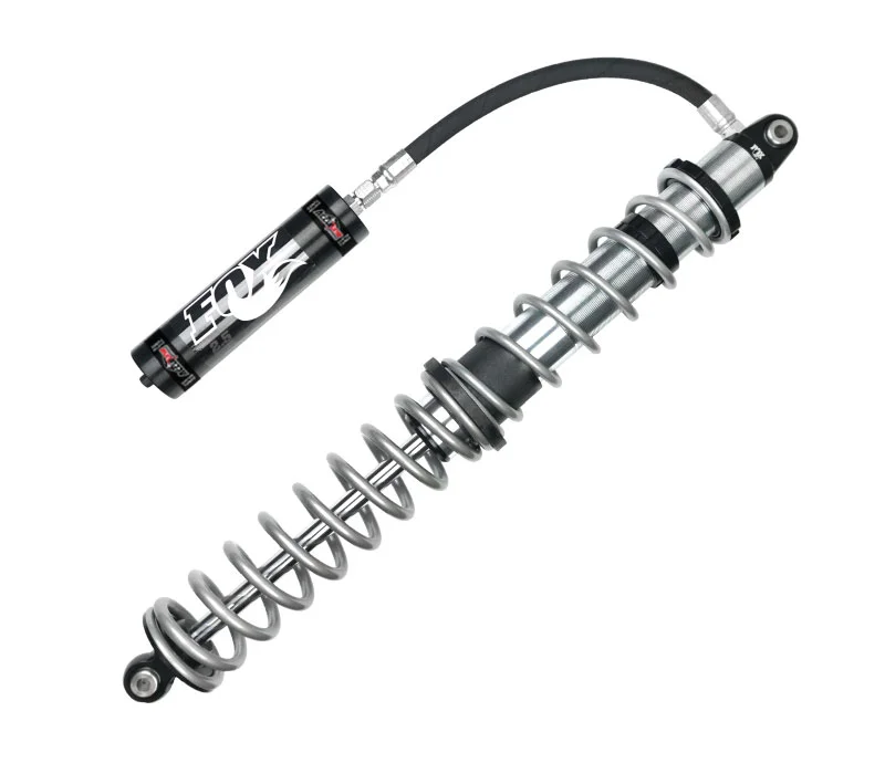

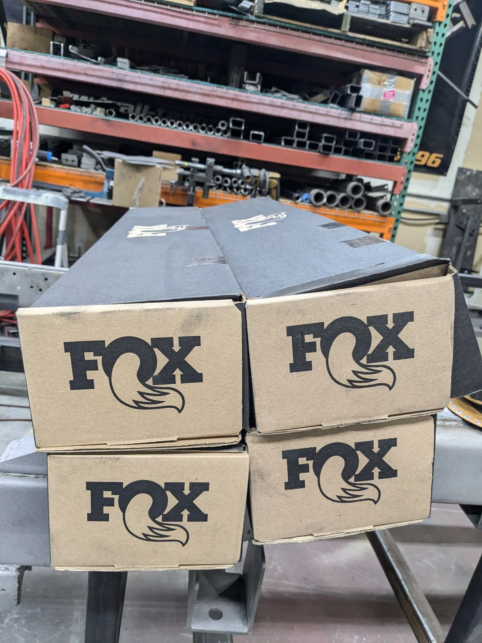

Deciding on a coilover MFG now for the test chassis. Probably go with 2.5" Fox or Dobinsons with a 10" stroke and a dual rate set up. Looking like a 250/175# start off.

Going with the Fox Performance series for the R&D chassis. Have 5 other MFGs within .230" of measure between them. Good option for all other end users.
I'm sure there are more, but these are the ones I'd personally install/use.
I'll be running a 12" primary and a 10" tender coil with a 2" preload. 3" ID - 4.10" OD. Preliminary rates 250/180 or 275/200 need to check some more calcs and actual weights.

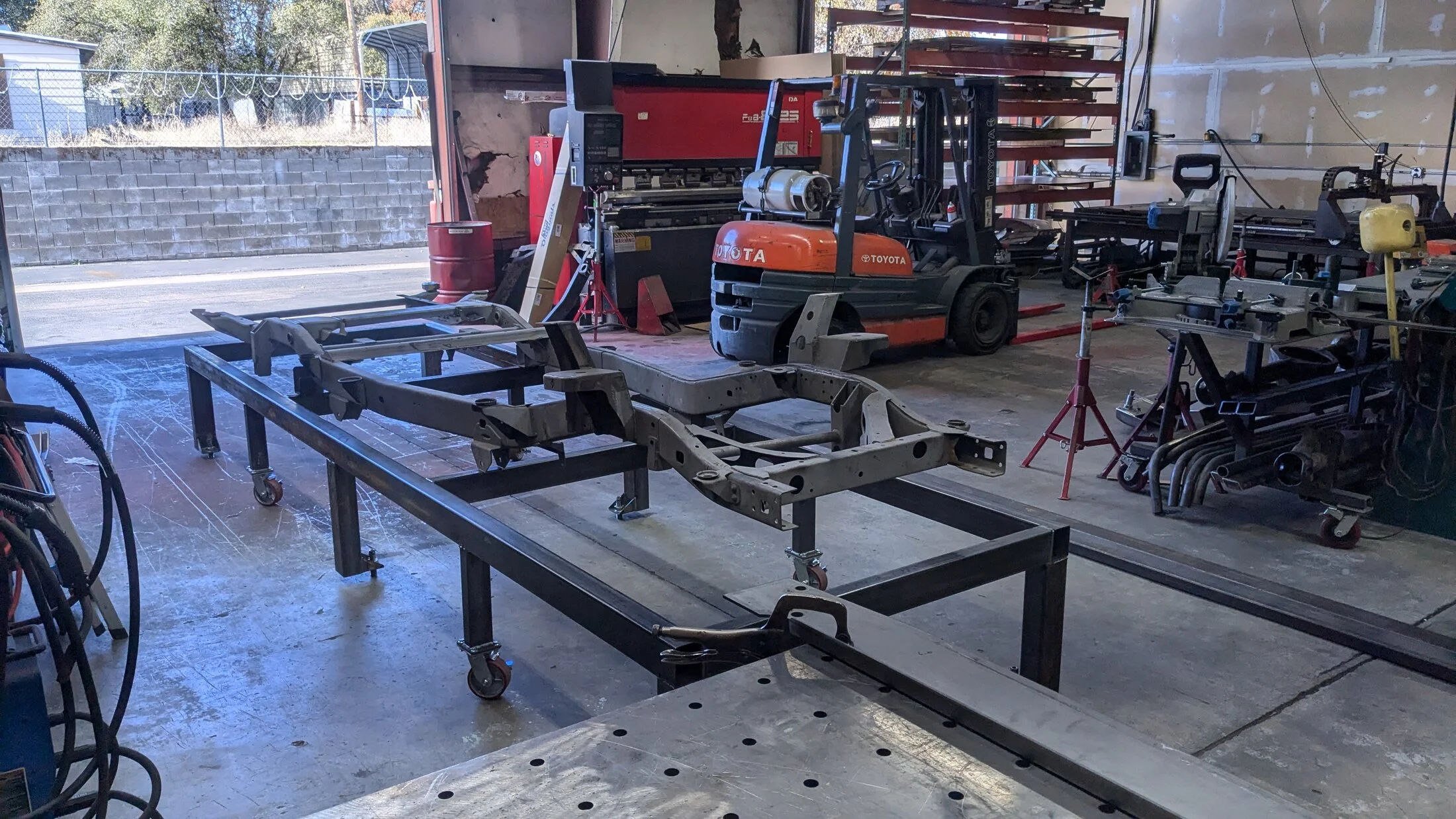

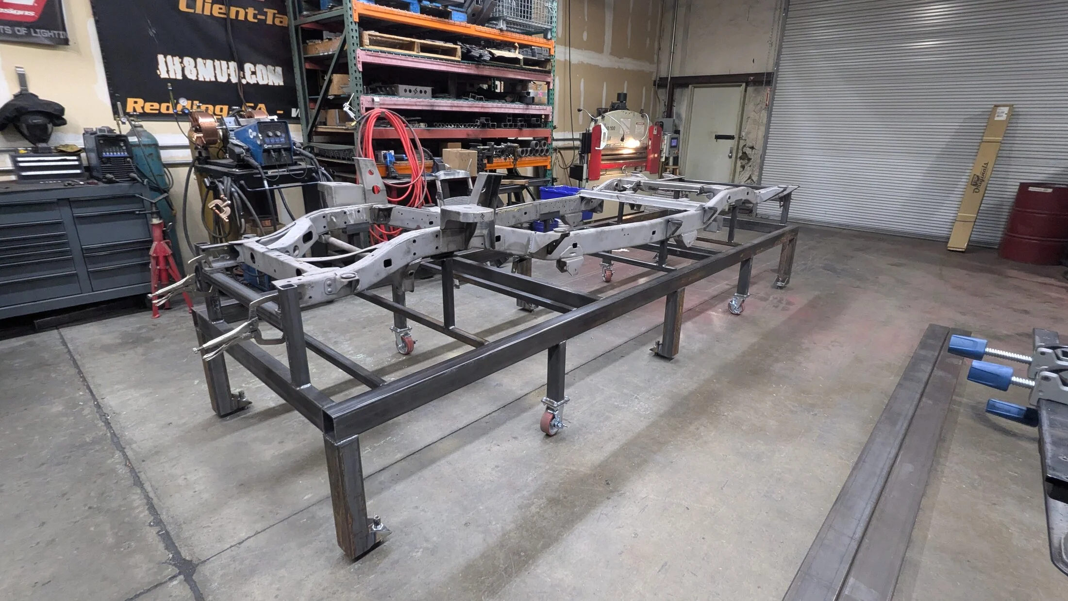

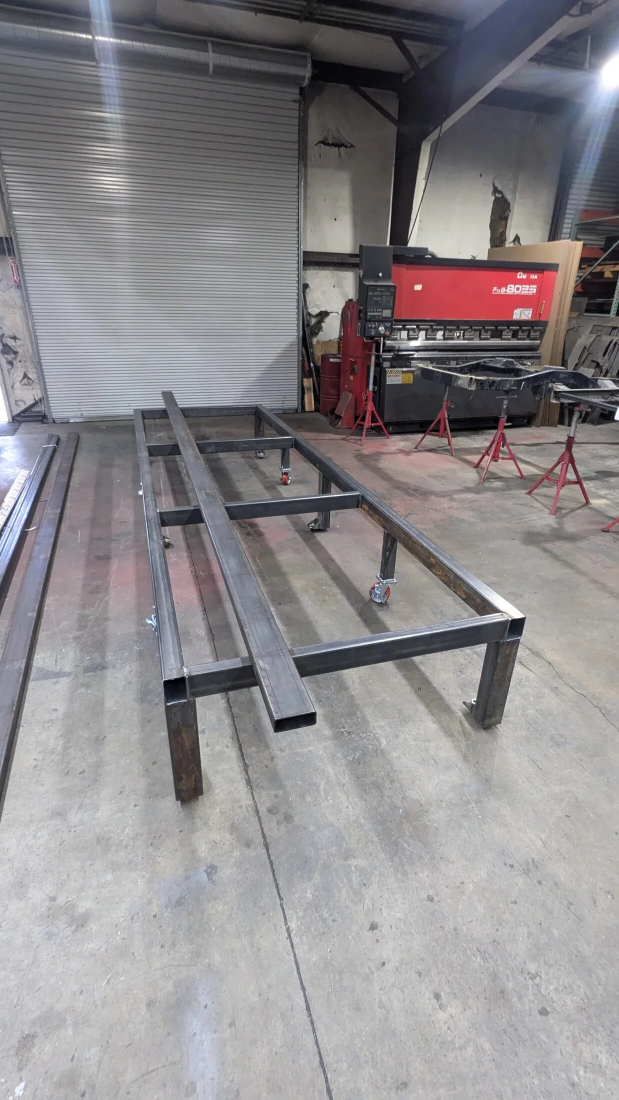

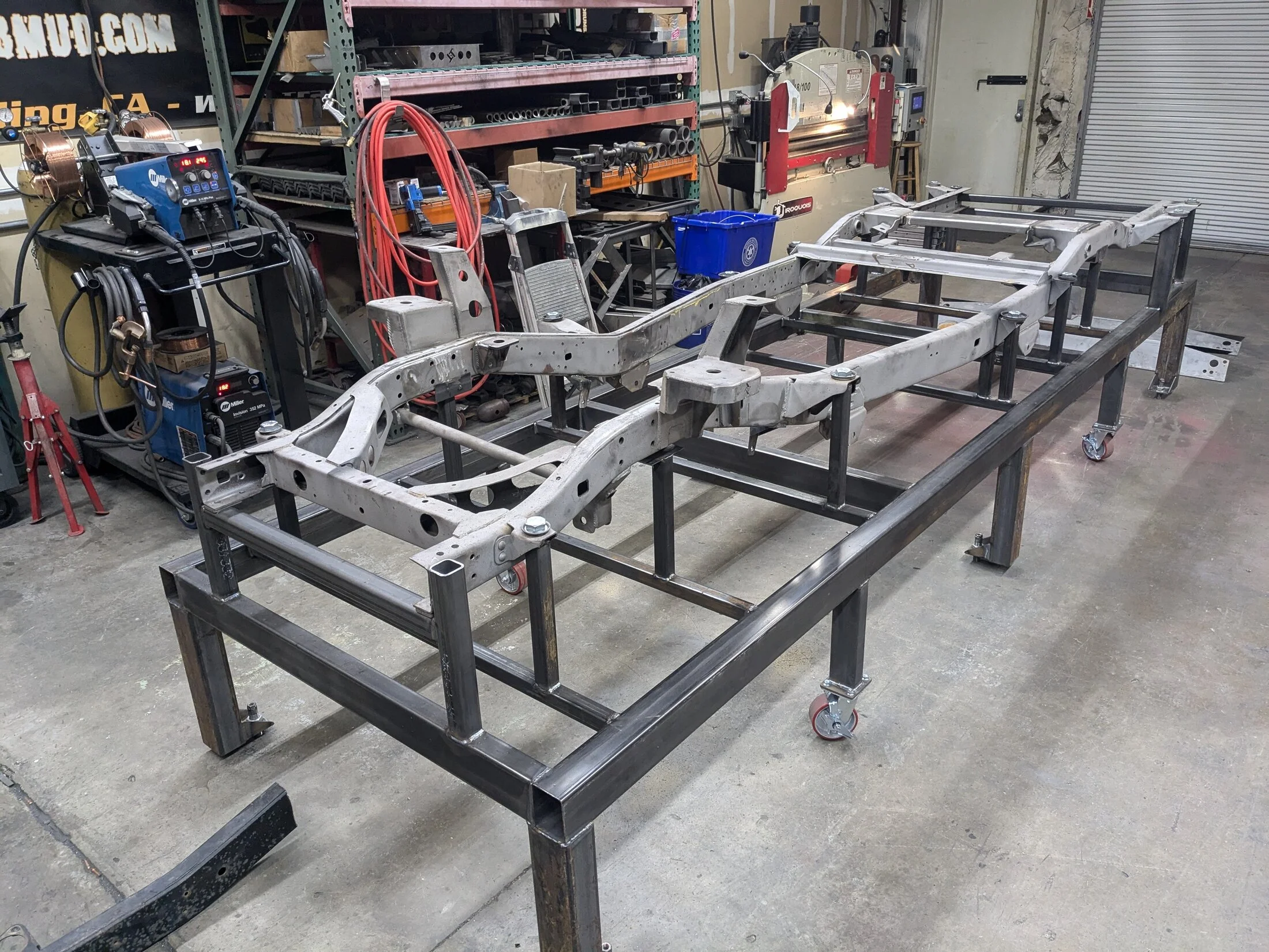

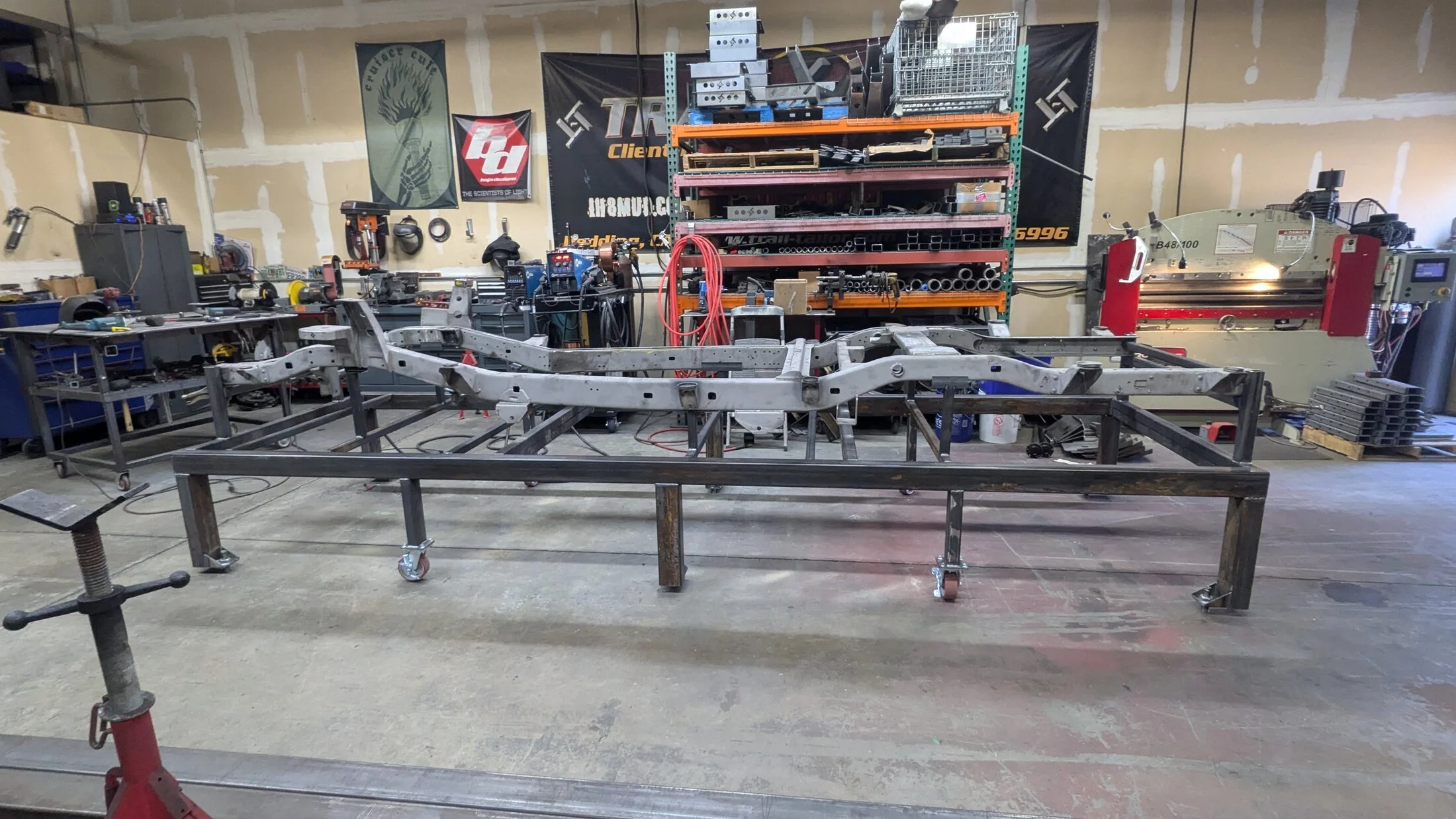

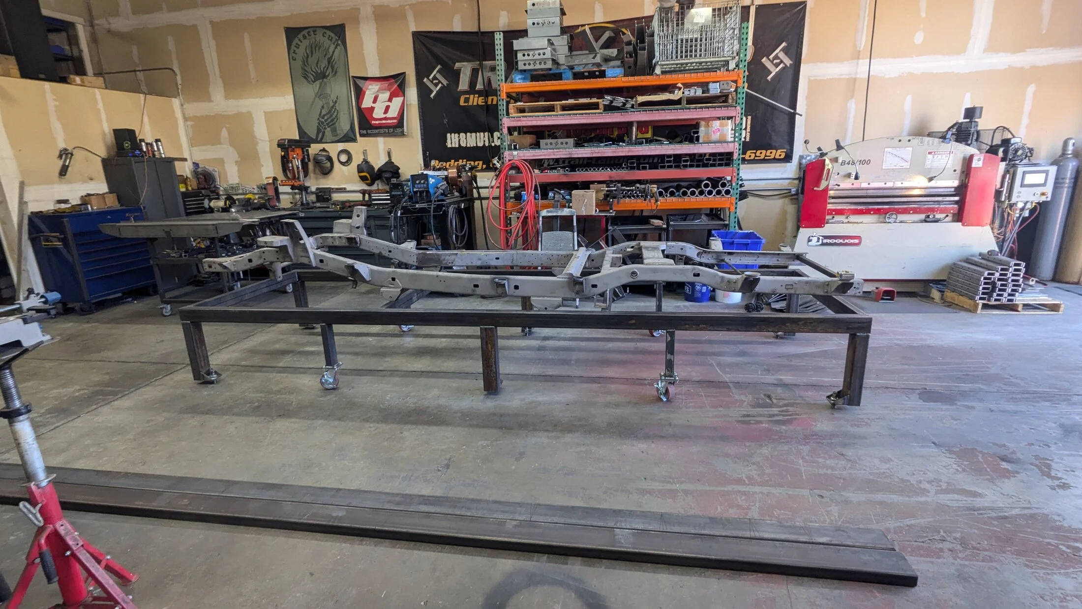

Chassis jig is set. Body mounts and frame supports are all in.
CURRENT JIG MEASURES -- within .053" on all body mounts and .065 of a degree on rails. That should be good for any frame. I know the OEM frames are more than this. Checked against three others in the shop. I cut the frame pictured and made adjustments according to the OEM dimensioned drawings to set this jig up.
I'll get gussets welded in and positioned cooled and recheck everything Monday.

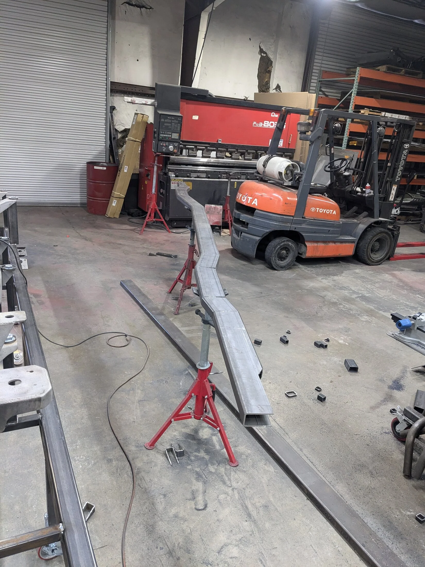

Notching and bending the test frame rails next week.
